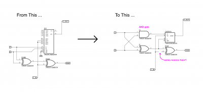

Here is a different take on the FET Switch Adder. This one relies on a 2:1 74AUC2G53 FET Switch. (Thanks to Dr Jefyll for suggesting this part). This configuration requires an additional gate, but capacitance on the carry-chain is lower — AUC parts have lower intrinsic capacitance to begin with, and the carry chain now connects to one pin on the switch rather than two, as follows:
Here is the test circuit:
I took the opportunity to extend the carry chain to better simulate a 16-bit incrementer. This circuit also includes four AND gates in series to simulate carry lookahead feeding the final four bits of the adder. Here is they layout of the test board:
74AUC08 ICs are only available in a VQFN package, so I thought I would experiment with that in passing. Honestly, the footprint (bottom center on the board) looks about the same size as the other VSSOP packages, and the big center pad makes routing harder. Not sure I get the advantages. Anyway, I have added thermal vias to the centre pad as per the datasheet. Not sure these are fully necessary, but I understand they make hand-soldering easier. My instinct for soldering these is to use a hot air gun and reflow pre-tinned pads, rather than fuzzing with solder paste. If anyone has had any experience with QFN please chime in. All suggestions welcome.

Nice going so far.
It's a pity, that 74AUP1G386 (3 input XOR) and 74AUP1G99 (multifunction gate with output enable) are too slow to be useful,
and it looks like no 74AUC version of these chips is in production... yet.
74AUP1G58 is too slow, and there seems to be no 74AUC1G58 in production.
74AUP1G58 can be configurated to work as 2 input AND, 2 input OR, 2 input XOR.
Using only one type of chip for implementing all of the AND\OR\XOR gates would have simplified logistics for ordering parts.
//Since we are at it: in theory, 74AUC1G08 could be substituted by 74AUC2G53, but this won't do good to the capacitances in the carry chain.
There seems to be no "74F298\74F398 equivalent" in 74AUC (2:1 multiplexer plus latch in one chip).
This could have have made it possible to go for a more compact ALU output section.
I'm afraid that inverting B in front of the ALU input latches for having A-B might have a habit of increasing complexity of the control circuitry.
Also, when inverting the data from main memory with XOR gates on their way into the ALU input latches,
I think at 100MHz+ we need to be a little bit more paranoid about the capacitances piling up at the CPU external bus system.

Great comments Dieter, and hello Joan. Nice to see you posting here. Some responses below:
Yes, but not unreasonably so. The control logic needs to know whether we are fetching an operand on behalf of an SBC or CMP or otherwise. It can then enable the inverter as needed for the memory read. So this comes down to, once again, that pesky FetchOperand cycle. You'll recall that it gave us some trouble in the C74-6502 (for single-byte opcodes for example), and it promises to do so again here. More on that later!

The boards are here! I’m excited to see how the new FET Adder performs. With some luck, I’ll get a chance to test things this weekend.

2) To minimize skew, we ideally want nothing in the path between the clock and a flip-flop’s CLK input, as in this alternative based on a 2:1 FET Mux at the data inputs of a register:
This method accomodates both active-high and active-low WE signals equally well. The FET switch will add 5Ω of series resistance at the data inputs of the flip-flop, and with it some minimal additional delay that we can safely ignore here. The switch-time of the mux becomes the setup time for the WE signal. One consideration is that clocking all flip-flops every cycle will consume some additional power, but the main drawback is the number of additional ICs required implement the approach. We effectively need one ‘3257 2:1 mux for every 4-bits of registered data in the CPU. That's a lot of hardware overhead.
3) Another approach is to use active-high WE signals with AND gates at the CLK inputs of flip-flops. This gating mechanism is sensitive to glitches if the WE signal is allowed to fluctuate while the clock is high. This is very likely to happen with WE signals that are generated by combinatorial logic. In that case, we can use a transparent latch to hold WE steady during the first half of the cycle, like this:
In this case, the datasheet for 74AUC08 lacks any skew information so it’s hard to know what kinds of delay we might be dealing with. We can use the ZDB to synch up the signals with an external clock, but that of course won’t help skew.
4) We can also use OR gates with active-low WE signals, as follows:
In this case, fluctuations in /WE during the clock-high phase are not harmful. The catch is that once /WE is brought low, the signal must rise again before the following mid-cycle, or a phantom clock-edge will be generated at the flip-flop input when it does rise. The approach is therefore not feasible in situations where WE signals are only available late in the cycle (which is very much the case in this design).
5) Finally, we can use FET switches to gate clock signals, like this:
With this approach, brief fluctuations on the WE signal should not cause a problem. However, longer pulses, or indeed a full switching of the WE signal before the mid-cycle is problematic. Like with AND-gated clock above, a transparent latch could be used to hold WE steady during the first half of the cycle. The advantage here is that the tpd of FET switches is much shorter, and so any deviation from the mean is likely to also be minimal.
I don't doubt there are other approaches to these issues, so please feel free to suggest any alternatives. As always, all input is very much welcome. We'll have to see how all this works out in the final analysis. For now it's safe to say that clock-skew, trace-delay and write-enable signals will all need to be carefully managed if we are to get anywhere near the 100MHz goal.
