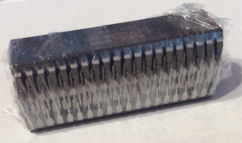

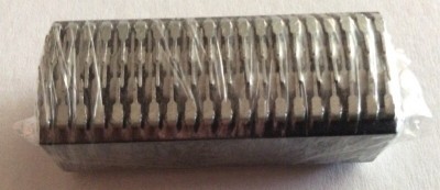

Another problem with buying CMOS chips (which are sensitive to static discharge) from the likes of eBay, is that you have no idea how the chip has been handled.
And then there is the packaging. For example look at this: Although novel and space saving, there has been no proper regard for protecting the chips from static discharge during handling, packing, shipping and when they get to you, how do you unwrap them without the risk of a static discharge?

I would try taking a syringe and injecting ordinary tap water into the package. That should be conductive enough to suppress discharges while unwrapping. Don't use distilled water for this - it's an insulator itself.

...how do you unwrap them without the risk of a static discharge?

I would cut a slit in each end and blow my humid breath through, then unwrap it rather normally. Virtually all CMOS parts have static-protection diodes which can discharge small amounts of static, without damage. They have to be tiny so they don't add a substantial capacitive load. I doubt the scavengers in China exercised any kind of static-handling precautions though.
