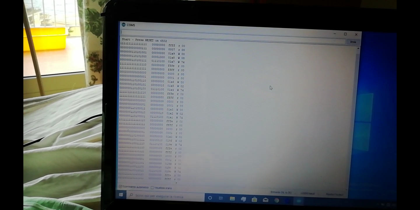

The terminal output shows that the CPU is operating but that its reading BRK instructions which are continually causing the IRQ/BRK vector at $fffe/f to be accessed.
We need to see your circuit. The 65SC02 is pin compatible with the 6502 so pin 1 should be connected to ground (there is no vector pull /VP output) and pin 30 should not be connected (there is no bus enable input).
It may be a working chip.

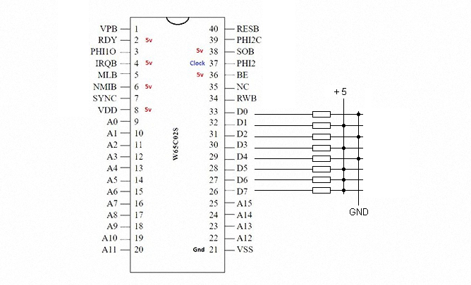

Thank you all! I am using this guide https://www.instructables.com/id/6502-M ... uino-MEGA/
I hard wired the resistors but whet it reads returns 0

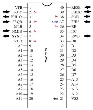

RDY, RESB, IRQB, NMIB and SOB should be pulled high with ~3K3 resistors rather than directly connected to 5V.
That is the pin out for a W65C02.
The 65SC02 has the same pin out as the original 6502. Pins 1 & 36 have different uses.
I should try one on my 3 chip board.

For a 6502 with $00 on the data bus, your machine seems to be behaving properly -- and $00 is what the screenshot shows. But you mentioned hardwired resistors for $EA, so is there a mistake or misunderstanding somewhere? Here (below) is what you need to get $EA on the data bus.
This may be obvious, but you should measure the voltage on the data pins of the 6502 itself to confirm that they're actually pulled up and down to the correct values. If they're not, you have a wiring error somewhere, or perhaps bad connections in your breadboard.
