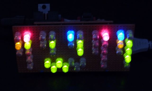

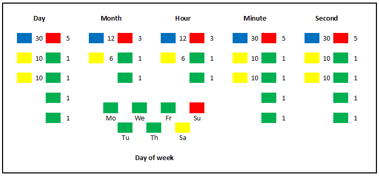

I build a radio clock 10 years ago, but with an ATMega8. So I will not build one again. However, the clock had its own way to display the time and maybe some of you will be inspired by it.
The time is counted on LEDs like an Abacus calculator. To match the 60 minutes / 24 (12) hours of how we count time, digits have different numbering schemes.
The 10^0 position of seconds, minutes and days works exactly as digits are counted on an Abacus. The 10^1 position however counts only up to 50. So the blue LED of the seconds shows also half a minute, the blue LED of the minutes also shows half an hour.
The base of 3 numbering system of the hours (and of the month) corresponds to the position of the short hand of a clock. The amber LED shows 6 and the red LED 3 or 9 for both AM and PM which is determined by the blue LED. The numbering system is simply copied to the month because I needed the space for the day of week LEDs.
So the picture was taken on Thurday, the 16th of January. The time was 14:05:43.

Interesting, but somewhat more difficult to read than I'd really prefer. It's not terribly difficult to drive segment displays, in a brute-force kind of way using shift registers with integrated constant-current drivers, but I haven't settled on exactly which method would be most efficient here. It's the kind of detail I've got plenty of time to work out.
