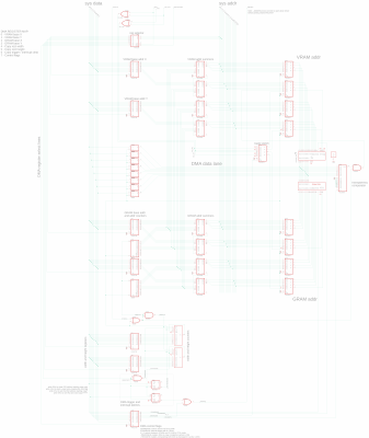

Wanted to share a design I've been working on. For my game console project I need a way to quickly transfer bytes into the frame buffer.
The scheme I'm working on uses a bunch of counter chips and some adder chips to march the target address ranges on the rising edge of the clock,
while strobing the write enable on the low phase. The controller operates on the dual-ported video RAM "V.RAM" and a normal SRAM dedicated as a staging area for
graphics "G.RAM". When a copy operation is happening the V.RAM and G.RAM are cut off from the rest of the system bus by FET switches. The controller copies continuous
ranges up to 128 bytes wide/pixels, and can repeat the copy on the next row up to a height of 128 rows. The width and height are controlled by a pair of 40103 down-counters,
one of which resets the X counter and increments the Y counter, while the other resets the flip flop that enables counting. This last reset signal can also optionally trigger an IRQ.
Additionally a comparator (wanted to use an 8-input NOR/OR but those don't seem to be available) checks whether the current byte loaded from G.RAM is zero. If it is, then the
write strobe is disabled. (If the transparency function is enabled, that is.)
Originally I was working on another version of the design that could perform copies in either direction, scale graphics by scaling the counter clocks, and tile the copy if the destination
rectangle was larger than the source. These features might eventually make it into a larger retrocomputer build, or an FPGA-based project. I'm aiming to make my console a little
smaller than the Nintendo Entertainment System, so I cut these features to reduce chip count.
Also at the top of the schematic the _WE2 and _OE2 are simply clock-qualified versions of RWB.
_OE2 = !(Phi2 && RWB)
_WE2 = !(Phi2 && !RWB)
The dual-ported RAM symbol looks like the single-ported one because in my Eagle library I'm representing the ports like two gates on the same chip.

Interesting project! And you've done a lovely job with the schematic -- it's laid out in a way that quite clearly implies what's going on. I'm not 100% sure I understand your comment about a dual-port RAM, however. And allow me to suggest that schematics for posting should be rendered in monochrome, and also not in such high resolution -- I reduced my copy by 50%.
You don't mention the speed you hope to achieve, but be warned that several of the chips you've chosen are rather slow. For example I would consider upgrading the 4040 and 40103 counters to 74HC4040 and 'HC40103. Also, I'm not sure why you've chosen to use several 4066 FET switches to connect the RAMs to the system data bus, but a single 74CBT3245 FET switch would be easier and probably better. Or, instead of a FET switch, you could consider just an ordinary transceiver such as 'HC(T) or 'AHC(T) 245. Better yet, if you use a '640 (which is the inverting version of a '245) then that multi-input NOR/OR you had trouble finding can be replaced with a multi-input NAND/AND instead -- the 13-input '133 NAND, for example.
On a more fundamental level, I can mention some significant advantages which would result if the RAM addresses were to come directly from loadable counters such as '161 or '163 rather than from '183 summers. But I needn't elaborate if you're at a point where such a reorganization would involve too much backtracking.
Thanks for sharing your project, Have fun, and keep us posted!

Thanks so much for the feedback, Jeff! Fortunately I'm already used to backtracking, as this is maybe my third redraw of the design.
I'd absolutely be interested to hear about the advantages in using the loadable counters directly. I had them in the last sketch but switched to the adders so I could share the same counters between source and destination.
As for the speed, I've got a bunch of 14MHz and 28MHz crystal oscillators from my video experiments. Optimistically I'd like to run at the 14MHz rate allowing for 14Mb/s transfers, or up to 873 full screen transfers per second. Even half or a quarter of this would allow plenty of time for drawing complex sprite stacks.
I probably should have added a note or updated the annotations before posting, but the 4040 and 40103 are definitely going to be the 74HC versions. My thinking for the 4066 switches was that I wanted something through-hole and easy to reason about. The 4066 has four switches per IC, so I'd only need two ICs to switch the data lines. If I use the 74H245, would it be enough to wire DIR to RWB?
Using the 640 and a multi-NAND is an interesting idea... I'd have to introduce another inverter on the signal generation side of the video board, but I'm already using a 573 to steady the pixel value between clocks so I could switch that to the 563.
OK, good; the HC versions are a lot faster. But re actual clock rates and prop delays I'll leave the calculations to you. What sort of computer are you attaching to, BTW?
Using the 640 [...] I'd have to introduce another inverter on the signal generation side of the video board, but I'm already using a 573 to steady the pixel value between clocks so I could switch that to the 563.
Oh! Right. I overlooked the fact the data also gets read by the other port on the RAM, as you explained.
As for loadable counters, they would improve the timing margins a lot, by eliminating the prop delay of the '283 adders. They'd also reduce the chip count somewhat, as follows.
For the X section the CPU would write to a '573, and from there the value would get re-loaded into a pair of 163's as each X sweep occurs. But we only sweep through the Y values once, isn't that right? So, for Y the CPU can write straight to a pair of 163's -- there's no need to have a 573.
:idea: Come to think of it, maybe it'd be better if the system were only capable of doing one X sweep at a time. This further reduces the amount of logic by offloading some of the work to the CPU... and the net result would still be massively faster than using software only. :!:
For each sweep, the CPU would write directly to X counters (no need to have a 573). For Y it would simply write to a 573 (no need for counters!).
For a setup like this I wouldn't use IRQ's to signal completion of the sweeps. After starting a sweep (by writing to X), the software would increment the Y value (held in a CPU register) then immediately attempt to start the following sweep by writing to Y and X again. But until the present scan is completed, writes to the logic would cause the CPU's RDY pin to get pulled low. (With an NMOS CPU, RDY doesn't work for writes; you'd need to stretch the clock instead.)
Just throwing the idea out there. I admit this "one X sweep at a time" is not so appealing if there's other useful work the CPU could be doing while the copies are in progress.

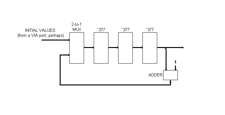

There's probably a way to design the DMA logic so it presents the block-move addresses and video-display addresses sequentially on a single bus.
register ring.png (3.03 KiB) Viewed 3686 times
Like this, for instance. '377 is an 8-bit register, so you'd need to pair 'em up to hold 16 bit addresses. But the idea is you'd have three values continually circulating through the ring. They'd be...
  • the display address
  • the block-move Source, and
  • the block-move Destination.
After each address has appeared at the output, it gets incremented before being fed back to the start of the ring. :) '377 is good for something like this because it can be instructed to ignore the clock signal. That'll be handy when initial values are being loaded into the ring.
By display address do you mean the one that the signal circuit looks at? I like the Rube Goldberg-ness of that circle of registers scheme, though one issue is that the display address needs to read every row twice since my pixels are two scanlines tall. It's also scaled to an odd fraction of the overall clock so that the image pixels all fit on screen without getting lost to overscan.
A 14 MHz CPU is probably fast enough to intervene during the horizontal retrace period, tweaking the value in the ring so the display address gets reset to produce the duplication you want. I admit I'm half guessing, but I do have experience with coding for the H-retrace period using a 1 MHz 6502.
That said, the ring's sequential-only access does make values tricky to reload. Instead, maybe the values should be stored and retrieved from a 4-word register file made of 'HC or 'F670's. Ring or 670, the idea is to replace a large number of counters with a single adder. And, to have a single bus on which the DMA addresses present in sequence (reducing the complexity of the memory-address multiplexer).
Just kicking ideas around. It may be feasible to scale the CPU clock to the pixel clock, rather than vice versa. How much variability do you need? Will your horizontal frequency always be NTSC's 15.75 kHz? Can the pixel clock be fixed to one frequency?

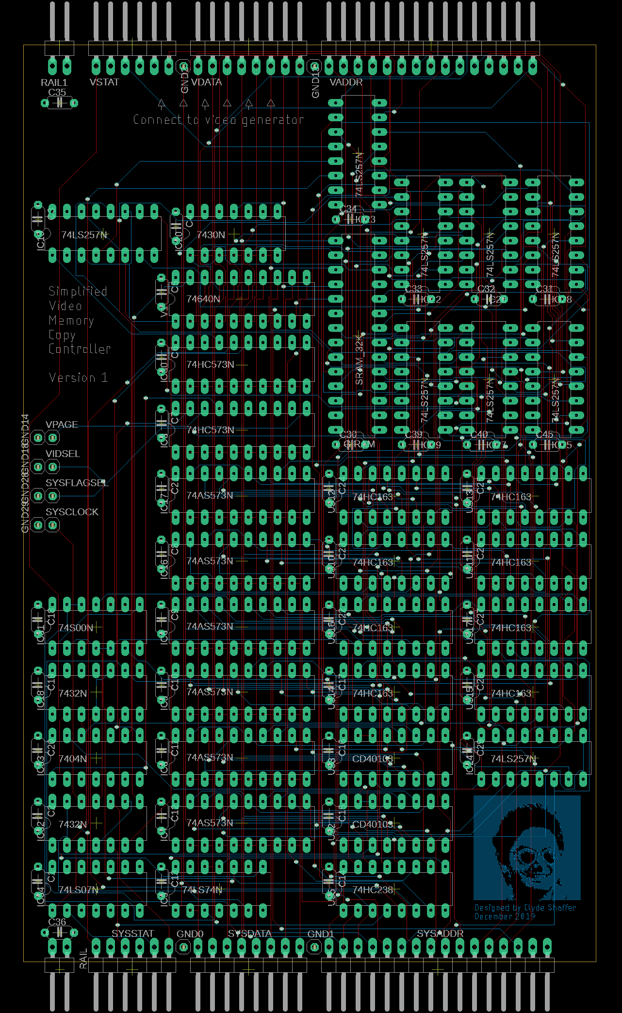

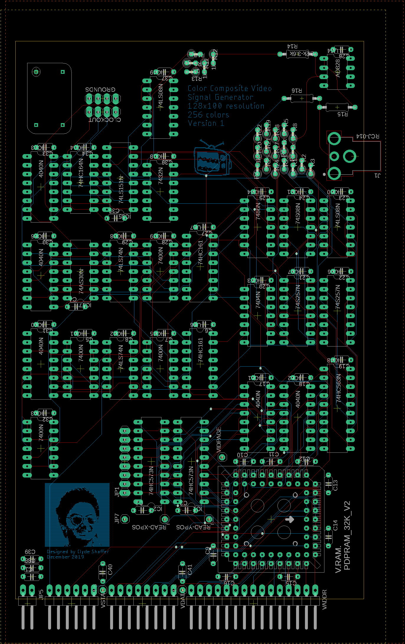

A little update on my DMA controller. I've switched from using the adder chips to using 74HC163s, and at least as far as the total delays are concerned I might yet be able to achieve the original 14MHz copy clock I'd hoped for.
The DMA and the composite video circuits together ended up being too many chips to fit within the current tier of EAGLE I'm subscribed to, so I split them into two boards that'll connect with a header.
The boards both have headers matching a backplane-style motherboard I ordered for prototyping. Although in theory the video card could connect directly to the system bus, it's mainly designed to connect to the top of the DMA card which then slots into the motherboard.
Composite video generator board
DMA controller board for VRAM
