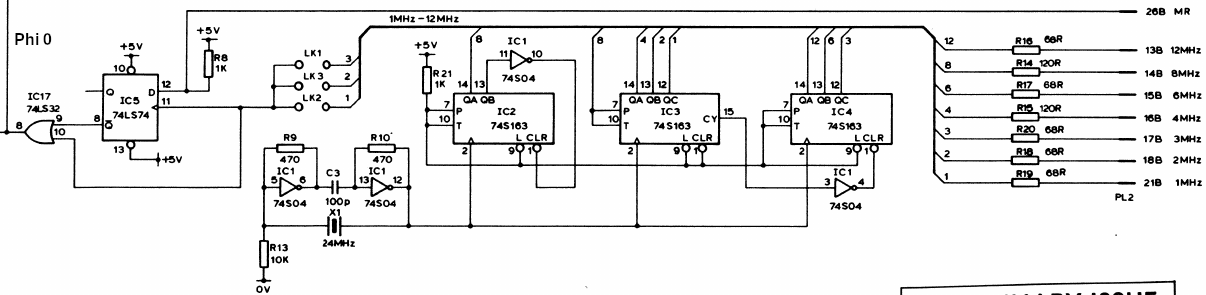

I'm bouncing ideas around in my head for a future computer build, which would involve a rehash of Acorn's 6502A microcomputer card as used in their System range (schematics here), but with additional RAM on board, etc. This card had the feature of allowing the user to select the clock speed from 1MHz to 3MHz via a set of jumper links, as all the clocks were generated from a master 24MHz clock.

  • Interrupt the clock circuitry while the 6845 is accessed - the 6502A card has a Memory Ready (MR) signal for this purpose, but no guidance on how to trigger it from other peripherals. (It's designed for the NMOS 6502, so leaves the Phi0 signal high.) Could I decide that any access of the expansion bus' I/O space will automatically trigger a low MR signal for the equivalent of a 2MHz clock cycle?
  • Use the READY pin on the CPU to halt execution for a few clock cycles when it accesses the 6845 - the 6502A card has a Bus Request feature of this design, intended for DMA use. I'm not sure whether this would be a better or worse approach than the one above

Using RDY on the 65C02 to generate wait-states can become problematic when there is a major chasm between the MPU's speed (officially 14 MHz, but capable of 20+ MHz) and the peripheral, the 6845 in this case. Your wait-state would need to have at least a seven clock duration (assuming a 2 MHz 6845), which is not a problem for the 'C02. The kink is in the need to qualify writes with Ø2 so as to avoid spurious accesses that can cause the peripheral to misbehave. This aspect of 65C02 circuit design has been well-hashed around here, so I won't go into any detail.
Succinctly, if the 'C02 is halted with RDY, steps must be taken to prevent the /WD (write data) signal to the peripheral from synchronously oscillating with the Ø2 transitions. I struggled a bit trying to handle that in a CPLD and then, in a rare fit of lucidity, conjured a relatively simple wait-state method that stops Ø2 in the high state, with no logic needed to deal with the oscillating /WD matter. The linked topic describes the theory and presents a circuit design that has been tested.

BDD, the approach you describe appears similar to the method Acorn used on this 6502A board, using their /MemoryReady input. Here's an extract of the diagram and a description:
Extract of Acorn 6502A Processor Card circuit diagram
A 24MHz crystal is seen at the bottom of the diagram, and three 74S163 counters divide this to create the various clock signals sent to the backplane on the right. LK1-3 selects one of the 1-3MHz clock signals to feed the circuit at the left of the diagram. The selected clock signal is used to clock the /MemoryReady signal through a 74ls74. The output of this 74ls74 is normally low (when the /MemoryReady signal is inactive high), and is updated only at clock transitions. It is ORed with the clock signal (74ls32), and its output is used as the Phi 0 input to the 6502A CPU.
The net result is that the presence of the active low /MemoryReady signal causes the output of the OR gate to remain high, and thus halts CPU execution until /MemoryReady returns high. (As it is an NMOS CPU, it has to be halted in the high-phase of the clock cycle.)
Going with this approach would need two further steps that I can see: identifying when the expansion bus is accessed (already done by the gate logic for the buffer for the data bus on the expansion bus) and determining how long the /MemoryReady signal should be held low.
I've since stumbled across Dr Jeffyll's design for a 74xx163 clock-stretching circuit, which definitely warrants more thought. At first I was thinking I could use it to generate the /MemoryReady input (with its stretched PHI2 output), but then it occurred to me that it could replace the original clock latching circuit (74ls74 and 74ls32) as well!
