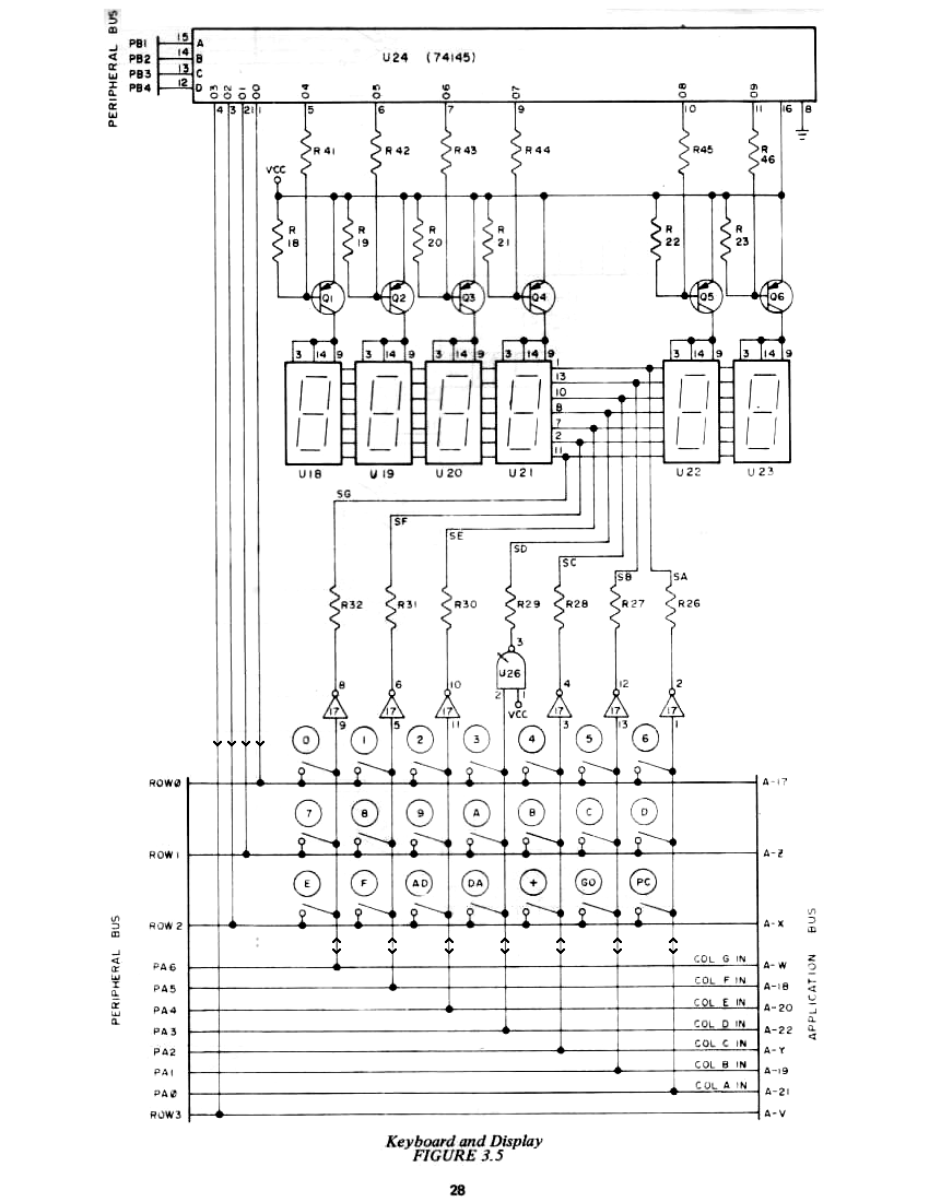

I've seen various techniques for driving seven segment displays. Without using PLD's or IC's with tons of pins, was it common for early manufacturers to multiplex the active segment rapidly? I've seen, for example, old alarm clocks on TV and you can see the flickering because the refresh rates were different.
I want to drive 6 or so segments myself with a single VIA. I'm thinking of using one port for the EEPROM address (using ROMS to drive each segment) and another port to rapidly cycle through chip enables.
In fact, might even use a counter or something and have one pin drive all segments.
Is this logic sound or is there something I'm missing?
Thanks

I believe it was common to multiplex digits, so that all segments that should be on for a single digit would be active at the same time. Note that this requires a mechanism to select a single digit at a time.

Multi-digit displays would cycle through the digits, displaying one at a time, quickly. A single digit only has 8 LED's, so on an 8 bit bus it's not saving you anything. You could use a latch to set the segment values.
If you meant you wanted to drive 6 digits, not 6 segments, then yes you can multiplex in software. It might be kind of flickery and dim if you drive them a single segment at a time, each segment only gets 1/48th of however you slice up time to light up.

Maybe I'm getting my terminology wrong. When I say "digit", I'm referring to the entire LED of 7 segments (or 8 if you count DP). And, I would have a single EEPROM that has it's data bus connected to all 7 (or 8 ) segments of the single digit.
Also, another good point on the brightness. I want four digits for the address display and two for the data. So yeah, each digit would only be on for a relatively short amount of time.

Yes, it was common. You have the trade-off between writing a bit more code or using more hardware IO pins.
You can get away with as little as one resistor per digit and nothing else - see e.g. https://projects.drogon.net/wp-content/ ... 7/led2.jpg This is on a Raspberry Pi, but the principle is the same. In this scenario I'm only lighting up one segment at a time so I have to rely on the software loop to scan fast enough to get them bright enough for persistence of vision to work without flicker.
(Note that the Pi can sink the same amount of current as it can source - not all IO chips or microcontrollers can, so this might not apply)
This article shows using one resistor per segment and a transistor to drive each digit (actually a uln2803, but the same idea) https://projects.drogon.net/raspberry-p ... t-drivers/ (see note below)
I prefer that way as it's lighting up one digit at a time rather than one segment which can reduce the flicker and make the software easier but it needs more hardware.
So 6 digits (which I presume you mean), I'd do it as follows: Use one 8-bit port for the segments. Put 8 resistors on the 8 outputs and connect to the segments which you've all wired in parallel - ie. segment A on digit 1 to segment A to digit 2 and so on. (Make sure the port can source enough current when all 8 are on!)
The common pin for each digit wired to a suitable transistor (or darlington) (and this will depend on you using common anode or common cathode digits). You may need a resistor to the base of the transistor, pick one to make sure the transistor is fully saturated when you turn it on. These 6 outputs go to 6 pins on the other VIA port.
Then:
Foreach digit
output the segments to make the actual number on the 8-bit port (use a 16-byte lookup table in ROM to map a 4-biy hex number to an 8-bit segment pattern)
enable common pin on that digit
delay (maybe just a millisecond or so)
disable common pin
repeat
If you had a regular interrupt routine then it could do one step of that loop every interrupt, picking up the data from 6 memory locations, then all you need do is update the memory locations from any code and it will "magically" appear on the display.
Simples
You can optimise the VIA ports by using external hardware, but you're then in the world of trading off software for more hardware and so on and only you'll know what's best - e.g. your counter idea. Use a single pin on the VIA (say one of the control lines) to clock the counter going to the transistor to enable each digit in turn. You either need to know the initial state, or have another line to act as reset for the counter. If I really had to optimise the VIA pins, then 3 pins would get me into 2 74x595 shift registers which would be enough to drive up to 8 digits - the software outputting a 16-bit value each cycle - 8 bits into the segments and 8 into the digit drivers. (Maybe even using the shift-register in the VIA to clock the data out)
I think the eeprom idea is nice, but overkill - you're using the eeprom as a 4 to 8 decoder (as I understand it). There are 74 series TTL that do it though - see 7446 through 7479 although that's optimising the bits on the VIA - using only 3 bits rather than 8 to drive each segment.

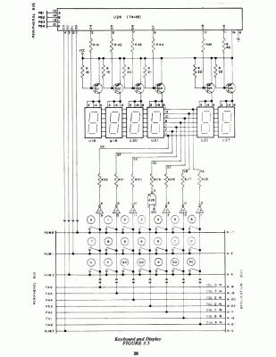

The KIM-1 display is a good example to study, especially since it's quite well documented in the KIM 1 User Manual.
Each digit (collection of 7 segments) remains off until it gets its turn, which is only 1/6th of the time (because there are 6 digits). The digit selection is made by the 74145 decoder at the top of the diagram. Driving up from below are signals for the seven segments, which originate from the peripheral port at the bottom. The port outputs data almost constantly, with that data being updated as each digit gets its turn.
To read the key matrix, the 74145 decoder is commanded to activate each of its four output lines on the left. The peripheral port at the bottom is temporarily switched to input mode, allowing keypress information to be read. For the program listings, see Appendix 1 of the manual.
ETA: nowadays the transistors and the inverters and NAND could be eliminated. They're used here to boost the current of the signals. But a modern decoder and VIA port could drive the display directly.
