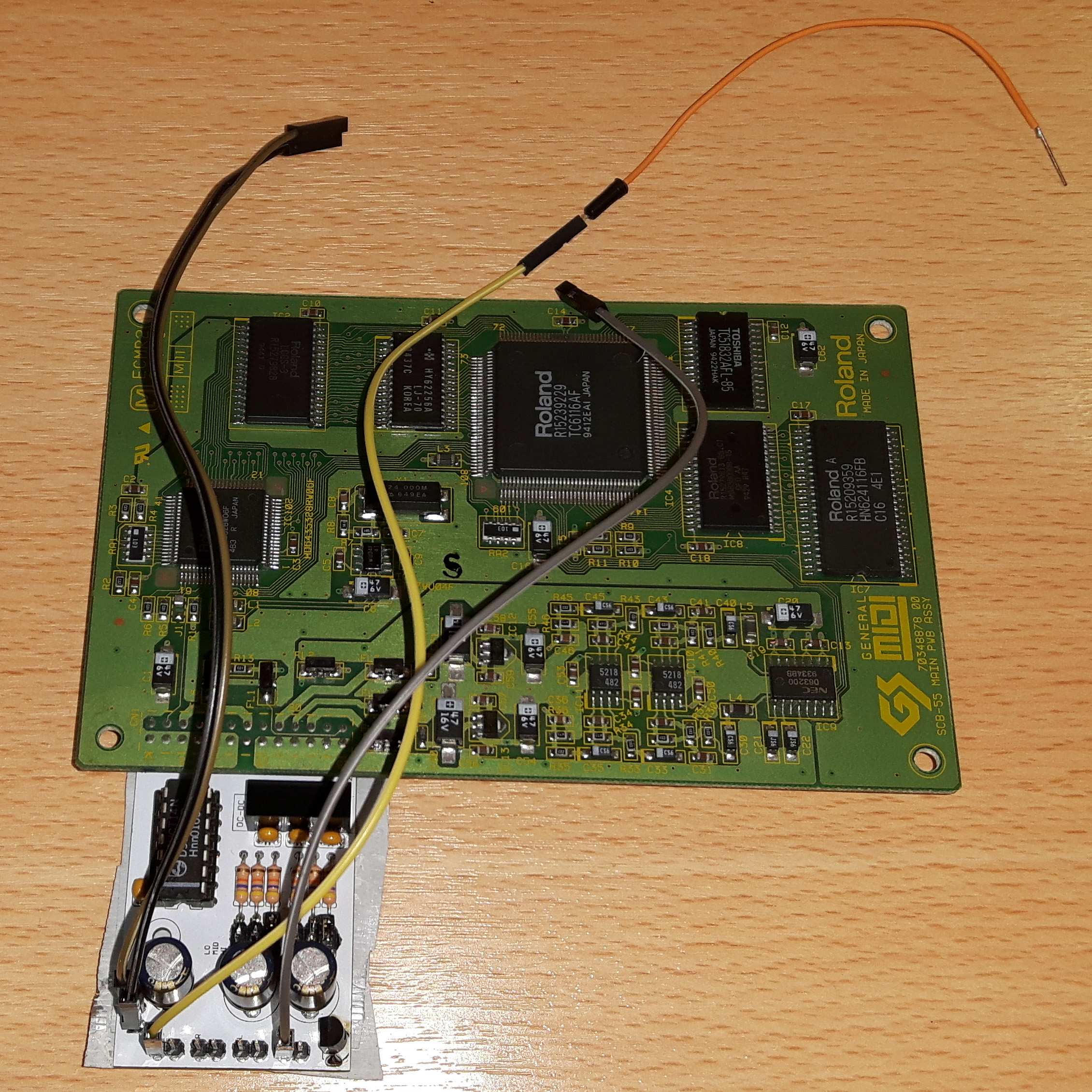

I’ve build a MIDI interface adapter for my single board computer. The output TXDB of my SC26C92 DUART is connected to the TTL MIDI input of a General Midi wavetable synthesizer (Roland SCB-55). I have 500kHz connected to IP5 which generates the needed 31,250 baud. Helpful schematics can be found at:
http://serdaco.com/files/BUILDINSTRUCTI ... LBOARD.pdf
The hardware and software is working, and I can send midi messages to serial port B.
