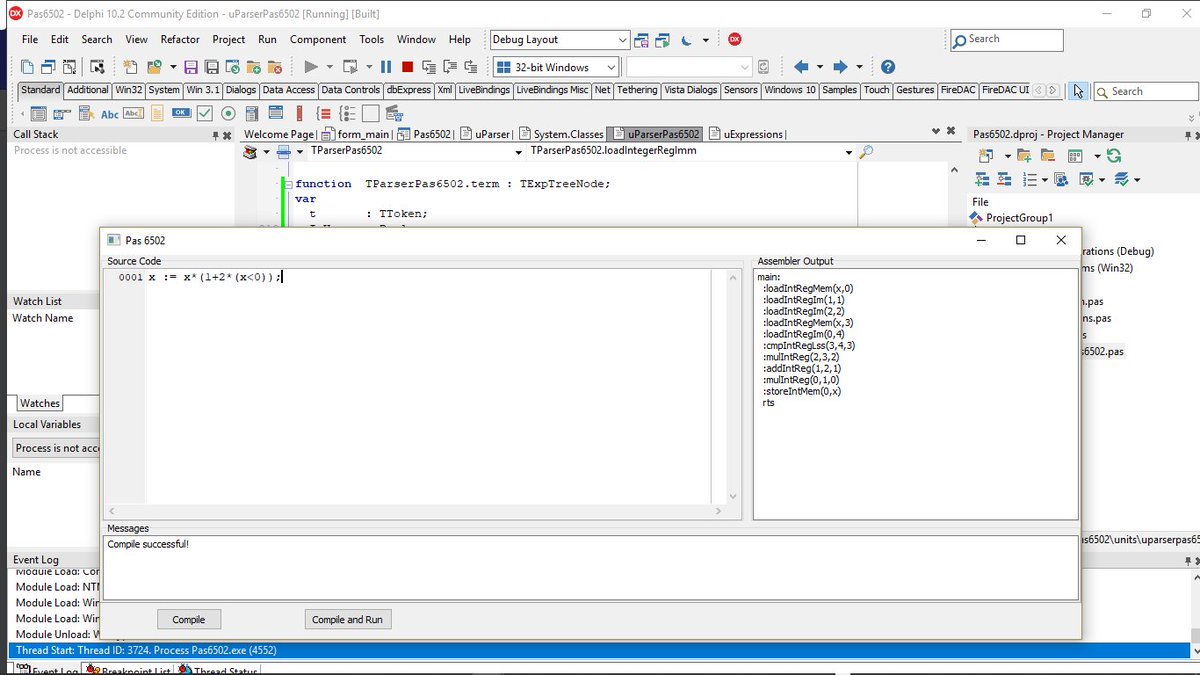

Hi all,
I'd thought I'd mention that I'm working on a project (part fun/learning/useful) called Pas6502 which will compile a dialect of Pascal into 6502 assembly code (using Kick Assembler macros and asm code). I will be starting with the C64.
I know there have been others, but I wanted to do this myself too :)
I have made a start where I can parse expressions using standard Pascal syntax, or expressions including mixed maths & boolean logic for tricky equations like the Dirac delta function (one line):
a := -(x=0)
or the absolute value function (definitely tricky code!):
x := x*(1+2*(x<0))
Which currently produces this code:
main:
  :loadIntRegMem(x,0)
  :loadIntRegIm(1,1)
  :loadIntRegIm(2,2)
  :loadIntRegMem(x,3)
  :loadIntRegIm(0,4)
  :cmpIntRegLss(3,4,3)
  :mulIntReg(2,3,2)
  :addIntReg(1,2,1)
  :mulIntReg(0,1,0)
  :storeIntRegMem(0,x)
  rts
I will be adding in expression simplification too which will include power of 2 div/mull -> shifts/shifts+adds.

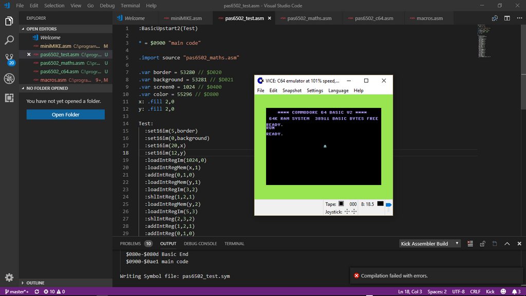

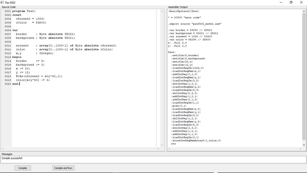

More #Pas6502 compiler progress...can now do basic math, store values into variables and absolute addresses (1 or 2 byte) [including arrays], and Poke() command added. More optimisation needed, but am very happy :) <committing to version control now lol>
Input example:
Output example (copied from the ASM window):
cheers,
Paul
"The plastic veneer of civilization is easily melted in the heat of the moment" - Paul Nicholls

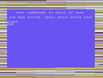

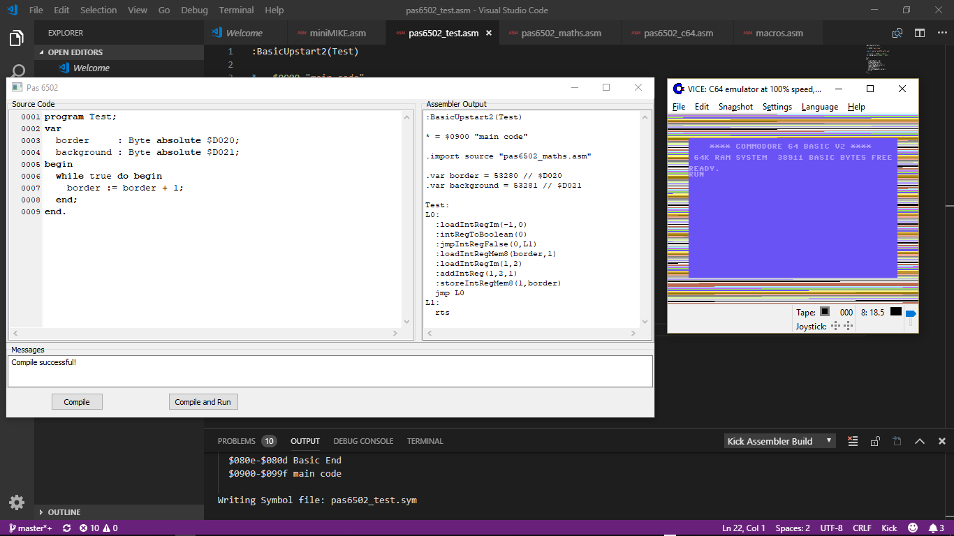

I've now added if and while statements to #Pas6502, and here is the obligatory infinite loop incrementing the border color lol
If anyone is wondering, I've been basing my code on the classic "Let's build a compiler" tutorial series by Jack W. Crenshaw here:
http://www.penguin.cz/~radek/book/lets_ ... mpiler.pdf
cheers,
Paul
