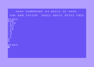

Hi all,
I have the following code which right shifts by 1 bit a signed 16-bit number:
.macro div2_16bit(address) {
  lda address + 1      // load the msb
  asl                  // copy the sign bit into c
  ror address + 1      // and back into the msb
  ror address + 0      // rotate the lsb as normal
This works well until I try to shift a number with the value -1 as I still get -1...
My question is, is there a fast way to test to see if I have tried to "divide by 2" the value "-1" and if so, set the value to 0?

As was already suggested, you can test for -1 before the division.
My question is, does the -1 result cause a problem with your program? In other words, does your program require symetrical integer division or can you use floored integer division?
With floored integer division, if the real result of the division lies between two consecutive integers, the lower value is returned. Since -1/2 is between 0 and -1, -1 is the correct result of -1 divided by 2.
Jim

If you need symetrical division ( without the remainder ), this code should do it.

Hmm...good question @JimBoyd...I might have been hasty as I do want floored division...I ultimately want to convert a 16-bit x value to its column value using the equivalent of column = floor(x/8.0).
I thought I could call my 16-bit signed shift routine 3 times to do this.
