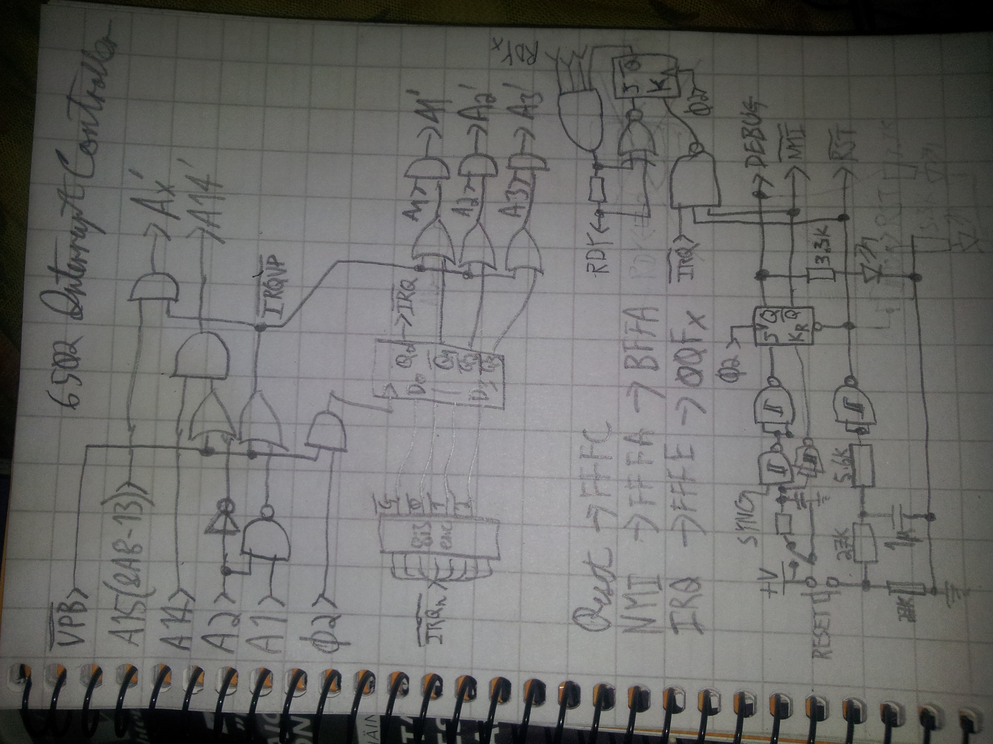

Re: Bootstrap Debugger
So, here's a first pass at my interrupt controller:
Eight /IRQs from various devices go to an 8-to-3 priority encoder, whose four outputs (/Q0-2 and /G) are latched in a quad D flipflop clocked by (/VPB & Phi2). The latter ensures that the low bits of the vector table address remain stable during the vector pull, since /VPB is valid at the same times addresses are, ie. it completely overlaps Phi2 at both ends. The latched /G goes to CPU /IRQ.
When /VPB is asserted low, A1 and A2 indicate which vector is being pulled - if both high, then it's IRQ, if A1 low then it's NMI, if A2 low then it's RESET. So I generate /IRQVP with (/VPB | (A1 ~& A2)), and /NMIVP with (/VPB | ~A2). The latter asserts on IRQ pulls as well as NMI.
My goal is to leave RESET alone, so that is still vectored through ROM, but to bring NMI down to the debug I/O window at $BFFx and IRQ down to a table at the top of zero-page. So A14' is (A14 & /NMIVP), and Ax' for x in {8..13, 15} is (Ax & /IRQVP). Then A1' is (A1 & (/IRQVP | /Q1)) from the quad D flipflop, and similarly for A2', A3'.
What's slightly nasty about this is that there's a 4-gate delay from A2 and A1 to A1' et al, and three gate delays to the other Ax'. It's not so easy to see how to get around that, though, and it probably doesn't matter since accesses incurring that path delay always go to the relatively fast 55ns SRAM, or to the debug port which will have a multi-cycle wait state.
An important property of this arrangement is that the actual IRQ vectors are in RAM, rather than in special registers that would be fiddly to wire up and to locate in the address map. I'm also keen to avoid using CPLDs because their static power figures are *terrible*, so the above amounts to six-and-bits-of-some-other 74HC chips.
Making a nice, reusable front-panel interface is being significantly complicated by the virtual extinction of hex-to-7seg decoder ICs. There's a few of the old 7seg digits with built-in decoders on eBay, but the datasheets for those strongly imply that they require a 5V nominal supply, not 3.3V. By contrast, I can buy any number of different varieties of BCD decoders which either blank or produce unreadable trash from $A to $F codes, and which are therefore useless for this application, even though adding support for hex digits wouldn't impair their BCD functionality at all.
That might be the one thing I can justify using a PLD or two for on this project, since it'll be associated with power-hungry LEDs and can be removed (and put aside for the next project) once the boot ROM is stable. Or I might punt on it and use LEDs wired directly to the bits, or possibly 4-to-16 decoders wired to bargraph strips.
Meanwhile, I've got a notebook page covered liberally with more details of the control circuitry I'll need to correctly sequence /NMI with /RESET on power-up with the debug switch set, and to correctly implement wait-state signals without incurring a power drain when the CPU executes WAI and pulls RDY low itself - which is, of course, when you most want to *save* power in a battery-powered machine. The combination of these two functions uses a pair of JK flipflops and all of a quad Schmitt-triggered NAND chip.
The RDY problem is that when the CPU goes to sleep, it asserts RDY (which is normally an input) low, but at that moment none of the external devices will be triggering a wait-state, so the controlling gate will be driven high. There will therefore be a current through the resistor dividing the two. One can reduce this current by increasing the resistor value, but this risks being unable to bring RDY high promptly after an external wait-state, which could be a performance problem. With a relatively low value (say 1KΩ) the drive is prompt, but the current is up to 3.3mA, several orders of magnitude higher than any other quiescent device in the system.
So, my solution is to detect the CPU's negation of RDY (using an XOR gate), and feed a latched copy of it back to the driver gate. Any of the three wakeup sources (IRQ, NMI, Reset) will then cancel that feedback and allow the CPU to fetch the appropriate vector. As a bonus, this provides a way to possibly switch to a slower clock, later on, so that the system activity in sleep mode is closer to actual quiescence.
RDY must be pulled up to Vcc with a suitable resistor.
Actually, the NMI redirection turns out to be a very small modification of the IRQ vector redirection I already wanted. Look at the way A14' is produced in a slightly different way from the other high address bits - that really is it.
Wait-states and power management will be needed anyway (because the EEPROMs won't run at 8MHz without help), and that accounts for almost all of the rest of the circuitry on that page - except for a DPST switch which functions as the "programmer's key" you mention, and interfaces with three Schmitt trigger gates that aren't needed for the reset circuit, but which come in the same package anyway so I might as well use 'em. Flipping the debug switch back to "normal" will have the side-effect of changing the faked-up STY instruction to a JMP, and releasing the wait-state holding the CPU for my input.
The pullup resistor's value is selected to allow the MPU to drive RDY low when a WAI instruction is executed. I use 3.3K in my POC units, which means RDY only has to sink 1.5mA to get itself to ground.
The use of the Schottky diode allows the MPU to sink RDY without loading the device at the other end of the "wire." When that device drives its output low, the diode will be forward biased and RDY will be pulled low.
I understand that. But 1.5mA is still a thousand times more than the 65c02 itself is supposed to consume when quiescent. It doesn't actually matter whether that's going through a resistor pulled up at one end by a gate, or directly to Vcc - it's still passing 1.5mA. It's a small waste, but to me, still a waste if there's a straightforward way of avoiding it. Remember, I had an NC200 that would literally last for weeks on a set of C-size NiCads, with files held in SRAM which, therefore, couldn't simply be powered down.
By actively setting the gate low when the CPU is found to have pulled RDY low, and only setting it high again when an interrupt or reset occurs, that waste of power is avoided. The cost is a few more gates on the board, which consume much less power themselves.
I won't claim there aren't any errors in my hand-sketched diagram. I've actually found a couple today, in the reset/debug switch circuit. But I don't put in circuits without a good reason behind them.
