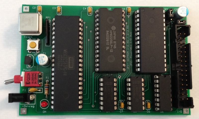

When I got back into the 65xx hobby some 4+ years ago, I opted to make a board set: one board with the CPU, ROM/RAM and glue logic with a simple bus connector and an I/O board (6551/6522). This has worked out quite well using a short ribbon cable to attach them.
If I were to do this again, I would do it a bit differently;
1- A different pinout for the I/O connector making it more flexible for using other I/O devices
- 32-bytes wide (rather than 16-bytes)
- Positive going Reset line
- Cleaner signal distribution on the 30-pin connector
2- Use a CPLD for glue logic so I can alter the ROM/RAM-I/O addressing
3- Provide additional logic for a NMI trigger
- My monitor supports a NMI panic routine, so having a way to invoke it would be nice
4- Likely a 4-layer board for better shielding and higher clock speeds
5- Onboard serial console via a USB connector
- Power switch w/center off allowing power select from USB or dedicated connector
Again, live and learn, but here's a pic of my CPU board, of which I have three running for the past 4+ years.
I'm using the machined IC sockets from Mill-Max and can easily insert a ZIF connector into the ROM socket which makes removing the EEPROM quick and easy. I prefer not to solder these to the board as they are expensive and can easily be reused for other projects down the road.

Actually, that's the setup I've been using on my CPU board. I have a bunch of 28-pin Augat NOS gold pinned machined sockets from years ago. I have one of these plugged into the CPU ROM socket to elevate it past the jumpers and nearby chips on the board, and an Aries ZIF socket plugged into that, works like a charm.
