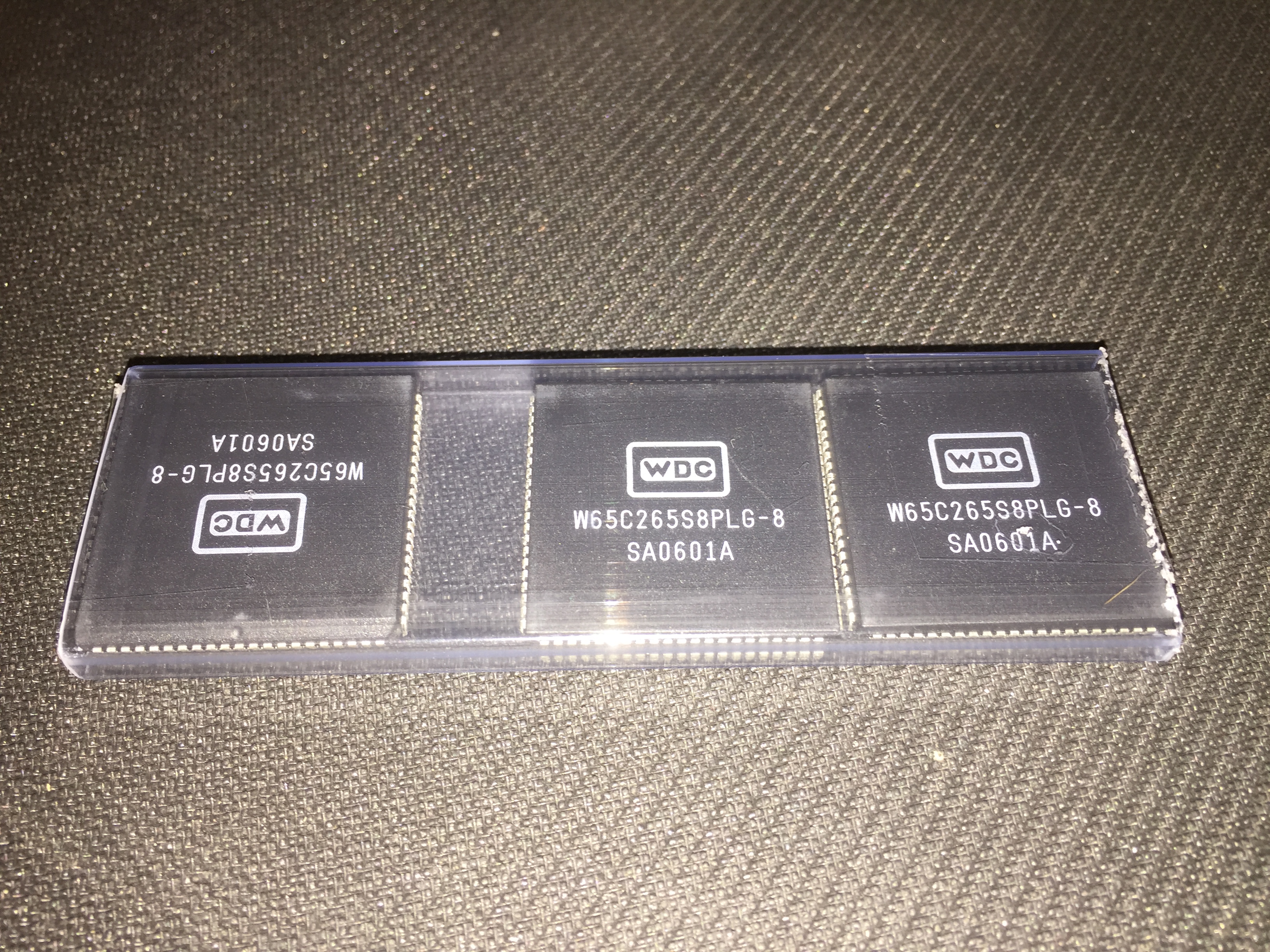

Today the postman bought me some new chips (from WDC indirectly).
I thought I'd build something like the 65C265SXB but with more SRAM (1 or 2MB), a faster oscillator (at least 8Mhz), EEPROM and maybe a bit of memory mapping in the first 32/64K region

Neat, looking forward to seeing what you build.
Re: A Better 65C265 Board
An 8Mhz W65C265SXB with more RAM would be really nice. I've contemplated picking one of those up and making a RAM card for it, but I don't know anything about board layout and all that to make a plug in board for one. Ideally it would be really straight forward with the modern high density static RAMs. Not sure how much decoding logic it would need, not much I would think because of the CS lines on the MCU. But the MCU already has enough I/O for my purposes, I'd just like some more RAM. The 8MHz wouldn't hurt either.
The $30 board just kind of crippled itself with the CS lines. But the other MCU board is still < 4Mhz. I think the monitor only has setting for up to 6+MHz in terms of having settings for the baud rate generator using the in built monitor. So I don't know what would be involved with getting an 8MHz one up.
