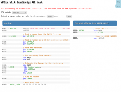

[I've mentioned this project a few times on this board, but I might as well give it its own thread.]
WFDis is an interactive disassembler, with the front-end written in JavaScript, for portability and to give it a nice presentation. There is a much more powerful back-end in development, but the front-end is reasonable enough to use on its own.
It now supports 4 variants of the 6502, including the 65C02. The new 65C02 support is largely untested, as I don't really work with that chip, but I've had requests for supporting it and it should bring more of an audience to trying it out, especially from this board.
Saving/loading the current state of the disassembly to browser localStorage, as well as downloading/resuming from local files is supported. Full export to .asm files is not yet there, but is forthcoming.
It is slanted towards the Commodore 64, allowing viewing graphics for characters & sprites right in the disassembly, BASIC line analysis, and has common ROM labels pre-installed when loading C64-specific file formats. However, general 6502 code should pose no issue, and it can load raw .bin/.rom binary files without any C64 specifics involved.
More docs are available in the "Help" tab in the upper right of the page.
There's still a lot to do in the front-end, but it is usable as is. Any feature requests, bug reports, and generally using it is certainly welcome. Some features won't be a part of the standalone JavaScript version, but take enough analysis oomph to be on the full server version only. This does assume a modern HTML5/ES6 browser, with no concessions for older systems. There's a section in the Help docs listing known issues that will be updated.
Interesting, but I find the disassembly tough to read with all that pastel-like color.

The help menu suggests that 'm' will toggle multicolour mode, BDD.

BDD: Would you prefer straight monochrome, or that the colors were simply closer in color/intensity but still distinguished?
BigEd: Multicolor mode swaps the display of graphics data between hires and wide-pixel multicolor; that was working, but is now on the bug list. I've changed some internal representations and event models, and there were a few casualties. When you switch bytes to a char/sprite display, it's only hi-res 1bpp for now.
I'd prefer monochrome—black on white. I don't see any value in color in this sort of application. If color is going to be used, high contrast colors would work best, for me at least.

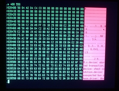

I'd be happy to see a monochrome mode too, possibly using bold or italic to distinguish datatypes. I'm no fan of low-contrast!
How about showing byte values as ASCII (or PETSCII) - perhaps in comments?
41,42,43 ; 'A', 'B', 'C'
or
41,42,43 ; "ABC"
Re: WFDis - 6502/65C02 interactive disassembler
Posted: Tue Feb 14, 2017 7:07 am
by BigDumbDinosaur
or
41,42,43 ; "ABC"
In other words, similar to what one would see when dumping memory in a machine language monitor.
Monitor Memory Dump
Monitor Memory Dump
