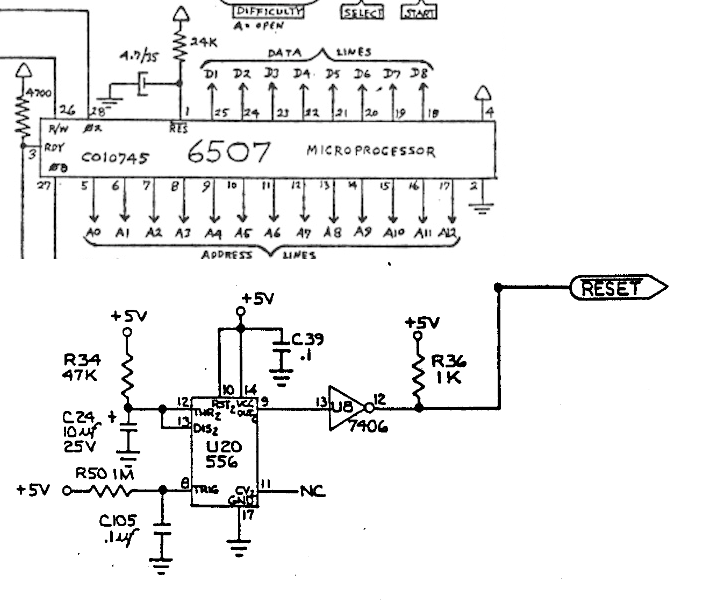

Atari 2600 have a 6507 chip which mainly has reduced address space and doesn't have interrupts.
As seen from the schematics the console doesn't even have a reset hardware, all that there is just a parallel capacitor with a resistor.
First question : How come this thing got a reset on cpu?

@richardc64 : Actually I was talking about the hardware part, of course there is no reset functionality provided to the end user on c64.
I examined the 2600 circuit again. It seems I misinterpreted the reset part. Pin pulled high with a resistor, also it's tied to GND with a capacitor. This setup generates the needed pulse on the Reset pin.
Here are the reset circuits of both systems. (2600 up, down is C64)
Re: Atari 2600 questions
Either way, the only way a reset happens is by cycling the power. There's nothing you can do about that without modifying the hardware, unfortunately. There may be a way to send the uP to the reset vector by telling it to JMP there from the cartridge port.
