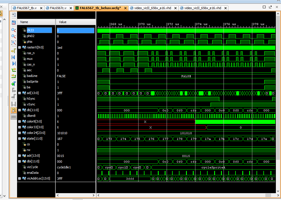

I just spent three hours trying to figure out why the raster 'Y' counter was updating at only half of the horizontal frequency only to realize I was looking at the wrong horizontal sync pulse and it was working after all.
Made some progress on the 'back burner' project in terms of developing the RTL logic. I wrote a wrapper that wraps up the FPGA64 video core to make it look like a VIC-II chip. It incorporates timing signals and a scan convertor. Got the memory access setup to use page mode for sprites. It's about 3,000 LUTs and 80k block ram. (Should fit into a Xilinx 7a15)
FAL6567 timing#1
FAL6567 timing#1
