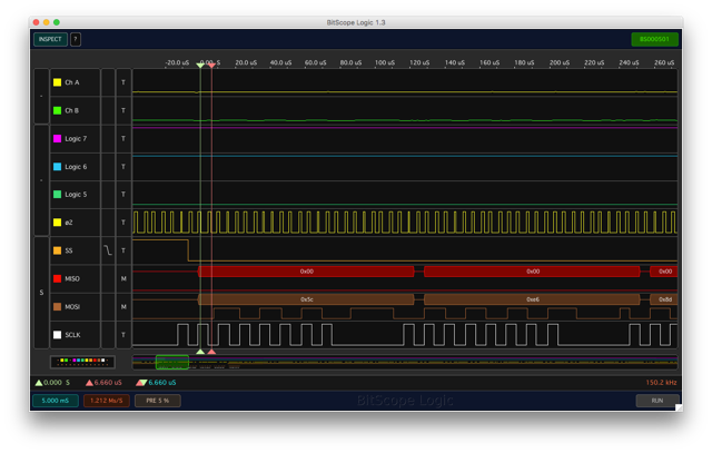

Hi all,
I am trying to get SPI working on an interface card I am creating for my Apple ][ (actually an Apple IIgs). I am trying to use the implementation by André for his CS/A65, rev 1.1A. I had to re-create the PHI2 signal, as the Apple ][ bus doesn't include it, by using a 74HCT74 as per Apple's TIL #494 info.
I had to rewrite the driver by André, as I use indexed I/O to the card (using /DEVSEL), but it was almost a complete copy-and-paste action.
However it seems the SCLK is out-of-sync with the MOSI/MISO signal(s), but I am at a lost right now of where the culprit would be....
I have attached both the screenshot of my logic analyzer (Bitscope micro/Bitscope Logic combo) and the source, written for ca65.
Does anyone know what might be solution to my 'problem'? I have this issue while both shifting under T2 and PHI2
Thanks in advance!

Post by fachat »
xjmaas wrote:
Hi all,
Which board of the CS/A are you actually referring to? Maybe I'm getting old and forget stuff, but the main board using SPI was using a CPLD for that and no bit banging.
In fact even the Commodore userport USB was using the VIA shift register and no bit banging.
IMHO bit banging is a waste of CPU cycles that can easily be avoided by using a shift register...

I guess phi2 needs to be recreated not because it is not included ( it isn't but phi0 should work just as well) but because the leading edge needs to be delayed.
The VIA is a latching in the register select lines when phi2 goes high. Systems with shared busses typically have video during phi2 low, so when phi2 goes high the register select is not ready yet. The C64 has this problem and it seems the Apple II also.
