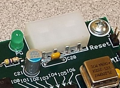

Furthermore, I place a 0.1µF MLCC as physically close as possible to the input bulk electrolytic (I generally use 100µF there, as I've got a bunch of them). Electrolytics often have poor high frequency performance and hence may not do an adequate job of bypassing high frequency noise to ground. The MLCC handles that for the electrolytic. The below image shows how I did this on POC V1.1:
POC V1.1 Power Input
The bulk electrolytic is C21 and the MLCC is C20. My concern was that switching noise not get out on the power supply connections, hence the tight positioning of C20 with respect to the power input connector.
Each chip on the board has an MLCC bypass, as seen in the below image.
Here again, the MLCCs are placed as physically close as possible to the end of the device at which the VCC connection is present—you want the connection between the MLCC and the VCC pin to be as short as possible. Note that the clock oscillators are also bypassed—they can be a fertile source of noise.
It's best to think of bypass capacitors as like money: more is good! :D
I am going to add the electrolytic and MLCC to my power supply schematic. Is the following schematic correct?

Re: Finally starting the schematic for my first W65C02 SBC
Posted: Tue Apr 05, 2016 7:21 pm
by GARTHWILSON
Yes, that's good. Make the monolithic ceramic capacitor's leads as short as you can, since they have inductance.
