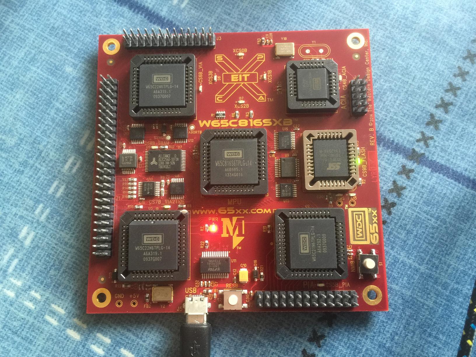

I ordered a W65C816SXB yesterday to try some code out on - Quicker than building my own but a bit pricey (£160 so far and I might be done for import duty -- ordered from Mouser UK but being delivered from TX, USA).
Its a bit of shame that the board only comes with 32K on onboard RAM and its not entirely clear how the 128K Flash ROM works -- one line in the 'datasheet' suggests that there are some bank selection pins on one of the connectors.

My SXB has just arrived and I can already see that the surface mount tact switch for the NMI interrupt was not well soldered and has come off the board.

I've soldered the TACT back on and tried the demo project.
When I try to create my own project I get an "Failed to set 'Version'" error when I try to close the options dialog.
version error.jpg (20.74 KiB) Viewed 2575 times
I can assemble a code module and get a listing but I can't link yet. The TIDE documentation is not very detailed.
It looks like you need to define a 'shadow' vector table as part of your code (its in the demo) but there is no documentation describing how the WDC firmware interacts with your program.

Ok. So I now have the UART working at 19200 (the top speed) and can confirm that the 65C51 ACIA is one of the bugged versions.
WDC sent me a copy of the schematic which allowed me to investigate the flash ROM. It can be reprogrammed under software control. A couple of VIA outputs can be used to select the active bank and the ROM has software unlock sequence to allow writing.

I managed to download and disassemble the WDC firmware. There are no references to the VIA I was using it so I think the problem lies in their debugger.
I had a memory window open showing the VIA registers and it was reading the values from memory. Unfortunately reading some of the timer latches and counts clears the interrupt flags so the debugger was clearing the interrupts before my code had a chance to see the flags. I have a suspicion that even when the window is closed the memory is read in the background.
I've managed to switch pages in the 128K flash ROM but the ACIA is being very unreliable. It periodically locks up until it has received a number (~30) characters then it starts working again. I did at one point take control of the USB Serial FIFO and use it as a COM port. When you take control the debugger locks up and has to be killed with task manager.
