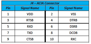

On page 7 of the board manual note how the ACIA pin out looks like a copy and paste of the start of the 65C22 table
http://www.westerndesigncenter.com/wdc/ ... 816SXB.pdf

That is somewhat disappointing regarding the switch. I also caught the pinout on the ACIA being a copy/paste on the 65C02 version and alerted David at WDC... he fixed it in the C02 version PDF, then I found the same on the C816 board. Here's the correct pinout:
I'd be interested to know the Lot# on the W65C51, to see if it's the known Xmit bit buggy version.
What version of TIDE are you using?
I downloaded the latest 2.0.5.0 but I've abandoned it for now and am using a Makefile with Microsoft NMAKE to drive the build.
I guessed the pin out would be the same as the 65C02 board but would like it confirmed and documented properly. I think they should also make the location of pin 1 explicit for each of the connectors in the board picture.
