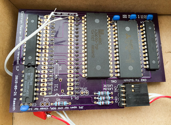

Ah, just thought of another case: Acorn's Electron has nibble-wide RAM which takes two ticks to access, and also has to provide video data. So the CPU is often running below speed (although it can run at full speed from ROM, or when only low resolution graphics are displayed.) There is an accelerator board (or two?) which replaces the CPU and provides some local memory which can run at full speed. (Edit: See http://indosingo7.com/_lain.php?_lain=5 ... urbo_Board)
