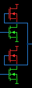

I remembered that we had discussed accumulator register couple months ago. They may agree or disagree whatever they think 1 win-win or 0 win-win. I will like to revisit the discussion today.
I omit the pass gate transistor from top transistor's output and bottom transistor's output on the shared node. The pass gate transistor is not shown on the picture. Let's focus top transistor's input and bottom translator's input. We know that two omitted pass gate transistor's gate is connected to cclk (943) and SBAC (534). Both cclk and SBAC are set high at the same time. You always claim 0 win-win.
Go back and think two inputs. If two inputs are set low, then 0 win-win is always true. What will happen if two inputs are set high? 1 win-win is always true. The current comes from top transistor's output and bottom transistor's output on the shared node. Possibly, two currents collide in one node.
If top transistor's input is set high and bottom transistor's input is set low, then the current from bottom depletion transistor flows into top enhancement transistor. The output node is considered to be metastable. The metastable value appears to have weak low signal.
If top transistor's input is set low and bottom transistor's input is set high, then the current from top depletion transistor flows into bottom enhancement transistor. The output node is considered to be metastable. The metastable value appears to have weak low signal.
After you power up 6502 MPU, two accumulator register's depletion transistors receive power at the same time before two outputs will be 1s during the first cycle and they will be 0s during the second cycle and again, they will be 1s during the third cycle and again 0s so forth as their values are metastable.
The accumulator register's value will be stabilized with valid 0s or 1s from SBAC input after metastability ended.
Here is the picture.

Re: Two transistors' Output In One Node
Posted: Fri Jun 05, 2015 4:05 am
by BigEd
What you have there [in the diagram] is something like a wired-NOR. The two pullups are in parallel, so they will act as a single, larger, pullup. So that's the logical function of a NOR, slightly more resistant to pulling down because more eager to pull up, and therefore the electrical threshold will be higher than it otherwise would have been.
You'll notice [in the 6502] that there are some unusually large transistors handling the databus input, to shift the logic threshold, this time towards lower voltages (the pulldown is much larger than the pullup)
http://visual6502.org/JSSim/expert.html ... 5&zoom=5.0
There's nothing metastable going on here.
Posted: Fri Jun 05, 2015 4:10 pm
by Bryan Parkoff
If a single, larger, pullup is true, then 1s flows into the single, shared node toward accumulator register while two inputs are low or one input is high and another input is low. If both inputs are high, 0s flows into the single, shared node, too.
Posted: Fri Jun 05, 2015 4:38 pm
by BigEd
Sorry, I don't understand well enough what you're writing to help - I was responding to your image. If you tie together the outputs of two inverters, in MOS technology, you have a NOR gate.
