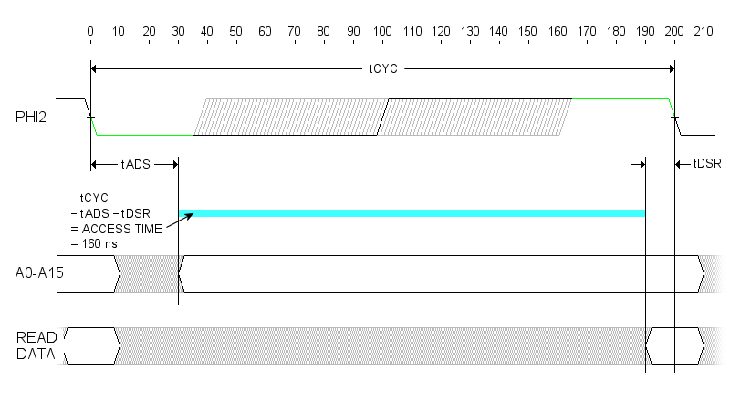

Visual Guide to 65xx CPU Timing
The animated "rubber band" diagrams in this article are drawn to scale (unlike most in data sheets). They offer insight into real-world timing margins and the tradeoffs between them.
Comments and questions are welcome here in this forum topic. The article itself is subject to editing and re-editing if there's anything I've overlooked, and may be considered a work in progress. :) Thanks, Garth and Ed, for your advance input on what I've written so far.

No, some of these points have already been the subject of discussion. But it can be a slippery topic to deal with piecemeal. That's why I wanted to try to clear the deck and lay out the basics. As for the diagrams, I know that's how I mentally visualize timing matters myself. So I decided to render them as GIF's, on the premise that a picture is worth 1,000 words. (or 1024 words maybe!) :)

I'm pleased with how the animated GIF's turned out. I just hope they render properly in all the various browsers out there. So far the only problem I've noticed is that GIF03 makes me seasick if I watch it too long! :wink:
