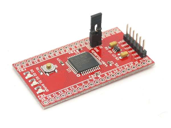

This could be of interest: $15 for a CPLD on a DIP-footprint dev board:
Inputs are 5volt tolerant and can be run from a single 3.3volt supply.
Easy to program with the Bus Pirate
40-pin (actually 40-hole) board, looks it might be 1inch between the rows.
More info: http://dangerousprototypes.com/docs/CPL ... ic_devices
Via http://www.stardot.org.uk/forums/viewto ... 136#p81136

This looks pretty good for the cost. It doesn't come with a JTAG -> USB cable. I'm wondering if anyone knows of any deals for those. I would hate to spend $40 on one for a $15 board. I've seen them go for like $9 on ebay from China, but I don't know if they would work.

A PLCC44 to DIP44 adapter, to good effect *. Then you can pop in a 5V XC9572 (say) ie. use the same parts as you would on your finalised PCB.
One downside is you need to manually pin in the JTAG header, and of course you'd need a Xilinx USB programmer.... But I assume that's the case for that breakout board too.
