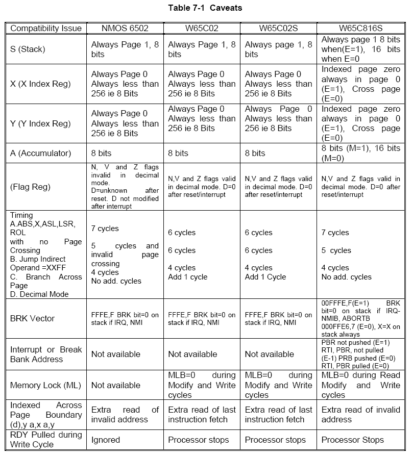

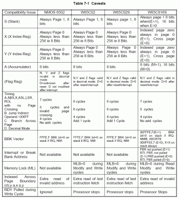

FWIW, a good place to start is the '816 data sheet. You've seen this, I guess... :)
