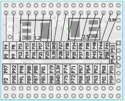

Summary: I present the design and implementation details for what may be the most inexpensive and minimal FPGA board. The board is capable of hosting Arlet's core with 8K of RAM/ROM running at 100MHz, glue logic and custom IO. I will update this top page with the most current information as needed.
Features
-Fast Xilinx XC3S50 FPGA (grade 5), 768 slices, 8K BRAM
-60MHz oscillator (other frequencies can be derived easily)
-Onboard power regulators (1.2V and 2.5V)
-Xilinx Platform Flash
-Native JTAG connection to both FPGA and Platform Flash
-60 IO pins connected (2 are limited: oscillator input and LED output)
-3.3V operation, 5V tolerant (according to information available, not tested)
-IO pin layout allows breadboarding, PCB or wire wrapping
Possible uses
-Stand-alone 6502 controller (like arduino but with a 100MHz 6502!)
-A controller with up to 4 PicoBlaze processors
-Glue logic for 6502 (or any) project
-Custom circuitry and interface (keyboard, mouse, VGA, SD card, etc)
-Anything you can imagine

The board is a plain-vanilla FPGA with a JTAG interface, so there is nothing special about using it. Any circuit that fits the XC3S50 should work.
