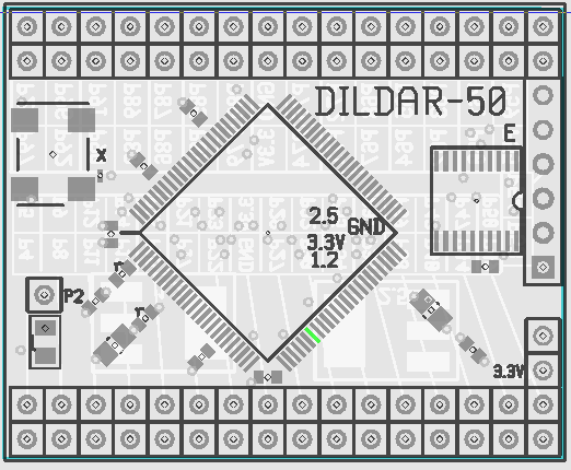

Top view of the layout (rev E):
On the upper left, crystal oscillator with a shorting block to disable it (in case you are using an external clock and need the IO pin). The LED is on the lower left (marked 'l'); the FPGA pin is available here as well. Decoupling caps are small (0603) pads, power caps are larger (0805) pads. There are also two resistors, 330 Ohm for the LED and a 120 Ohm for the power supply. Also visible are pads for the FPGA and the Platform Flash.
On the right side there are two connectors: a 6-pin JTAG and 3.3V/GND inputs.
