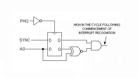

to indicate to the machine that a fetch is the start of an instruction and not an interrupt, you'd need hardware logic that would say OPCODE_FETCH = VDA & VPA & ABORTB & IRQB & NMIB.
That approach presents challenges. Even qualified by SYNC or by VPA and VDA, a low on an interrupt input doesn't equate to interrupt recognition. The interrupt signals pass through on-chip flipflops as a form of input conditioning, resulting in latency prior to recognition. More daunting to predict is the variable latency due to branches taken, as mentioned here. Also you'd need to accommodate the fact that IRQB is internally maskable, again affecting recognition. These problems are solvable perhaps but there's a tidy alternative solution: just look for the missing increment of the PC that occurs when the interrupt does get recognized. As shown below, flipflops and an XNOR gate can detect the increment (or lack of same). If the RDY input is in use (ie; wait states exist), use a '377 type flipflop with its data Enable input also driven by whatever drives RDY.
cheers,
Edit: XNOR, not XOR
