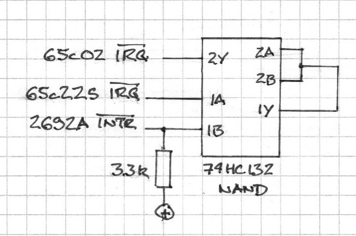

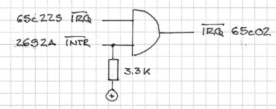

Mouser sent me the wrong type of VIA 65c22, the S version instead of the N version. I ordered an N, the invoice says N, the little label on the anti-static bag says N, the chip has an S printed on it. Argh.
So after my initial attack of huffy-puffy righteous annoyance, I re-read the data sheet for the 65c22 (which was not really helpful) and then Garth's texts on the matter (http://6502.org/tutorials/interrupts.html, http://wilsonminesco.com/6502primer/IRQconx.html, and viewtopic.php?f=1&t=1953&p=16482&hilit=65C22S#p16482, which were). Now I'm wondering if this is not a Good Thing. If I understand the differences correctly, the S totem-pole interrupts are slightly faster, but need a bit more glue logic. The other interrupt source in the computer is a 2692A DUART, which has an open-drain output that needs to be pulled up by a resistor. Adapting Garth's drawing (of the circuit, not the cartoons, never the cartoons), I'm thinking the logic would look something like this:
As for the actual implementation, here is where I would be grateful for guidance. Since I'm going to use a bunch of 74HC132 NAND gates in the design anyway (which come with those nice Schmitt triggers), I was thinking of NANDing instead of ANDing, and then feeding that signal back on itself in a second NAND gate to invert it the way we need it. Something like this:
However, that means we go through the chip twice. Data sheet tells me that this would cost a 2 x 11 ns delay. I have no feeling at all if this is a lot. It doesn't really seem that way, given I'm aiming for a 1 MHz clock, with anything above that "nice to have". Still, would it be worth including a "real" AND chip and saving those 11 ns? More generally, how long of a delay in the glue logic should make me worry?
Thanks.
Thanks.

Re: IRQ with the 65c22S instead of the 65c22N (with 2692A)
Outdated cartoons notwithstanding
, the few ns delay on interrupts will be pretty insignificant. It definitely won't keep anything from working like excessive delays in address decoding would. 11ns difference with a 1MHz clock will only mean that one time out of about 350 (on average), the servicing of the interrupt will get delayed by one instruction. Hardly a big deal.

So after my initial attack of huffy-puffy righteous annoyance, I re-read the data sheet for the 65c22...Now I'm wondering if this is not a Good Thing.
The 65C22N is intended for replacing the old NMOS 6522 in units that used the NMOS 6502. As such, it has the open-drain IRQ output, along with current limiting resistors on the signal outputs. You're ultimately better off with the 65C22S.
The internal logic in the 65C22S isn't any faster than in the 65C22N. Where the totem-pole output helps is in greatly reducing the time it takes for /IRQ to go high once all interrupt sources have been cleared. If the rise time is excessive you may run into trouble with spurious (aka phantom) interrupts that will drive you to drink.
The other interrupt source in the computer is a 2692A DUART, which has an open-drain output that needs to be pulled up by a resistor. Adapting Garth's drawing (of the circuit, not the cartoons, never the cartoons), I'm thinking the logic would look something like this...
As for the actual implementation, here is where I would be grateful for guidance. Since I'm going to use a bunch of 74HC132 NAND gates in the design anyway (which come with those nice Schmitt triggers), I was thinking of NANDing instead of ANDing, and then feeding that signal back on itself in a second NAND gate to invert it the way we need it...
If there's any one place where you don't want to introduce unnecessary delay it's in the IRQ circuit. I absolutely would not do what you describe in your second illustration. Aside from the added delay between the generation of an IRQ and receipt of it at the microprocessor, there's the Rube Goldberg factor to consider.
You have two approaches to take:
- You can use Garth's circuit, using a 74F08 (2-input quad AND gate) or for a bit more expansion capability (e.g., more 65C22's in the system, a 74F21 (4-input dual AND gate) (see attached datasheets below). I recommend the 74F logic because its internal propagation time on a low-to-high transition is no more than 5.3 ns at standard conditions. The MPU wants to see the sharpest possible transition at its IRQ input, and this is the way to achieve it. An alternative to the 74F08 is the 74AC08, which is a hair slower at 6.3 ns. The 74F08 has better fanout, but this isn't an issue if you place the gate close to the MPU to keep the interconnection as short and direct as possible.
The main advantage of doing it with a gate is that you can connect multiple 65C22s to the circuit. As the output of the gate actively drives the MPU's IRQ input in both directions, a spurious IRQ from one of the 65C22s is highly unlikely. You can still run into trouble with spurious IRQs in the 2692's IRQ circuit if you make that connection to the gate excessively long. Incidentally, I'd reduce your pullup resistor to 2.2K and use a 1/8 watt metal film (best) or carbon film (good) type to reduce reactive effects. Definitely avoid carbon comp resistors in any computer circuit that is expected to run faster than a five dollar pocket calculator.
- You can dispense with the AND gate and set up a standard wired-OR IRQ circuit, the same as what you would use if the 65C22S weren't in the circuit. To attached the 65C22's IRQ output to the wired-OR circuit, you'd connect the anode of a Schottky diode to the wired-OR IRQ circuit and connect the diode's cathode to the 65C22's IRQ output. Connect the 2692A's IRQ output, as well as a pullup resistor, to your wired-OR circuit. When the 65C22 drives its IRQ output low, the diode will be forward biased and will pull the wired-OR IRQ circuit low. When the 65C22 IRQ output goes high, the diode will be reversed biased and the pullup resistor will return the wired-OR IRQ circuit to the high state. If the 2692 interrupts, it will pull the wired-OR IRQ circuit low, but since the diode will continue to be reversed bias, the 2692 will not affect the 65C22 and the circuit will work as expected.
If you don't plan to attach more than one 65C22 I'd go with the diode circuit. It's simpler and doesn't require anywhere near the board real estate of the AND gate. Regardless of which circuit you decide to use, be sure to keep the IRQ connections as short and direct as you can make them. A little over-design in this area is not a bad idea.
Hard to argue with the simplicity and size. Since this SBC is only going to have a 2692A and one VIA 65c22, that will be just fine. Thanks!

(EDIT: Corrected drawing, thanks to Arlet. This was actually a very instructional mistake, because it made me realize I've been thinking in terms of how "the signal" is flowing (from the 65c22 to the 65c02) instead of the actual electricity. Still annoying, of course.)
I think your diode needs to be reversed.
