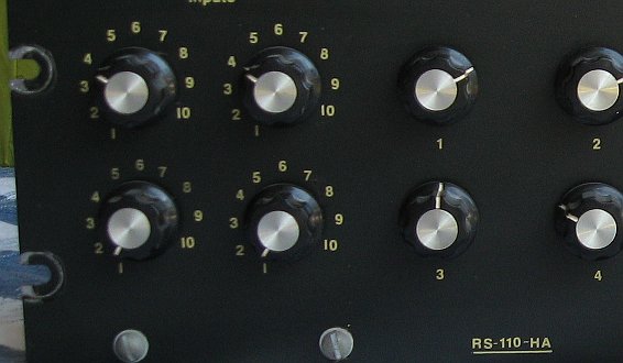

Now before i start mounting switches and leds on the front panel, i need to somehow paint the marks, labels, and stuff, i don't want a blank front panel. I thought about making a mask, and then using a white spray, but i am not sure how would this end up. I could also stick transparent labels, but i don't know where to find someone who would stamp them for me, and how would it look like in the end. Do you have suggestions on how to make the labels and marks for the front panel?

Use transfer (rub-on) lettering. Black is most common, but I've gotten white too at an art supply, and I think I've seen other colors. I put a clear coating over that to keep it from flaking off. As you can see, the coating has turned somewhat yellow; but it's almost 35 years old!

I really like your rub-on suggestion, if you could explain the process a bit more.

The rub-on lettering comes in transparent sheets so you can see the surface behind to position the letter exactly, then just go over it with something like a dry ball-point pen, without moving the sheet, until the entire letter is transferred. The first thing that came to mind is to pull out a sheet and take a picture to post, but it has been so many years since I've used it that I can't remember where I have them stored anymore.

In my day we called it Letraset - whether it always was, or whether that had become a generic term, I don't know.
http://www.letraset.com/products/91-Lettering/
("Dry Transfer Lettering" seems to be the approved term)

I painted the housing in black, so i need white letters.
Could this work: http://www.ebay.com/itm/Letraset-dry-tr ... 19d09b5e90
3/16" is about 5mm if i am right...

Looks good.—3/16" is about 4.76mm.

As for the rub on method, i just take the sticker and apply it on the housing with pressure, and then i remove it and the letter is there permanently, or what?
