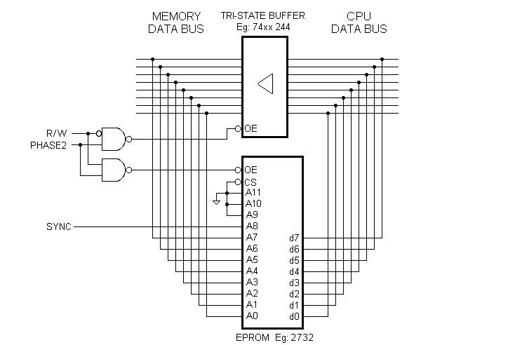

I think Dajgoro's topic is more interesting than it perhaps first appears. Granted, it's not very exciting to force an NMOS '02 to mimic what a 65C02 can do -- that's something that a simple CPU swap can achieve. But in more general terms, the Virtual Instructions could be used for almost anything -- for example, a Wozniak-style Sweet Sixteen interpreter. And the scope is substantial. The 65C02 has 46 unused opcodes that could be converted into unique software interrupts. The NMOS CPU has 105.
On the hardware side, I came up with an approach that's actually quite simple. It also has shortcomings, but for discussion's sake it's a useful place to start.
On Write cycles, data passes outward from the CPU through the tri-state buffer to memory. On Read cycles, data returning from memory is passed to the EPROM. Regarding the EPROM...
When SYNC is low, only the bottom 256 bytes of the EPROM can be accessed. Their contents are such that address $00 sends $00 back to the CPU, $01 yields $01, and so on up to $FF which yields $FF. Think of this as being a substitution -- with every value replaced with itself. :)
When SYNC is high (ie; op-code fetch), the next 256 bytes are used and the effect is similar. But the contents are such that certain substitutions -- those corresponding to illegal op's -- yield $00, the BRK op-code. This triggers the interrupt, and after that it's all a matter of some (hopefully very clever) software!

I wrote:
On the hardware side, I came up with an approach that's actually quite simple. It also has shortcomings [...]
The main shortcoming is pretty obvious. In the circuit as shown, the EPROM creates delay during every Read cycle, and the system may not have adequate timing margins to tolerate this. Just in case anyone's crazy enough to actually build my little circuit, there are a variety of remedies possible. Here's a partial list:
  • get the fastest possible EPROM (or alternative memory device). With luck, that might be all you'll need.
  • as above, but also upgrade to faster system ram. (ROM and IO may require a wait state.)
  • slow down all bus cycles by reducing the clock rate overall :(
  • slow down only op-code fetch cycles, via a wait state. Other Read cycles can occur at full speed if a tranceiver replaces the '244 buffer. (ie: Read data other than opcodes bypasses the EPROM).
