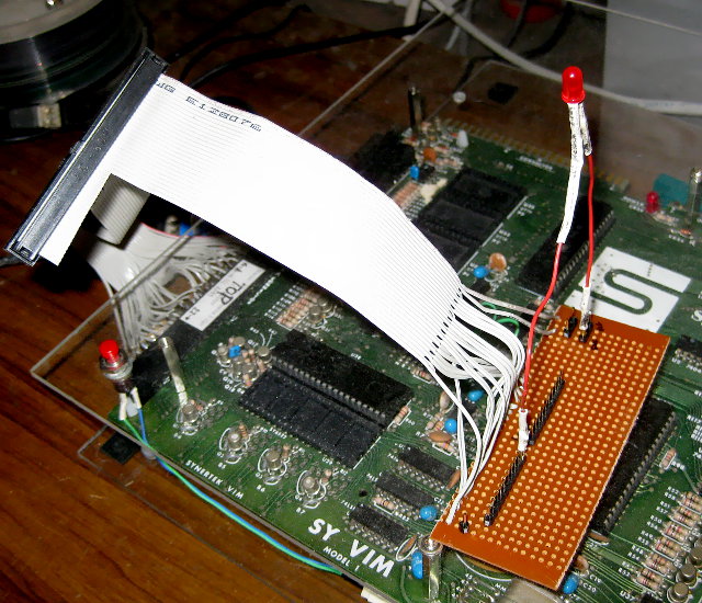

I hope to share with everyone something that allows a 6502-based system to use a bi-directional parallel port connection to a GNU/Linux system for terminal and file I/O, and several other features.
It was primarily written for the Synertek SYM-1 belonging to the 'local hackers club', to allow fast (~8kB/sec) program transfers during development, and to also provide a pseudo-terminal channel replacement for the none-too-reliable bitbanging 6522 serial port interface. (No dropped chracters at ~1400chars/sec. :)
To explain the protocol used, lets say I wanted to sync the Dallas DS1230Y Time-keeping nonvolatile RAM used on the 6502 system here with the system clock on the GNU/Linux box. The client might send through the handshaked parallel port, via calls to the PP Put_Char and Get_Char routines:

The current release supports PP commands for downloading files, uploading files, directory listings on the server, sending talk/ debugging strings, blockmode "sector" read and writing(*), and reading and writing to a pseudo-terminal channel.
(*: a friend wrote an operating system for my 6522IDE interface that used a real harddrive; it was straight-forward to patch its I/O vectors to use PP-- the advantage being no need for a seperate power supply for the drive, and all data is stored and more accessible on the server this way.)
The server software runs on GNU/Linux systems(*), using IOCTLs for parallel-port access, so I assume it is portable across hardware platforms (maybe even USB-parallel adapters?) No bloated frameworks or obfuscation was employed-- there's just the one plainly-written C program.

Am I right in thinking this is a 10-wire protocol? 8 data plus 2 handshake, run in half-duplex? I didn't manage to find a description of that, although I did find this picture: Image
Anyhow, it looks good to me, and I like the mentions of paper tape too.
