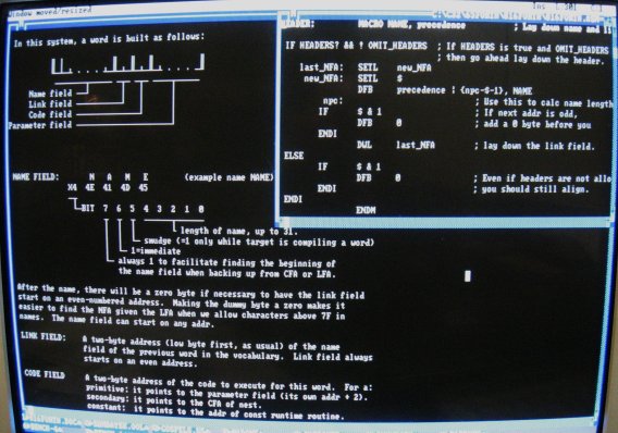

What are you guys using hardware and softwarewise to develop a 6502 OS?

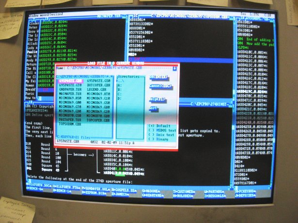

DOS on a 12-year-old (or so) computer, with a high-res monitor (132 columns by 43 or sometimes 60 lines, instead of the old 80x24). With the Multi-Edit programmer's text editor that runs under DOS, I've had as many as 32 files open at once, windowed and tiled in different ways.
Here you see parts of five files, plus the "Load new file" menu. It's all mouse-powered. There are lots of other files behind, and 16 more are minimized.
(Pardon the camera photos-- I don't think I have a screenshot function on the DOS computer.)
One of the many nice features is that it lets you draw diagrams as easily as CAD, using just the DOS/ANSI [Edit: that should say IBM437] characters above 80H, as you see a little bit of in the second picture. Since it's just a text file, these cause no problems with assemblers and compilers.

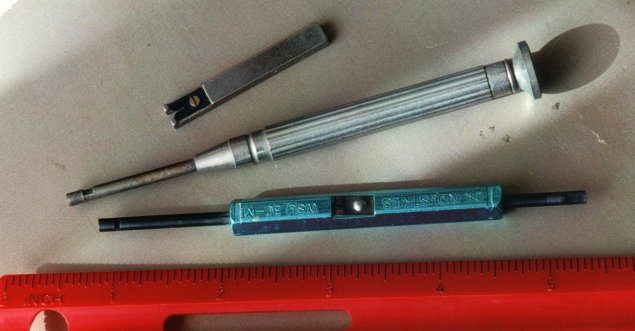

I use the blue OK Industries WSU-30M hand wire-wrap tool, the lower one in the picture below. It's about 4.5" long. It does a great job.

I did find a manual wire wrap gun for $100, and an unwrap tool for $20 from mcmaster.com.... Thanks for your help so far Garth. I'm at the point now where I need a good paycheck to order these parts, and I'll be at stage one of wiring. Time to start a new project thread soon on my engine monitor idea after I'm able to order the parts here in a few weeks.

Don't spend so much!!!!
A wrap/strip/unwrap tool from digikey is only $35
http://search.digikey.com/scripts/DkSea ... me=K104-ND
Search Ebay for a "TOP2049" programmer. They are less than $150, use a USB connection, and most likely can take multiple file types (raw object, Intel Hex, S records, etc)
You can also find a local electronics hobby/parts store that might carry the basic tools cheaper. Take some time and shop around, then you can put your money into the IC's and other components,
