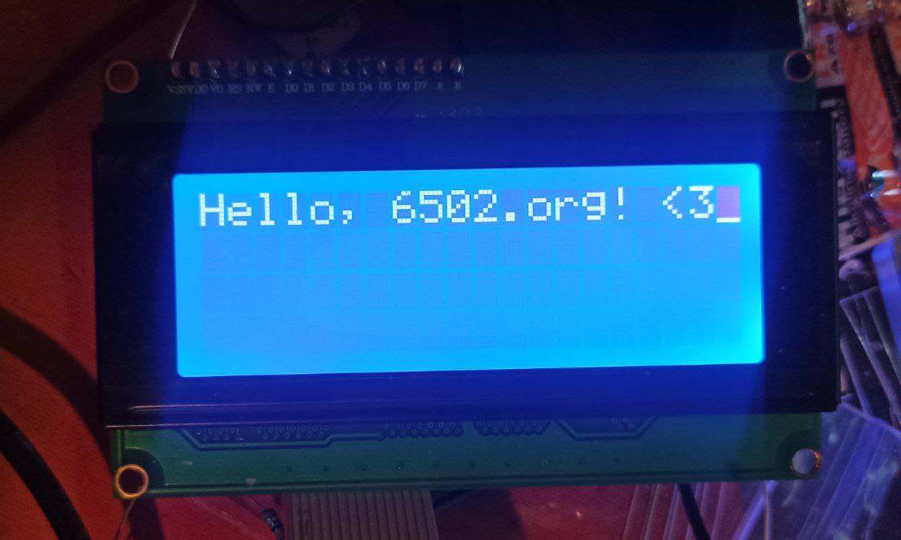

You are, in fact, producing actual characters, just not the ones you expect. Those symbols are part of the HD44780 character set. You're also getting the right number of characters. That's fairly encouraging! If I'm reading your post right, you're getting a *different* set of unexpected characters each time through your test code? That could be crosstalk on your data lines. But it also could be one of those annoyingly easy to make but hard to find programming errors. I mean, if you did a: instead of a: you would get whatever happens to be in RAM interpreted as character data.
and3rson wrote:
No matter what I tried, I couldn't produce any actual characters. The screen initializes, the cursor advances, but the garbage is always there.
lda 'B' ; ZP addressing mode - store the contents of memory location $0042 in the .A registerCode: Select all
lda #'B' ; immediate addressing mode - store the value $42 in the .A register"The key is not to let the hardware sense any fear." - Radical Brad

Garth - sorry, I totally forgot to commit my current code.
Here it is (it's almost a carbon copy from here: http://www.6502.org/mini-projects/optrexlcd/lcd.htm):

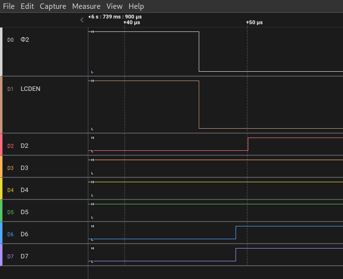

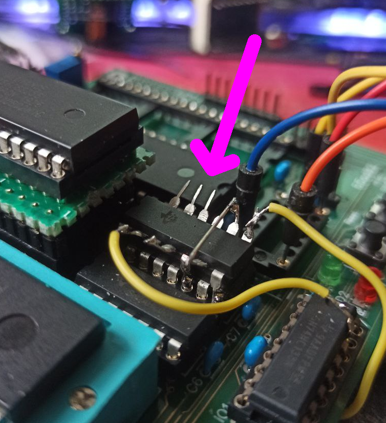

So now the only issue is that screen fails to initialize when I connect anything to Ф2. Additionally, if I touch Ф2 with a wire while characters are being printed, it starts printing blank chars until I release the wire. And sometimes, it just doesn't initialize at all (but DDRAM address still increases on prints). Weird!
I think I'll disassemble the whole "piggyback" thing and try to do proper soldering job on a separate daughterboard. I think those legs that I bent upwards could be the reason...
EDIT: Forgot to mention - different 2004 display behaves the same, so it's the problem with my board. Just as expected.
EDIT 2: I've just replaced the "piggyback" with a "daughterboard", and now the screen is constantly blank (since I needed to extend Ф2 to reach to the daughterboard). Oh well!

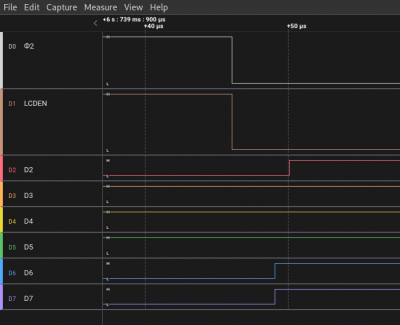

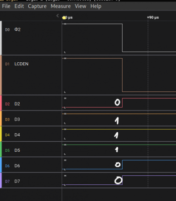

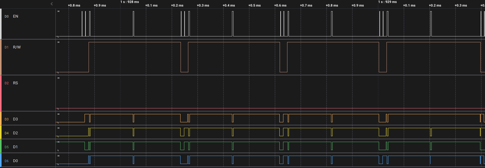

Here's "lda #%00111000; sta LCD0" (captured at 1KHz): (You can see 6 high bits of 00111000 - "8 bit, 2 lines, 5x8" initialization, and LCDEN correctly falls with Ф2.)

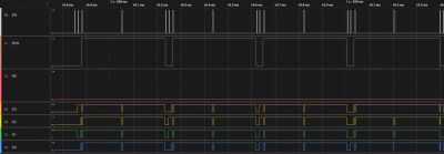

UPDATE: Turns out not! The above capture happens only part of the time. Here's the same place (writing 00111000 to LCD0) during a different capture (captured at 1KHz): For some reason, data becomes invalid at the same moment when Ф2 (and LCDEN) goes low. Also, sometimes LCDEN lags behind Ф2, and sometimes both Ф2 & LCDEN properly go low while data is valid.
I feel like Ф2 is lagging for some reason.
Here's my clock part for reference: "STEP" comes from DS1813, "CLK" comes from crystal generator (or from attiny45 if I'm going below 100 KHz).
EDIT: I guess I should try ditching PHI2O whatsoever and rely only on PHI2. It thought PHI2O was the one that's supposed to be used in synchronizing reads/writes/enables, and I trusted it, but it betrayed me!
Besides, WDC recommend not using PHI2O & PHI1O. However, I still thought PHI2O is the correct signal for synchronizations. The naming is really confusing!
Question: should other legacy chips (e. g. 6522 VIA) use PHI2 or PHI2O?

Re: [WORKING] Simple 6502 SBC from scratch (65ad02)
...so I've disconnected w65c02's pin 39 from the board and merged oscillator input (PHI2) with former PHI2O like so:
And then, this happened.
No more issues with Ф2 when probing, everything works just as expected! Tested with 500KHz, 2MHz is too fast and the screen stays blank. But for that I'll use my VIA, this is just for testing.

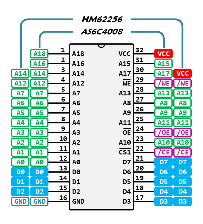

Couldn't you plug that 32K RAM directly into the 32-pin RAM socket (offset by 2 pins)? Is pin 30 connected to 5v VCC as in your schematic?
and3rson wrote:
Michael - that's a small DIP-28 to DIP-32 SRAM adapter, my AS6C1008 hasn't arrived yet, so I'm sticking to a 32Kx8 SRAM that I had.

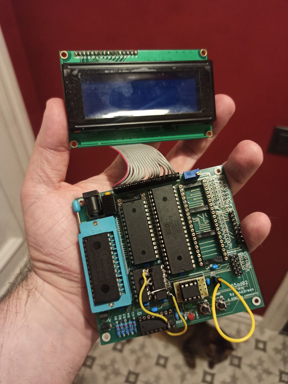

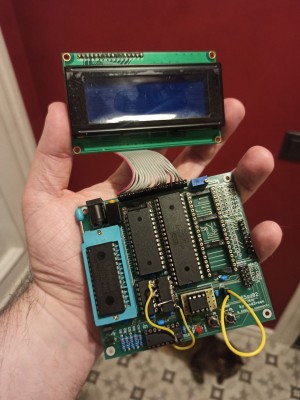

Here's what my current SBC with working LCD looks like. Turns out the NAND piggyback was not so bad after all.
/Andrew
and3rson wrote:
I've then rewired a low-active LCD/EN to to through this NAND [...] And this is where all the weird stuff started happening.
Experience has taught me that weird stuff and floating CMOS inputs are sometimes synonymous!

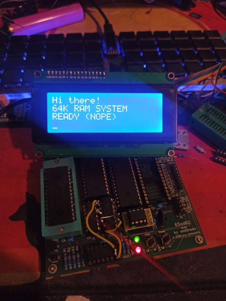

Considering how I bent the poor thing's legs, it surely must be in pain! But it's getting the job done right.
I've spent a ridiculous amount of time trying to make LCD work with VIA. The VIA is great, the problem is HD44780 being a total arse with its 4-bit mode timings and with the initialization sequence.
After going around in circles, probing my LCD for hours with a digital analyzer, and reflashing my EPROM like 300 times, I've finally made it work. Many examples on the internet send 8-bit initialization nibble before switching to 4-bit mode, I couldn't get it to work unless I changed all 4 writes to 4-bit init. It still doesn't work reliably - most of the time it doesn't init on power-on, requiring me to reset manually.
Logic analyzer was extremely helpful - It helped my find places where I accidentally left some VIA lines floating by setting them as input when they were supposed to output, and gave me a good vision of the "shape" of the signal as well as of all the timings. I wanted to have as little busy waiting as possible, so I actually implemented reading of busy flag via 4-bit line.
My LCD code is here (don't judge me to hard, I'm still very new to 6502 assembly): https://github.com/and3rson/65ad02/blob ... /src/lcd.s
It still contains a lot of busywaits for timing, but at least I've gotten the thing to work, and it's really fast - redrawing the entire screen takes less than 100ms. I think it can be improved since all my CPU delays are heavily padded. It also includes some nice tty-like screen scrolling, terminal style.
My old VIA-less code for 8-bit LCD operation is here: https://github.com/and3rson/65ad02/blob ... old/lcd2.s - but it doesn't work with clock speed >500 KHz.
As for now, my SBC is successfully running @ 4 MHz, LCD is working, interrupts are firing, and I still have two control lines & 9 I/O bits available in my VIA.
My next stop is bit-banging a PS/2 keyboard & interfacing with I2C devices.
