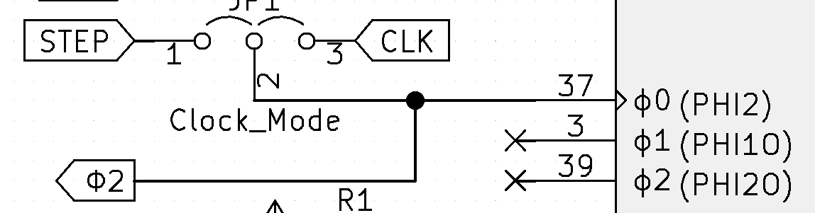

PostPosted: Sun Mar 05, 2023 7:49 pm
Posts: 163
Location: Lviv, Ukraine
I've double-checked the timings and could not find any anomalies there.
Here's "lda #%00111000; sta LCD0" (captured at 1KHz):
(You can see 6 high bits of 00111000 - "8 bit, 2 lines, 5x8" initialization, and LCDEN correctly falls with Ф2.)
UPDATE: Turns out not! The above capture happens only part of the time. Here's the same place (writing 00111000 to LCD0) during a different capture (captured at 1KHz):
For some reason, data becomes invalid at the same moment when Ф2 (and LCDEN) goes low. Also, sometimes LCDEN lags behind Ф2, and sometimes both Ф2 & LCDEN properly go low while data is valid.
I feel like Ф2 is lagging for some reason.
Here's my clock part for reference:
"STEP" comes from DS1813, "CLK" comes from crystal generator (or from attiny45 if I'm going below 100 KHz).
EDIT: I guess I should try ditching PHI2O whatsoever and rely only on PHI2. It thought PHI2O was the one that's supposed to be used in synchronizing reads/writes/enables, and I trusted it, but it betrayed me! :D
Besides, WDC recommend not using PHI2O & PHI1O. However, I still thought PHI2O is the correct signal for synchronizations. The naming is really confusing!
Question: should other legacy chips (e. g. 6522 VIA) use PHI2 or PHI2O?
/Andrew
PostPosted: Sun Mar 05, 2023 8:42 pm
Posts: 163
...so I've disconnected w65c02's pin 39 from the board and merged oscillator input (PHI2) with former PHI2O like so:
And then, this happened. :D
No more issues with Ф2 when probing, everything works just as expected! Tested with 500KHz, 2MHz is too fast and the screen stays blank. But for that I'll use my VIA, this is just for testing.
/Andrew
