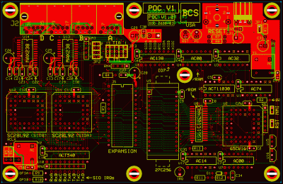

Re: Single 6522 for a few applications
Every device has a 0.1 uF bypass capacitor. Also, one is placed at the power connector to keep circuit noise from sneaking out the back door and causing RFI. Another is placed by a header that can be configured to power an external terminal adapter. That's why you see so many of them. Bypass capacitors are like money: no such thing as "too much."
http://sbc.bcstechnology.net/images/sbc_v1_page04.gif
At the bottom left corner, you have a BUNCH of capacitors all in a row. What you are implying is that there is one capacitor there for each component, and that it's placed at the VCC side of that component? You are not using some 20x capacitor array network or something?
For a first effort, I'd suggest you do it in two-layers to gain design skills with component placement and circuit routing.
The device's VCC pin should be connected by a short and relatively wide trace to the VCC side of the capacitor, and not directly to the inner power plane.
Hm! That is interesting, thank you for that tip. Hadn't heard that before.
BDD, thank you for that excellent and detailed response. Thank you for teaching me so much about this.
Chad
- BigDumbDinosaur
- Posts: 9425
- Joined: 28 May 2009

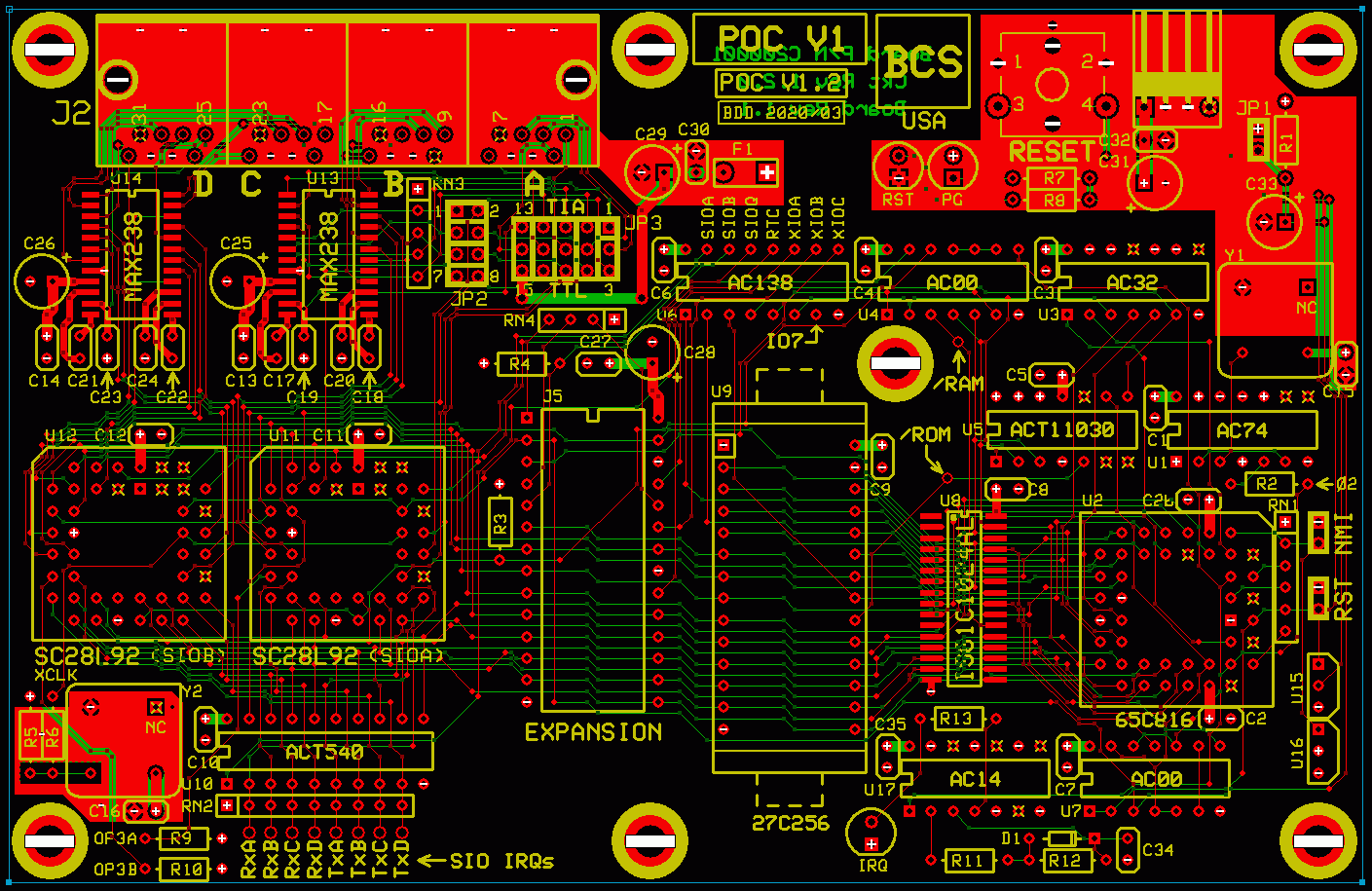

sburrow wrote:
So let me understand your schematic correctly then:
Each capacitor is a "stand-alone" part. It is essential that a bypass capacitor be as physically close as possible to the VCC pin of the device that it bypasses to minimize inductance. That can't be done with a capacitor array.
The schematic you were looking at is of the very first POC unit. In newer schematics, I "distribute" the bypass capacitors so they are on the same page as the devices they bypass. The below schematic of POC V1.2 illustrates this change. Also, most of the bypass capacitors have the same numeric designation as the corresponding device. So C5 bypasses U5.
The above also illustrates some "good practices" in drawing schematics. such as using logic symbols for gates instead of black boxes, using netlist symbols as a means to "bridge" circuits from page-to-page and not to connect things on the same page, and being reasonably concise in notations and component identifications. I try to draw my schematics in a way that would allow anyone skilled in the art to build the unit and get it running.
I've been thinking of a 2-layer design for a while. I don't know trace sizes very well, I know they are dependent on amps and all that, but there are numerous factors at play.
Signal traces can be quite narrow. I use 0.006" traces for signals. Power-handling traces are wider, of course. In a typical 65C02 computer design, nothing draws all that much current, so you don't need big, honkin' power-handling traces (more on this below). Take a look at the illustration for POC V1.2's PCB below to get some ideas.
Red traces are on top and green on the bottom. This is actually a four-layer board, and is stable at 20 MHz. It was the last unit I built with PDIP logic devices.
With that in mind, what if I were to make a 2-layer board, but knowing that I will connect all VCC and GND pins with wires on the bottom.
I would not do that. There's not any value in using actual wire for VCC and ground, and you may inadvertently create some significant problems by doing so. Do it all in traces and save yourself some later troubleshooting aggravation.
What is typically done on two-layer PCBs is to run the VCC and ground traces on opposite sides of the board. In my designs, I go north-south on top and east-west on the bottom, as seen in the above illustration (which, incidentally, has an amusing layout error in it). Traces are also run at angles on both sides as necessary to shorten signal paths and dodge obstacles, such as mounting holes.
After you approximately determine where you are going to place your chips you lay out a grid for VCC and ground so you don't have to run traces too far from each grid to the relevant pins on the chips. While doing that, also place your bypass capacitors to get them close in to the chips' VCC pins. I generally advise beginners to do the power and ground distribution first, since those will be wider traces and hence have somewhat-less routing "flexibility." Once power and ground have been distributed you can start "wiring" your circuits.
A good width for the VCC and ground grid traces is 0.050"-0.060". Here, size will matter, as you absolutely don't want any possibility of voltage drop in the power distribution grid. Although CMOS logic draws a minuscule amount of current when it's idle, significant draw occurs as output states change. With much of the system orchestrated by the Ø2 clock, many such state changes may simultaneously occur, with an attendant momentary and very-abrupt increase in power draw.
Where traces branch off the power distribution grid to individual chips you can use a trace width equal to or slightly smaller than the pad diameter to which it will connect. If the path has to change layers, use a via at least one size larger than the trace width.
Turning back to signal traces, I wouldn't go any larger than 0.010" width and if your PCB drafting software will allow it, go smaller. Doing so will make routing easier. Commensurate with the small size of signal traces, you use small via to transfer a circuit from one layer to the other. The current in signal traces is rarely more than a few mils, so you can go very small.
One other thing. Devices that are connected to each other should, if possible, be mounted next to each other. Initially allow plenty of space between devices. You can close it up once you've got a routing done. Needless to say, meticulousness is essential.
Hope this helps you a bit.
