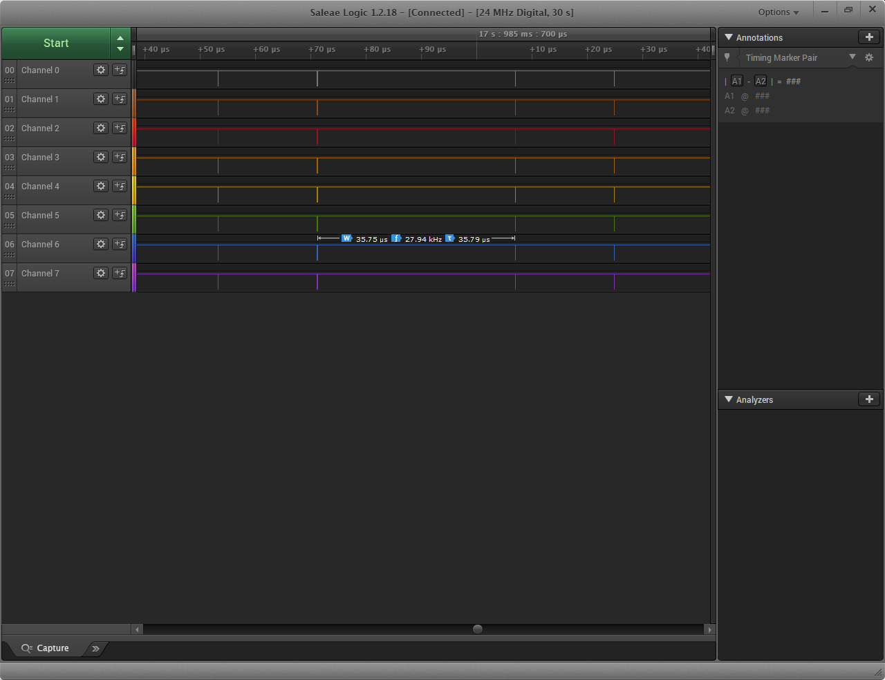

Time to work with the logic probe. I set up the eight channels so they capture then DATA BUS.
I did a "FILL 00:0200-00:7FFF with $FF value" and recorded the stream.
And it seems the memory chip is actually getting the data.
What I'm not that sure if the timing between pulses is right... Shouldn't be done in the timing of nanoseconds instead of microseconds?

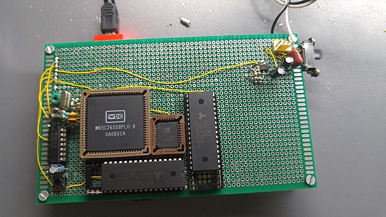

GOOD NEWS!!
I finally figured it out, with the help of Alliance Memory support team.
Maybe this is bread and butter for you, but I learned that with the AS6C1008, DIP version, CE2 must be tied to Vcc all the time, for the chip understand that it's being selected.
I left A15 and A16 tied to GND.
I also replaced the decopling capacitor from a 560nf to a 100nf one.
Chip select is tied to CS3B, as standard in the SXB.
I still haven't wired the EEPROM chip, BTW.

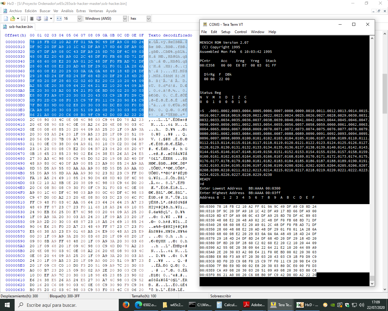

I can't make w65c265sxb hacker master run.
I followed the README.MD instrucions but I can't get the "welcome" message displayed in the terminal windows that I setup for the extra UART. I even wired a PL2303 as recommended, and get nothing displayed.
I tested that the memory is being properly written by uploading the program to the SBC, and then reading the memory locations it get copied to. And compared it to a binary compilation of the same program.
It seems the program is there. When I do "G 00:0300", the board sometimes resets, or get frozen, though.
tokafondo
Posts: 344
Joined: 11 Apr 2020
Re: My project with a w65c265s MCU.
Post by tokafondo »
More on this: I examined the .ASM and .INC files and found this variable, OSC_FREQ, set to 3686400.
I changed it to 4915200, that is the FCLK running my SBC.
I also found BAUD_RATE equ 9600, and that seemed to me not to be in the same line od the README.MD file, that says that the extra UART should be configured to 19200,8N1.
But again, this doesn't work. And the code is all there in RAM.
The checked in version (and the S28) is configured to take over the serial line from the monitor so I'd leave it at 9600. I just booted up my copy and it outputs this:
MENSCH ROM Version 2.07
 (C) Copyright 1995
Assembled Mon Feb  6 10:03:42 1995
PCntr     Acc    Xreg   Yreg   Stack
00:E358   00 00  E0 B7  00 FF  01 FF
  DirRg  F  DBk
  00 00  22 00
Status Reg
N  V  M  X  D  I  Z  C
0  0  1  0  0  0  1  0
>S  .0001.0002.0003.0004.0005.0006.0007.0008.0009.0010.0011.0012.0013.0014.0015.
0016.0017.0018.0019.0020.0021.0022.0023.0024.0025.0026.0027.0028.0029.0030.0031.
0032.0033.0034.0035.0036.0037.0038.0039.0040.0041.0042.0043.0044.0045.0046.0047.
0048.0049.0050.0051.0052.0053.0054.0055.0056.0057.0058.0059.0060.0061.0062.0063.
0064.0065.0066.0067.0068.0069.0070.0071.0072.0073.0074.0075.0076.0077.0078.0079.
0080.0081.0082.0083.0084.0085.0086.0087.0088.0089.0090.0091.0092.0093.0094.0095.
0096.0097.0098.0099.0100.0101.0102.0103.0104.0105.0106.0107.0108.0109.0110.0111.
0112.0113.0114.0115.0116.0117.0118.0119.0120.0121.0122.0123.0124.0125.0126.0127.
0128.0129.0130.0131.0132.0133.0134.0135.0136.0137.0138.0139.0140.0141.0142.0143.
0144.0145.0146.0147.0148.0149.0150.0151.0152.0153.0154.0155.0156.0157.0158.0159.
0160.0161.0162.0163.0164.0165.0166.0167.0168.0169.0170.0171.0172.0173.0174.0175.
0176.0177.0178.0179.0180.0181.0182.0183.0184.0185.0186.0187.0188.0189.0190.0191.
0192.0193.0194.0195.0196.0197.0198.0199.0200.0201.0202.0203.0204.0205.0206.0207.
0208.0209.0210.0211.0212.0213.0214.0215.0216.0217.0218.0219.0220.0221.0222.0223.
0224.0225.0226.0227.0228.0229.0230
READY
>g
Enter Address  BB:AAAA 00:0300
W65C265SXB-Hacker [18.06]
B bb           - Set memory bank
D ssss eeee    - Disassemble memory in current bank
E              - Erase ROM area
F 0-1          - Disable/Enable WDC ROM
H              - Hunt for RAM
G [xxxx]       - Run from bb:xxxx or invoke reset vector
M ssss eeee    - Display memory in current bank
R 0-3          - Select ROM bank 0-3
S...           - Process S19 record
W xxxx yy      - Set memory at xxxx to yy
X xxxx         - XMODEM receive to bb:xxxx
The only change to the source you should have to make is the OSC_FREQ setting.

The README.md needs some correction.
Originally the hacker tool communicated with UART0 at 19200 via a second serial connection but I later changed the code so its uses the connection indicated by the value of the UART symbol in w65c265sxb.asm at the BAUD_RATE define in the same area.
The checked in code uses the UART 3 at 9600 baud which is the same as the built in monitor.
I'll update the README.md to reflect this.
Its good to get confirmation that the '265 runs at higher speeds that 3.84MHz. I bought some '265s intending to build a board with an 8Mhz or higher oscillator. The monitor doesn't work above 6Mhz but it will still boot into a ROM if it finds the WDC signature.

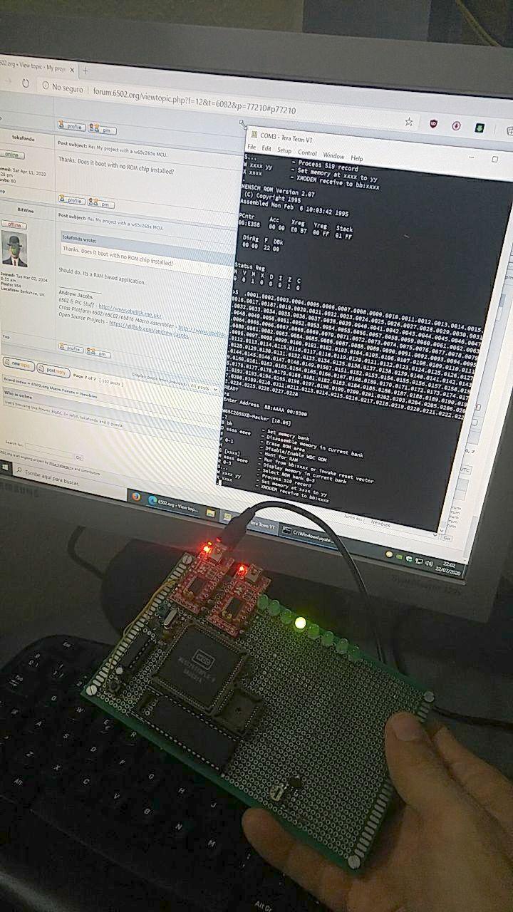

tokafondo
Posts: 344
Joined: 11 Apr 2020
Post by tokafondo »
It's ALIVE!!!!
 (C) Copyright 1995
  DirRg  F  DBk
  00 00  22 00
Status Reg
N  V  M  X  D  I  Z  C
0  0  1  0  0  0  1  0
0016.0017.0018?.0019.0020.0021.0022.0023.0024.0025.0026.0027.0028.0029.0030.0031
.0032.0033.0034.0035.0036.0037.0038.0039.0040.0041.0042.0043.0044.0045.0046.0047
.0048.0049.0050.0051.0052.0053.0054.0055.0056.0057.0058.0059.0060.0061.0062.0063
.0064.0065.0066.0067.0068.0069.0070.0071.0072.0073.0074.0075.0076.0077.0078.0079
.0080.0081.0082.0083.0084.0085.0086.0087.0088.0089.0090.0091.0092.0093.0094.0095
.0096.0097.0098.0099.0100.0101.0102.0103.0104.0105.0106.0107.0108.0109.0110.0111
.0112.0113.0114.0115.0116.0117.0118.0119.0120.0121.0122.0123.0124.0125.0126.0127
.0128.0129.0130.0131.0132.0133.0134.0135.0136.0137.0138.0139.0140.0141.0142.0143
.0144.0145.0146.0147.0148.0149.0150.0151.0152.0153.0154.0155.0156.0157.0158.0159
.0160.0161.0162.0163.0164.0165.0166.0167.0168.0169.0170.0171.0172.0173.0174.0175
.0176.0177.0178.0179.0180.0181.0182.0183.0184.0185.0186.0187.0188.0189.0190.0191
.0192.0193.0194.0195.0196.0197.0198.0199.0200.0201.0202.0203.0204.0205.0206.0207
.0208.0209.0210.0211.0212.0213.0214.0215.0216.0217.0218.0219.0220.0221.0222.0223
.0224.0225.0226.0227.0228
READY
>g
E              - Erase ROM area
H              - Hunt for RAM
.h
00:0000-00:7FFF

Well... I'm very happy because I finally got the board to use an external power supply. I originally used the SXB design, that get its power from the USB port. But now I put two voltage regulators. One from "more or less anything" down to 6V. And then, below that one, down to ~3.3v.
Why this? Because the graphic chip will use 1.5v, so I will take that from 6V instead of 3.3v, following recommendations that the input voltage should be >2V higher than the output voltage.
Also, I got installed a second 128K RAM chip.
