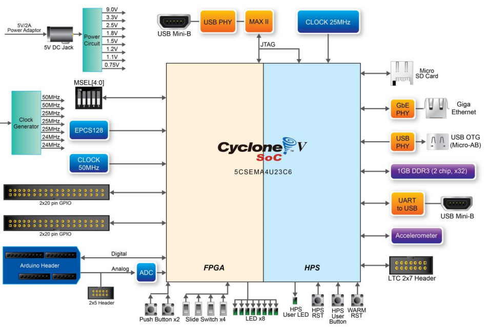

by BigEd
Terasic's £80 DE0-Nano-SOC is an interesting board - could be obsolete but is still available - it uses a chip with both an Altera FPGA and a dual-core ARM. There's 1G of DDR3 RAM. The FPGA has a massive 300kByte of on-chip RAM and is connected to the ARM by some kind of bridge to the standard AMBA bus. The ARM has USB and Ethernet.
At least 72 I/Os and several on board devices, although no VGA or HDMI. Also an Arduino-compatible set of connectors. All 3V3 unfortunately.
User manual: https://media.digikey.com/pdf/Data%20Sh ... SoC_UM.pdf
