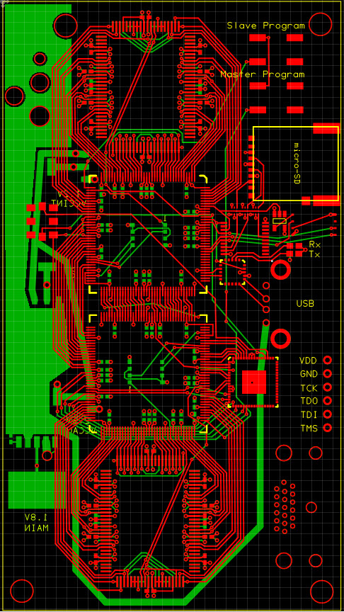

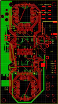

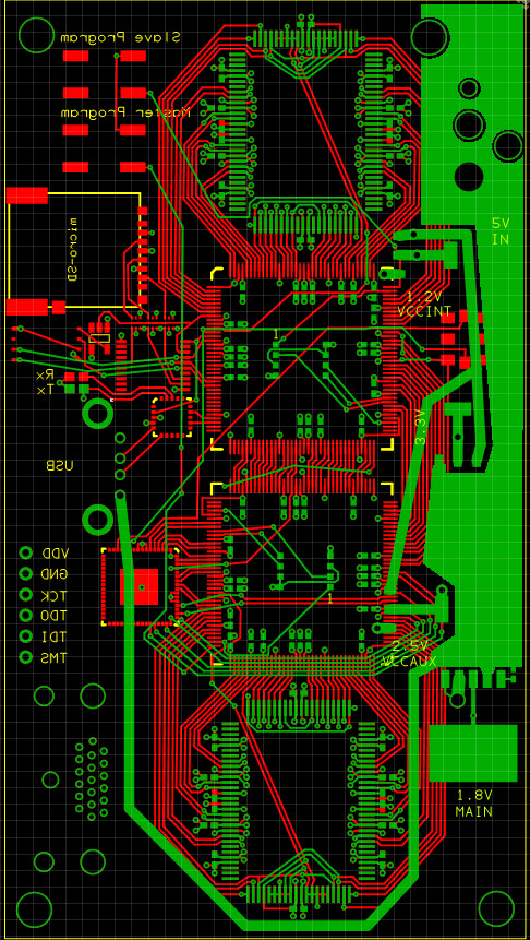

Update:
1) Finished all the IC footprints on the board.
2) Finished all the connector footprints, except the HDMI.
3) Finished the basic interconnects among the Major IC's, i.e. S6-S6 communication, 2x S6(s) to 4xRAM(s), I2C bus and SPI bus, 16-bit RGB to HDMI IC.
4) Finished the PS routing on the 2nd & 3rd layers for the 1.2V VCCINT and 2.5V VCCAUX. The 2nd layer is mostly 1.8V power plane and the 3rd layer is the GND plane. Top & bottom layers are signal, although the VREGs for 1.2V and 2.5V are mounted there too.
All I have left are the PWR/GND/caps for the HDMI transmitter, some small signals for the CH376 (FAT32 SD Card controller), 256Mb SPI FLASH (extra storage), etc... That's the easy stuff. The most difficult will be digging into the interconnects of JTAG programming the 2 S6's by use of SPI Flash's while using 1 JTAG connector.
Here's a small pic. Sorry had to post it, I know it doesn't mean alot to most.
EDIT: The 2nd plane is 1.8V not 3.3V.

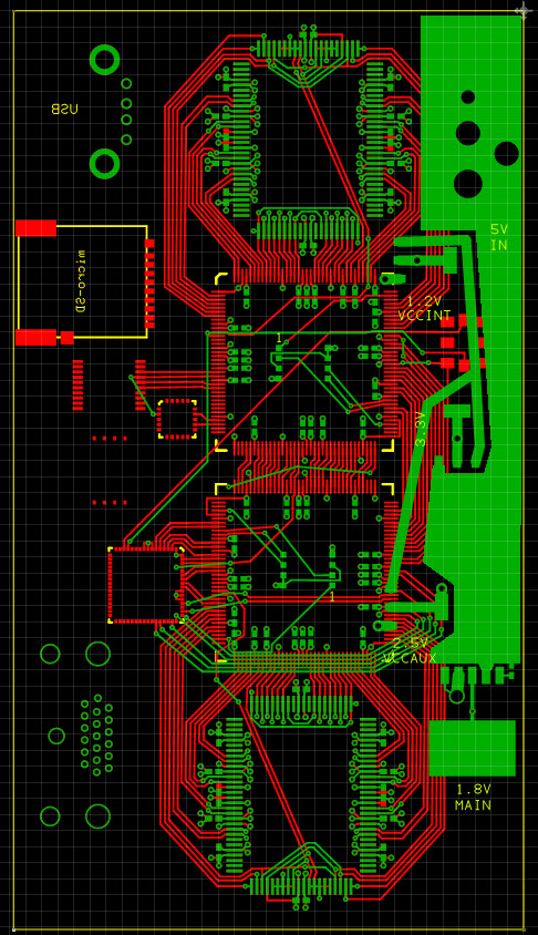

Was in a bit of a rush yesterday, here's the inner layers and how I decided to route VCCAUX and VCCINT. They're not power hungry, so I thought the .025" wide traces from the regulators would suffice. According to this site that should do 1.5A. Really nice calculator that is.
EDIT: Renamed VCCAUX plane.

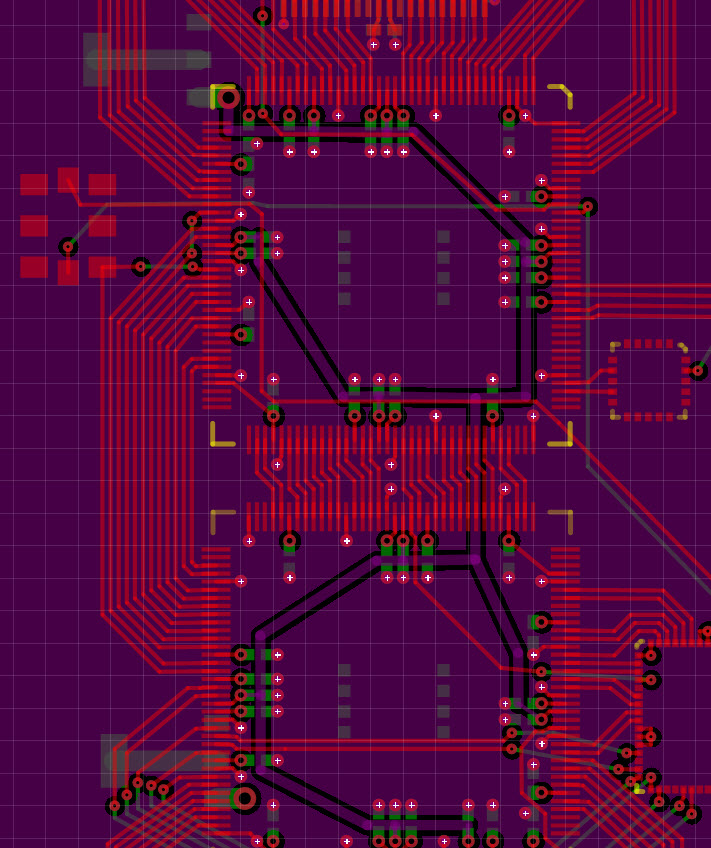

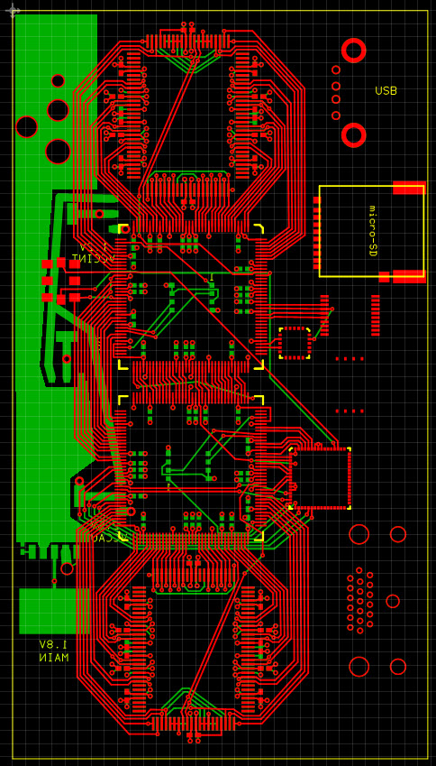

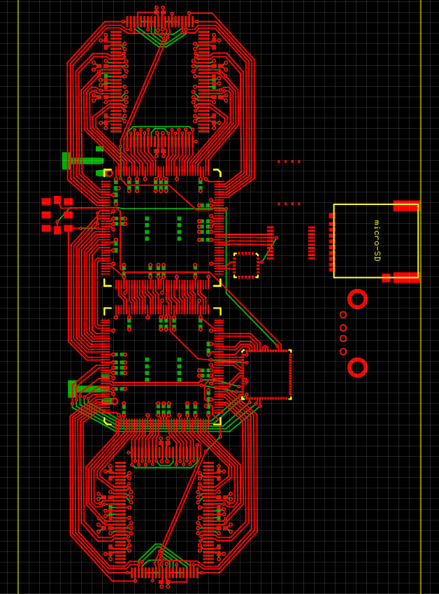

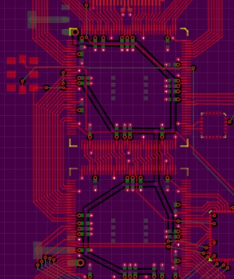

Been working on the layout just about everyday after work in silence for about 1 hr. I find it very relaxing and sometimes will find glaring mistakes from the previous day. This should decrease over time.
Making only slow progress each day, but it definitely feels like progress is being made, as opposed to '1 step forward, 2 steps backward'. This is a benefit of looking at the design everyday.
Update:
1) Finished most of the power/gnd planes and regulators. The only one left will be a separate 1.8V regulator for the HDMI IC.
2) Finished most of the connectors. I believe the only 1 left is the JTAG. Full size HDMI connector in there for sturdiness as is the USB.
3) Finished the FPGA SPI Flash interconnects.
4) Also, reduced the board size to 2.5" x 4.5"
Things to finish:
1) HDMI IC interconnect to HDMI connector
2) SPI bus to the 256Mb Flash storage IC
3) Bypass caps for secondary IC's, i.e. not SRAM or FPGA (they're done)
4) Add the level shift IC's for the CH376 to communicate with the SD Card
5) Add JTAG connector and figure out dual FPGA interconnect
Here's some pics from the top and bottom (flipped) You can see that there are indeed 4 SyncRAMs. Tricky stuff

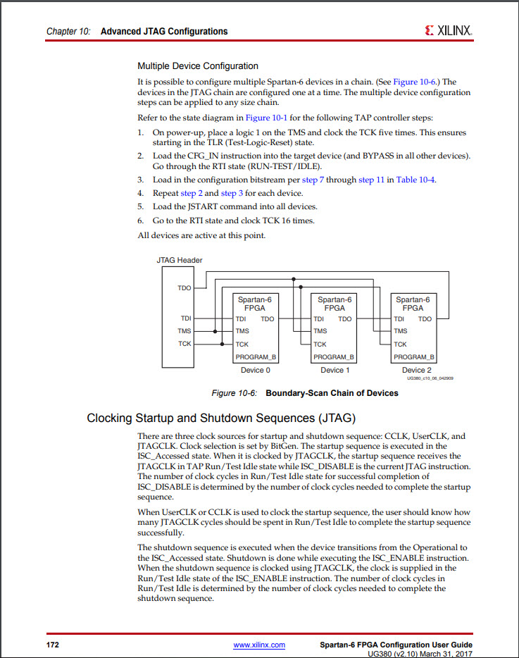

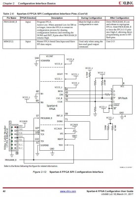

Here's the schematic from Xilinx UG380 regarding the SPI Flash. I added pin #'s for the 144-pin S6 I'm using and the SPI Flash mentioned in the parts list.
I've chosen not to use resistors in the CCLK path or the DOut from the Flash. But I think it would be wise to make provisions for them in the board layout.
However, the spec'd resistors will be used for both S6's - DONE, PROGRAM and INIT pins. Ignore the JTAG pin assignments for now.
ElEctric_EyE
- Posts: 3260
- Joined: 02 Mar 2009
- Location: OH, USA
Re: 65Org16 Assembler on custom Xilinx Spartan 6 FPGA Hardwa

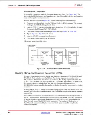

Since this is new to me, I'm not 100% sure this will work (maybe someone can chime in), but this is the way I'll hook up the JTAG pins in order to program each S6 separately. It's going to be abit awkward programming 2 different designs into separate S6's.
I guess I should program the Master S6 first and have it wait for a pattern over the comm bus from the slave. Once the slave is programmed and the slave CPU outputs this pattern, things start running.

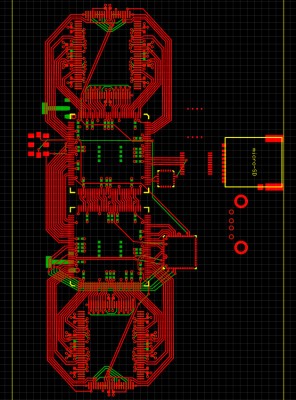

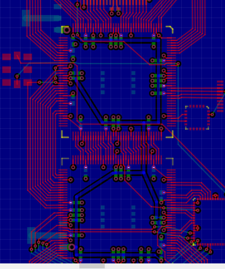

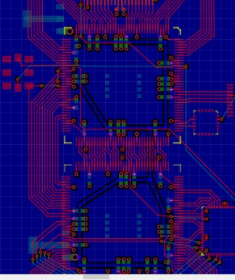

Came across a slight challenge doing the layout for the HDMI transmitter IC, the TDA19988. Has an unusual config on the bottom so no exposed vias allowed on the inside area underneath the package, except for the center square which is an exposed connection which must be connected to ground. Luckily not much will have to be redone, in fact I finished all of the rerouting of the vias to the outside perimeter of the IC pins without much problem. There are still plans to make a separate 1.8V dedicated regulator for the VDDanalog, VDDpll and VDDtx pins. Maybe find a real small regulator package just for these 6 pins. The other 1.8V power pins meant for the core and I/O will be connected to the common 1.8V power plane which is on the 2nd layer of the board. Progress! Goal is to be done before New Years.
- Attachments
- TDA19988_Bottom.jpg (911.07 KiB) Viewed 2910 times
