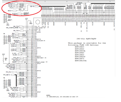

Have been absent from this (my major thread) for some time, due to "lack of a concrete plan". well, not entirely accurate; lack of a concrete "digital design" plan. The "scientific hypothesis" is still a novel one, and one that is in need of "reduction to practice". So, there is much "planning" behind it (and in front of it!).
https://en.wikipedia.org/wiki/Leaky_bucket ; immediately conjures up memories of Ricky Nelson's "My bucket's got a hole in it (it don't work no more")"! Ha! No, I 'm not old enough to have a valid excuse for knowing about that song, nevermind having it on "instant recall", in my brain!
Today, I'm looking at "the market" (mostly digi-key) to see what is available for dual port SRAM. (This is probably VERY late to be asking this question, but does the 6502/65xx/65816 etc. system REQUIRE Asynchronous RAM? Or is it just easier for beginners to understand? I probably won't gain much using Synchronous RAM, except the hassle of "bringing the clock with me" everywhere I go? Mightn't some DRAM serve my project well? Hassle of the multiplex, and refresh circuit, though? I find the video signals I want, and have designed, are very high data-load. I am not ENTIRELY un-knowledgeable about DSPs and the "1990s" IC advancement; but certainly I am unexperienced; high clock speeds and SMT devices discourage my gaining such experience.)
It is possible for me to investigate the FLEX Altera FPGA (PLD?) that the kodak/nat.sem. image sensors originally had placed on their development boards; but PLA, PAL, and FPGA might be more flexibility than I want or need. Regular old fashioned hardware design will be just fine, for me. It seems to me the video signals from the image sensors are routed to the FPGA (PLD? technically?), then altered, in some fashion, and then sent to the memory buffer board. Maybe I'll post the schematics, below.
I have a rough idea of what I want, and have sort of block-diagrammed it out, but by limiting myself to DIP packaging I can only find 8 or 16 KB of DP-RAM, per chip. For a 65816, that's alot of chips to fill the mem space! (1,000).
Barry Brey's "Intel microprocessor" textbook mentions "Shared Bus Architecture" (or some such acronym-inducing catch phrase), that had me briefly envisioning 5 or 10 QTY 65C02s fetching data from the dual-port RAM, (maybe doing a little bit of minimal computation?) and shuttling it to some "main memory" (DRAM? ASRAM/"fast"-RAM), and, maybe, even use a 65816 to do the main processing of this "main memory". Just a brief flutter of a thought.
Ideally, I would use the right tool for the job that must be done, but I'm afraid the bewildering plenty of IC design has left me to cobble together a solution that seems "accessible" to me. Hence, the 65xx (despite its "dinosaur", ancient attributes).

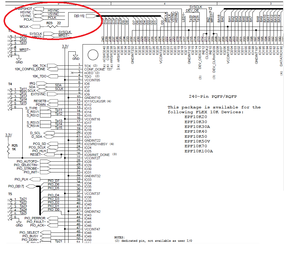

OK, enough babble, for today. Here is a schematic or two.
(Note, looking at the Dev-Board/Kodak schematic, I note something I missed before. The PLD handles the sysclk (generated by crystal) and makes?/passes-on? the mclk that runs the sensors; mclk, from the KAC9628 documents is the generator of the pclk and vsynch and hsynch; so, its important. )

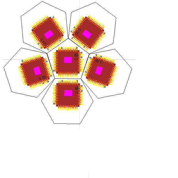

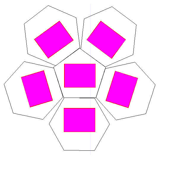

- Attachments
- Note: I had thought of "liberating" the dies from their enclosures, with the help of some HF in the form of wither household oven cleaner or glass etch cream, but was not very confident that I could do so "non-destructively". It remains a possibility. Also note, this schematic has me ignoring the non-active area of the die, to squish the active areas in closer. This is a mistake... a brain fart. In reality, though, I would probably use something other than the sensors I have, something with 100% fill factor. Probably, CCD technology. Coulda, woulda, shoulda!
- MCM Ideal All Hexagons Except 1.PNG (11.47 KiB) Viewed 1531 times
- Note, center of active areas should be the center of the hexagon, for, when the PCBs are "folded up", oragami style, only the centers will lie exactly on the focal surface of a non-petzval/coddington corrected lens, and thus, more peripheral pixels will suffer some degree of defocus, due to depth of focus (not to be confused with depth of field). EXPERT lens design MIGHT (I stress might!) minimize this concern.

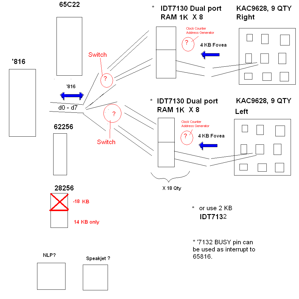

Re: An actual project for a newbie biologist

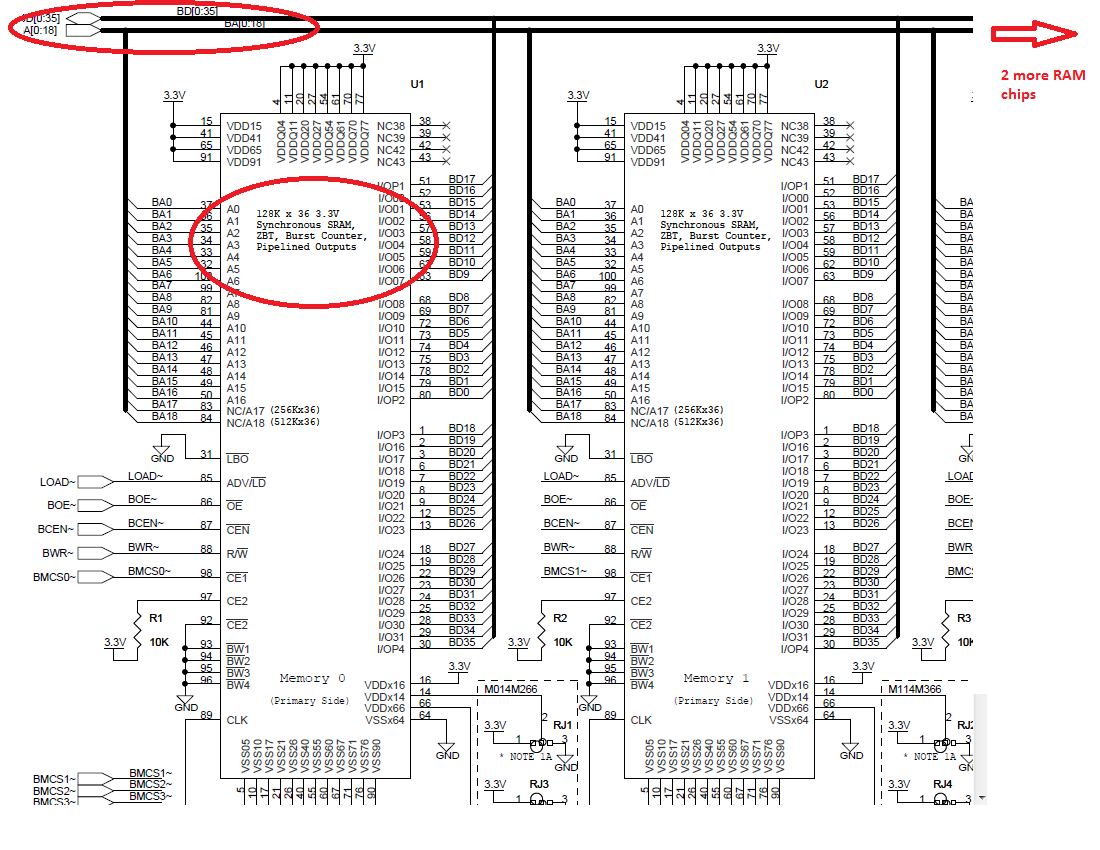

Whoops, I mispoke/mis-wrote. 1KB DP-SRAM, or 2KB DP-SRAM. So, 8,000 or so DIP chips would fill a 16 MB mem space of a 65816. Too much! No matter. I must find another solution. Maybe bend out a gull-wing IC, like I have seen on this website somewhere?
Also, here is the loosely reconfigured schematic I have devised. It is a mess, no doubt, but more creative and interesting than my first plan, and probably closer to the "right answer" that my project needs.
There is no getting around it, though. I am going to have to get very specialized about digital video signals. It wouldn't hurt for me to get familiar with HD TV specs (though I can't even AFFORD an HDTV, nevermind study one; nevermind the BOOKS to study one!), but definitely, I should start with the VGA standard (as that is what my sensors use). Pins and signals of VGA should be known, backwards and forwards, before I proceed.
The KAC9628 pdf mentions "digital image processor" and/or "digital video processor"; I have searched a bit, online, but I think, more commonly, in actual practice, that PLDs/FPGAs and/or DSPs do the work that the KAC9628 pdf refers to.

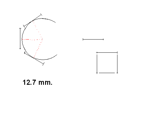

- Attachments
- Ok, again, I could have done more math here; and more exact, precise and accurate math, too! But I didn't. A bit lazy. But you get the picture, here. Sensors' active areas must have their centers lying on the focal surface. Some "dithering" might occur, with some fairly easy math; three options present themselves. (1) centers of active areas on the focal surface. (2) periphery of active areas lie on the focal surface. (3) the best method, some "averaged mid-point" lies on the focal surface, with periphery and centers of active area somewhat equal in their "unfocussed-ness". Simple math, mostly. Arcs, and chords, and angles and such!
- 9628 kodak times 9 plus coddington curvature.png (3.73 KiB) Viewed 1530 times
So, in explaining my new tentative block diagram, I will mostly leave much to the imagination. The plan, roughly, is to rob a bit of ROM mem space (i.e. change the decoder circuit) and also, to only allow the 65816 to access half of a DP-SRAM at a time. The other half is dedicated to the KAC9628 image sensor. Some sort of counter should count clock cycles of the KAC9628, as it is constantly writing, and, at some set point, logic would flip the "65xx read-write" area with the "image sensor, constant-write") area.
There are some other aspects of memory that I should research, and I really must stop "writing" today, myself, and do much more "reading". Funny that me and memory chips should have so much in common (constantly reading and writing!).
Specific topics I am investigating are (1) burst memory (whatever that means; it sounds good though! burst = fast, right?), and (2) Page read and/or page write.
With regard to the latter, my naive and uninformed mind, thinks that if one command can "flush" or "dump" large segments of the memory (fast-RAM; i.e. Asynch. SRAM), automatically, with high speed, to some other memory element (like a high capacity DRAM or other), with minimal time lost to the microprocessor, then that would be good!
I know I said I was studying DMA, but I am not sure that DMA, strictly speaking, does what I want it to do. Also, I am not sure what sort of DMA controllers are out there, beside the 8237, which, it appears, has limited availability outside the "ebay"/computer-historian collectors/high-volume applications/OE manufacturers markets. I don't know for sure. I'll bet there are better, non-proprietary solutions out there! I just don't know what they are.
Cheers (I run at the mouth again, so, there is only one thing for it. STOP WRITING AND START READING!).

Oh yeah; "4KB fovea" in diagram, I think, must be a typo? Don't know what I meant there? the 18QTY refers to having one DIP DP-SRAM for each VGA image sensor, for the 18 sensors of both "robotic eyes". Tentative plan, needs a better memory and lens and bus structure.
For the amounts of data you're talking about, I think you're going to have to learn about DRAM controllers and DMA. SRAM is wonderfully easy to use but cost-prohibitive for that quantity of data. Next, what will you do with all that data? If it's a challenge just to move it into memory as fast as you gather it, how will you actually process and do something meaningful with it at that rate? Or do you want to only gather it for a few seconds and then stop and have time to do something with it?
If I understand it correctly, part of it is that you give it an address, then transfer a byte or word with every clock cycle or even every clock edge, for the length of the burst. The RAM increments the address internally; so it's not truly random-access like the 6502/816 needs when it's jumping back and forth from op codes to data-memory accesses (with reads and writes mixed) or may dwell on the same byte for two clock cycles in a row in some cases.
As you said, SDRAM works best in combination with a cache.
