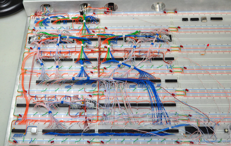

The new 640 x 480 x 4096 VGA Generator is now on the large board and working!
Both buffers are connected, and the 60 line IO switch is doing its job nicely.
Here is the state of the board now. A lot of wiring is not routed nicely yet, so please excuse the mess!...
Dual Buffers, Sync Generator, and the Video Memory Switch.

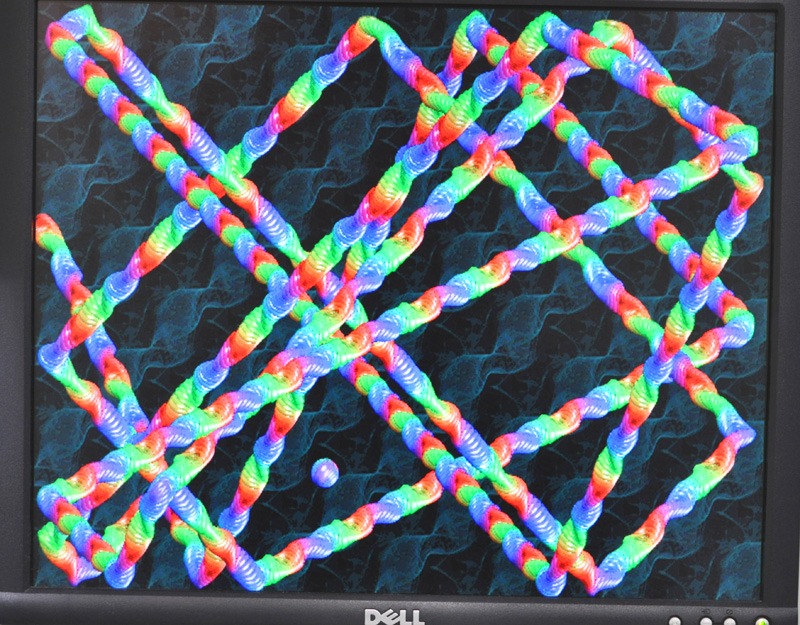

This proves out the new design, so now I can start work on the new Graphics Generator.
As a test, I made a basic demo that rotates and changes the color of a moving torus.
It uses the torus as a "brush" to paint lines that look like twisted rainbow strings.
I call this effect "String Theory"...
Everything looks good with 4096 colors and high resolution.
Here is a video of the demo drawing the string...
https://www.youtube.com/watch?v=vo0ra2RL-T4
The demo is only a few lines of assembly, and limited since graphics are stored in the small uC memory.
Once I have 4 Megs of Graphics Memory installed along with the Blitter, the power will be endless!
My next mod will be a few ICs to offer multiple video modes (8 new modes).
A smaller screen resolution mode such as 320x480 might be good for faster demo effects.
Here are some of the modes that will be available (all have 4096 colors)...
640x480, 640x240, 640x160, 640x120
320x480, 320x240, 320x160, 320x120
160x480, 160x240, 160x160, 160,120
And yes, like the Amiga, the vertical mode can be switched on the fly for multiple modes per screen.
So far, so good!

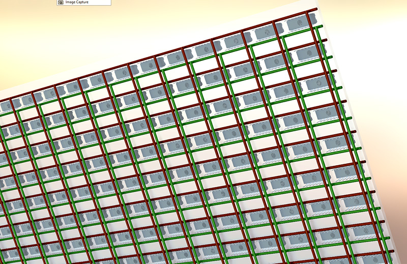

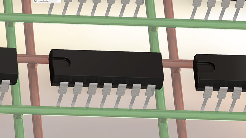

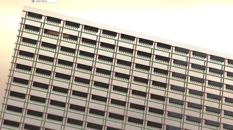

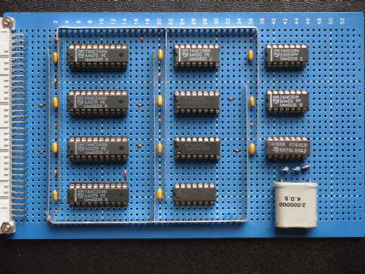

Having hit the razor's edge when it comes to what can be done on a breadboard now, I have started to consider my PCB options.
I want something as hand-made as possible, so I am exploring some really bizarre possibilities here....
Option One - Just get a real PCB made.
Expensive (need a 16" x 16" board), and not so cool.
Performance will be good.
Option Two - Point to Point on perforated board.
This will be a fun amount of work, and look cool.
The problem is with debugging and chip replacement.
Option Three - CNC routed massive PCB
At work, I have access to some nice 5 axis CNC equipment.
This would be a cool DIY approach, and performance would be good.
Option Four - Hand wired clear PCB!
Yeah... I like this one since it is both difficult and unique.
This one needs a bit more explanation...
The idea is to take a large piece of 3/16" clear Lexan and hand drill all of the holes.
Once all 50 million holes are drilled, IC are placed onto the board.
The VCC and GND leads would then be slightly bent towards sets of copper rails.
Copper VCC and GND rails would be made by straightening stripped house wire for the copper.
These rails would also be soldered into a crossing pattern to form a huge GND and VCC matrix.
Clock lines would be routed on the bottom as well, and all buss wires on the top.
I think this would be the best design for combating capacitance as well as ground bounce.
My poor breadboard is taking on a lot of capacitance right now, so this issue is on my mind.
Here are some SolidWorks renders of what I am considering for my board...
There would be two clear boards, each with 150+ ICs.
The GND and VCC Matrix would be very extensive, crossing every single IC.
ICs are soldered directly to the huge GND and VCC Matrix.
Wiring would by tidy, and ICs could be easily replaced if required.
The Power Matrix is #12 AWG copper wire (house wire)
I am going to make two boards - one for Video and one for Sound.
This works out nicely since both have about 150 ICs.
The bus between them is just 10 or so wires (8 bit data, and control).
This board design should be highly immune to ground bounce, and other issues.
Unless I have shocked myself too many times, this may be "better" than a standard PCB.
Adding decoupling caps would also be easy with the large copper bars.
I have some time to consider my board though, as my GFX Generator is not even built yet.
Brad
Brad

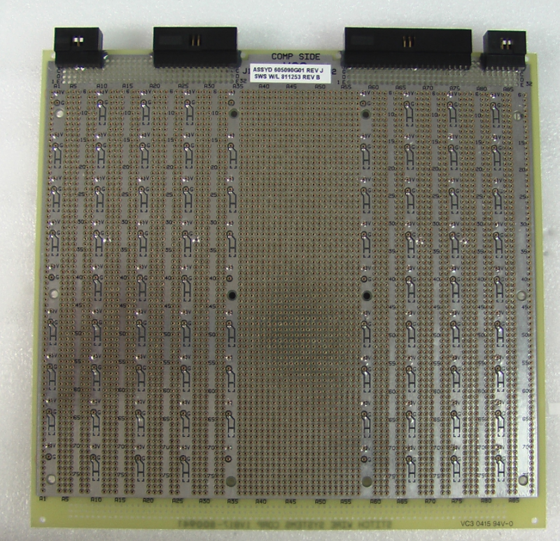

Wire-wrap works well for these reasons:
There are pre-made solder-type breadboards available that already have power and ground strips going down between the ICs' rows of pins, like:
All these boards are pretty expensive, but cheaper than a raft of solderless breadboards. The latter set is intended to be soldered, not wire-wrapped.
If you do your own bus wire, note that the wire size has very little effect on inductance, only resistance which is pretty minimal for CMOS circuits without going to 12 AWG wire. #24 or 26 should be easier to build with, and the performance should be indistinguishable with such a nice grid of them.
If you use a 3/16"-thick clear board like plexiglass, the pins on most ICs and soldertail sockets won't be long enough to get through the holes.
- You can get the sockets shoulder-to-shoulder, so everything is closer together and connections are shorter.
- You can get power and ground planes on the perfboards, like Twin Industries' 8100-series boards with one plane or their 8200-series boards with a plane on each side. You would solder a short connection from each ground pin to the ground plane around it and a chip capacitor from each power pin to the ground plane around it (that's the easy part), and if you have a power plane too (here comes the harder part), you put a strand of wire through the hole before putting the socket in, and solder the top of it to the power plane around it. The bottom of the wire can be cut flush with the board. Solder the socket pin into the thru-plated hole.
- You won't be breaking previously placed wires by moving them to access pin to solder to, since the wires just get wrapped, not soldered.
- You won't get the capacitance between strips that you're getting on solderless breadboards.
- Modification is not too difficult (unlike a PCB or soldered wires).
- Vector's 4616 6U VME size,
- or their 4615 (same size),
- or this one from Vero,
- or this bigger 6U-VME-sized one,
- or this smaller one from Twin Industries.

I have tried to make a photo of an old pcb I still have: The arrow points to a copper trace (its running inside this blue coat) coming from left then turn upward, OVERcrossing two other copper traces then UNDERcrossing a third trace!
I can't remember how many "copper trace layers" on (each) side of the pcb were allowed. But AFAIR there was never a routing problem.
Sadly this service died down in the 90s. Our supplier vanishes 5 or so years later. Google says this technology is now covered by Hitachi.
