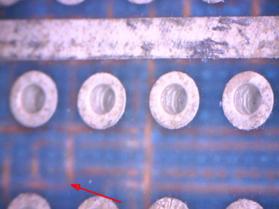

Hmm, there once (1980..90) was something you are looking for. It was/is called "multiwire pcb". The "wires" were printed onto the pcb, perhaps similar than inkjets work. Not really cheap, but for small series or prototyping really handy - you only had to define the pcb size and the placement of the chips and a netlist. You could do some additional (conventional) pcb-wiring if neccessary (e.g. a logo or some powerlines).
I have tried to make a photo of an old pcb I still have:
The arrow points to a copper trace (its running inside this blue coat) coming from left then turn upward, OVERcrossing two other copper traces then UNDERcrossing a third trace!
I can't remember how many "copper trace layers" on (each) side of the pcb were allowed. But AFAIR there was never a routing problem.
Sadly this service died down in the 90s. Our supplier vanishes 5 or so years later. Google says this technology is now covered by Hitachi.
