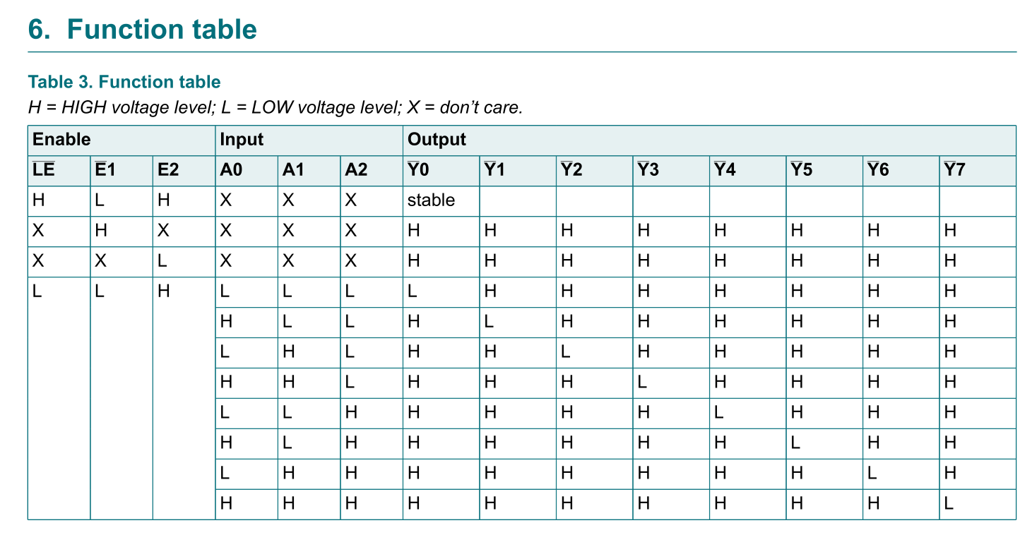

'137 is a latching decoder - like a '138 but with a latching input.
As I read the sheet, if I feed it with the address low bits, it gives a valid decoded output as long as RnW/~latch is low; when it goes high, it latches. It doesn't care whether it's a read or a write; it's not using the databus at all. But it will select the desired digit and key column depending on the address read. At the same time it can return the keycode value.
So the first write sets the LED pattern, then the key value is read at the same time as setting the column. Assuming I use the same decoded address for column and keycode, of course.
The other way around shares the pattern address with the keycode but requires a separate write and then read.

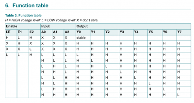

Ah, I'm looking at the wrong datasheet again. I now vaguely recall looking for one of those for something or other, but giving it over because I was looking for a faster propagation time.
But the output is LED's, so 17ns-24ns propagation delays are not an issue.

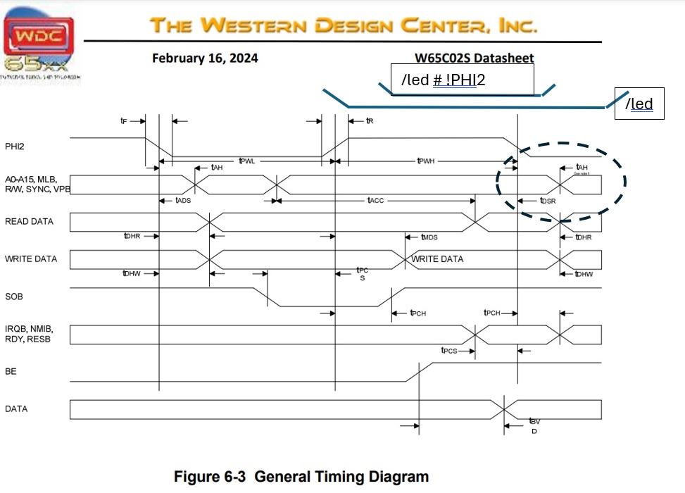

The question is whether valid data from the address bus is latched after LE rises, as opposed to address lines on the move.
Is the critical value there the An to /LE Hold time of 5ns?
[Edit: looking at a datasheet from a different maker seems to confirm that's the critical value.]
In any event, the active low selection signal to the '137 has to be qualified by PHI2, similar to the octal latch for the segment data.
... As I read the sheet, if I feed it with the address low bits, it gives a valid decoded output as long as RnW/~latch is low; when it goes high, it latches. It doesn't care whether it's a read or a write; it's not using the databus at all. But it will select the desired digit and key column depending on the address read. At the same time it can return the keycode value.
Yes, that would be the idea.
Just like the segment data latch, it also seems like it must be qualified by PHI2.
The reason is the address decode is going to be rising because of the changing address lines, while the "data" being latched are also address lines, which will be arbitrarily changing due to the address of the next instruction to read.
So the desire is to have the /LE line rise during the 65C02 address hold time following the drop of Phi2.
And the select is propagating through several decoders, while the addresses being decode are effectively lag-free, so the likelihood of latching in the wrong address bus state without PHI2 qualification seems quite high.
In any event:
  • Both the segment code latch and the latch side of the encoder are latches being integrated into a 65xx bus;
  • so it would be prudent to qualify them with PHI2 with a single propagation delay to CLK or /LE.
  • There is no functional advantage to separating them.
And two gates of a quad 2-input NAND gate would suffice, the first to invert the address select, the second to form !( !/led & PHI2).

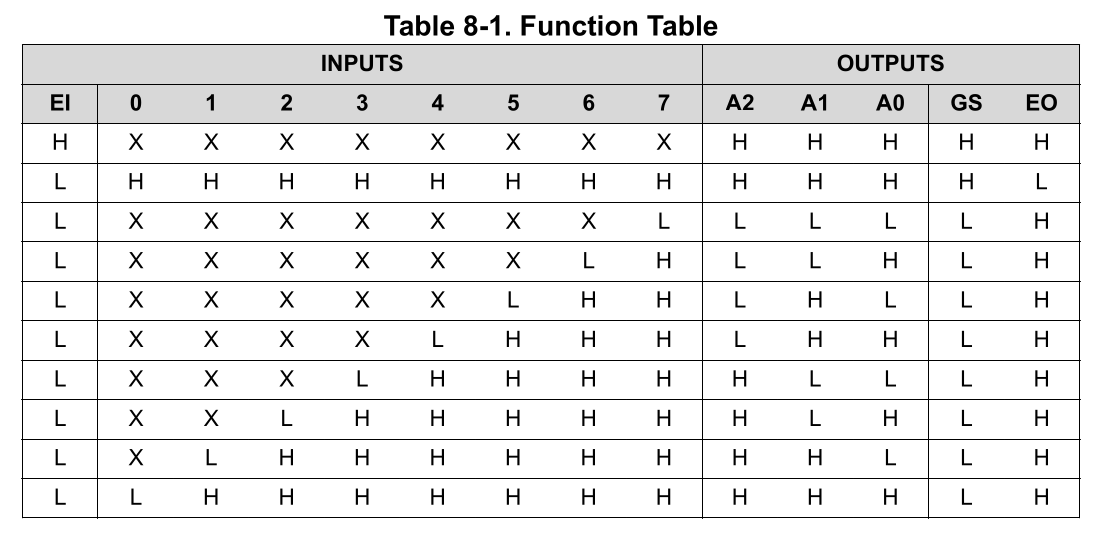

Aha! 74hc148 priority encoder for the keypad interface... I thought they disappeared years ago.
So using this I can drop the inverters from the column address and lose the discrete encoding logic, saving two chips on the board. The output is three bits of binary saying which row has had a key pressed, and GS which goes high when a key is not pressed (or EO which does the opposite, but using GS as bit seven means that there is no need for an AND).
Modified circuit diagram to follow...

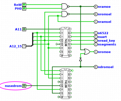

The address decode is undergoing alterations...

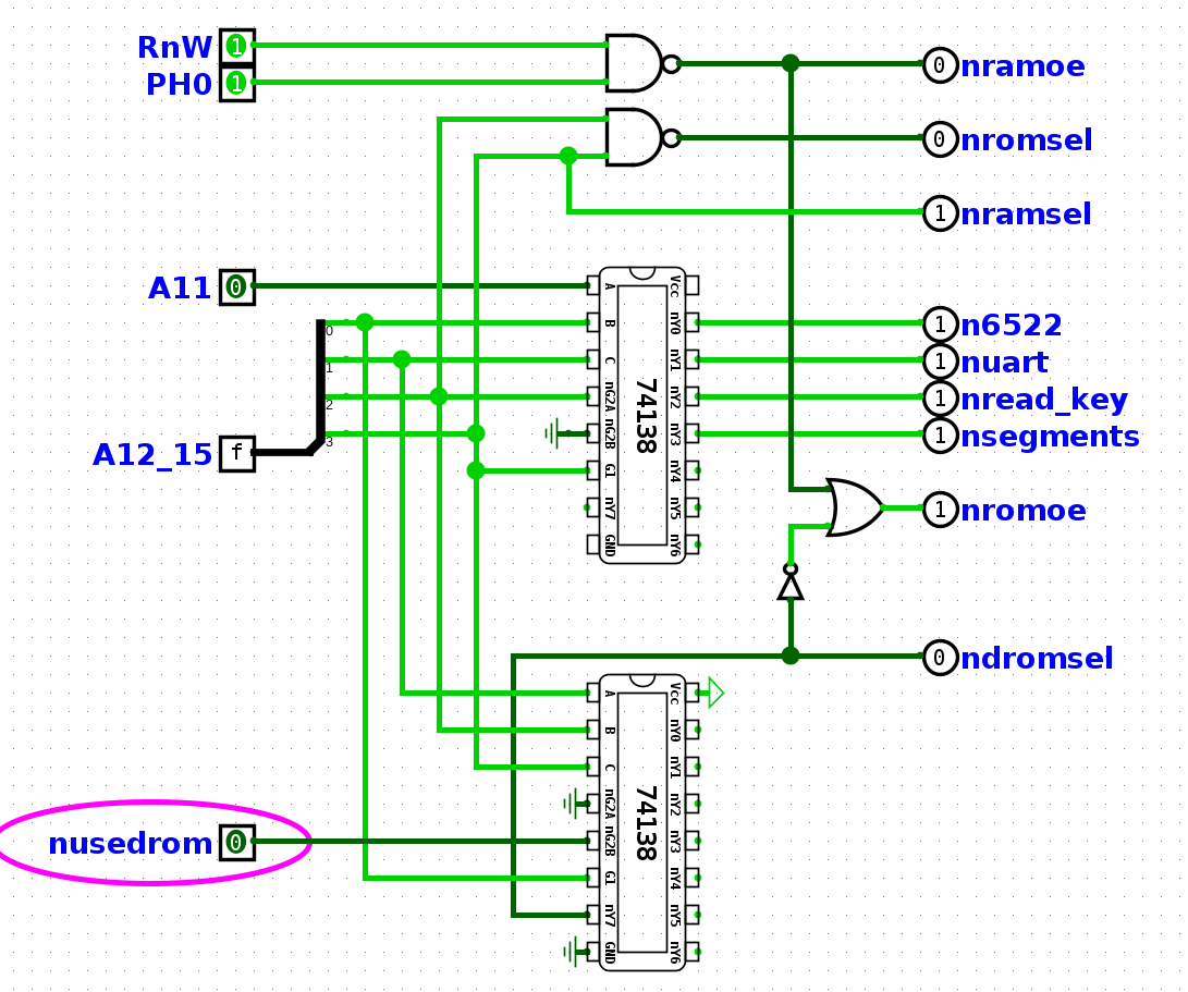

I did have one thought on the question of whether a NAND should be fast or slow.
I abbreviate the Schmitt-Trigger NAND that is contained in the reset debounce circuit in Garth's compilation NANDST, because being a Schmitt Trigger part, it will be touch slower. But if multiple NAND's are at hand, an HC process NANDST might be used to be deliberately slower to have a longer hold on /ramoe. There is no harm to the /Reset inversion in the debounce circuit to having a typical 18ns, as the debounce process should be in the ms range.
I spilled plenty of ink above about the first NAND in the qualified LED select ladder not being on the critical path, so that could also be an 'HC132 gate, so that would be 3 gates of the slower NANDST in use.
Under the revised Paleolithic keyboard, you don't need the gates to split the $9000 select between $9000 and $9001, that reduces the selection circuit to one OR at /romoe, which has an inverted line from ndromsel and a direct line from /ramoe.
Am I right that you can flip both inputs -- switch the ndromsel to a direct line and invert the /ramoe -- and that can be a NAND? I am assuming that the inverter shown is a NAND. Those should be fast NAND's, so that would make:
/romsel <= NAND(???,???) whatever it is already, I can't make head or tail of it as it seems to be fed by two input lines into two different decoders.
/romeo <= NAND(/DECODE8_Y7,NAND(/ramoe,Logic1))
Which I think would leave the fourth fast NAND gate available for the second stage of the /leds select line and eliminate the quad OR IC.
That leaves led_addr on $8000 and keys on $9000, so no need to qualify led_addr on R/W ... simply don't bother ever reading it.
/segment_latch_CLK <= NAND(PHI2,NANDST(/leds,Logic1))
/decode_rows_LE <= NAND(PHI2,NANDST(/leds,Logic1))
Put the savings from that OR IC into the debounce fund to get an LS19-P to debounce those five key switch lines. I don't know if they are available Q1 anywhere, but I saw a source that had them $2.89 Q10 (so probably $30+ with shipping) [Edit: and Digikey will source them from Logi Switch Q1 at $3.89 plus $5.25 flat rate shipping, 5wks order, so $20 shipped for an order of 4.]. It would save some space over debouncing all five key switch lines. Indeed, since it's a 6 circuit part and you have 5 key switch lines to debounce, the final one could debounce the reset button ... if replacing the simplest /Reset debounce Garth shows, I think it simplifies it down to a NAND to invert, and wiring the switch the other polarity would eliminate that gate entirely (since the Logi Switch debounce works in both directions).
My final note on the selection circuit is to ask whether /keyssel /6522sel and /uartsel are redundant. First, instead of qualifying /keys by R/W, it could be converted into a joint low/high select, compatible with sharing a space with CIA's, by inverting A05 and taking it into one of the /OE# of the bus driver. Then A06 and up high (individually) as VIA's and IC's with similar joint active low / active high selects, so:
        %10010000.001xxxxx  =  $9020: keys
        %10010000.010xxxxx  =  $9040: VIA#1;
        %10010000.100xxxxx  =  $9080: VIA#2;
        %10010001.000xxxxx  =  $9100: VIA#3;
        %10010010.000xxxxx  =  $9200: VIA#4;
        %10010100.000xxxxx  =  $9400: VIA#5;
        %10011000.000xxxxx  =  $9800: VIA#6
That frees one select at the cost of the spare "NANDST" gate, since 18ns after A05 goes high in clock phase PHI2=0 (not later than 48ns into clock phase 1 at +5v, no later than 58ns into clock phase 1 at +3.3v) is a whole lot of leeway to that circuit to run well above the 1.8MHz clock, if ever desired.
And which uart are you using again, and does it have the active high and active low joint select of the 65c22? As you can see above, I've always enjoyed the Garth Wilson "lightly decoded" style of putting a whole bunch of active high and low joint select parts in one I/O range, just picking different higher address lines in the range to be set high.
I know that ACIA's can hang on open VIA addressing, and 16550's can, but some more modern 16550 register compatible UARTs like the the dual TLC16C2550 only have a single active low select per half, and the original Z80 SIO had, in effect, two low selects in a memory mapped system, between /CE and /IOREQ, so would require inverting an address line to fit into open VIA addressing (when I've just proposed "using up" the spare NAND on merging the /keys and /6522 space).
In any event, since merging the /keyssel and /viasel with an inverter on the /keys bus driver leaves one /IO# space completely open, even with /uart still in use ... there is no reason not to dedicate a select to the UART, if it doesn't happen to be one that is compatible with being in a /ciasel addressed space.

$0000-$7FFF    ram
$8000-$87FF    via
$8800-$8FFF    uart
$9000-$97FF    keypad input
$9800-$9FFF    LED segments (and column select by address)
$A000-$BFFF    Unassigned but decoded in four blocks
$C000-$FFFF    EEPROM (writable, readable if DROM not enabled)
$C000-$EFFF    EEPROM (readable if DROM enabled)
$F000-$FFFF    DROM (readable if enabled)
Nothing fancy, everything in convenient chunks, and using common decoders for simplicity.
The gates shown are logically correct but not finalised; for example, I have some spare gates to use up. That lone OR gate annoys me for some reason, but it's needed to route the DROM and ROM selects. The RAMOE and ROMOE signals are basically active whenever PH0 and RnW are high.

Ah, yes, swap the inverter to the NRAMOE link and use a NAND. Thank you Mr Boole.

$0000-$7FFF    ram
$8000-$87FF    via
$8800-$8FFF    uart
Also, I decided I didn't like the race between the address bus getting bored and the actual read happening, so rather than use the address directly (which would incidentally have required a lda keypad,y to make the column be included) I've added a couple of NAND gates to the LED/Key section to encode the columns into binary; they're already latched so the read can happen whenever.
No doubt I will find more errors when I complete the drawings...

Also, I decided I didn't like the race between the address bus getting bored and the actual read happening, so rather than use the address directly (which would incidentally have required a lda keypad,y to make the column be included) I've added a couple of NAND gates to the LED/Key section to encode the columns into binary; they're already latched so the read can happen whenever. ...
I had not even got to the point of realizing that race was happening, and you've gone and eliminated it.
Note that the issue still exists of the "lda keypad,y" using the expiration of some bits on the address bus to generate a latch signal while one of the latches is trying to latch some other expiring address bus bits.
Of the four I/O selects on the board, the 6522 is designed for a 65xx bus, the 68x50 UART can take CMOS 65C02 PHI2 (= NMOS 6502 PH0) as one of its high chip selects for its address bus side, and /keys is read-only so it's not an issue for any of those.
So:
segments_CLK = /rowdecode_LE <= NAND( CMOS_PHI2, NOT( /leds ))
... to me still looks like it's needed.
