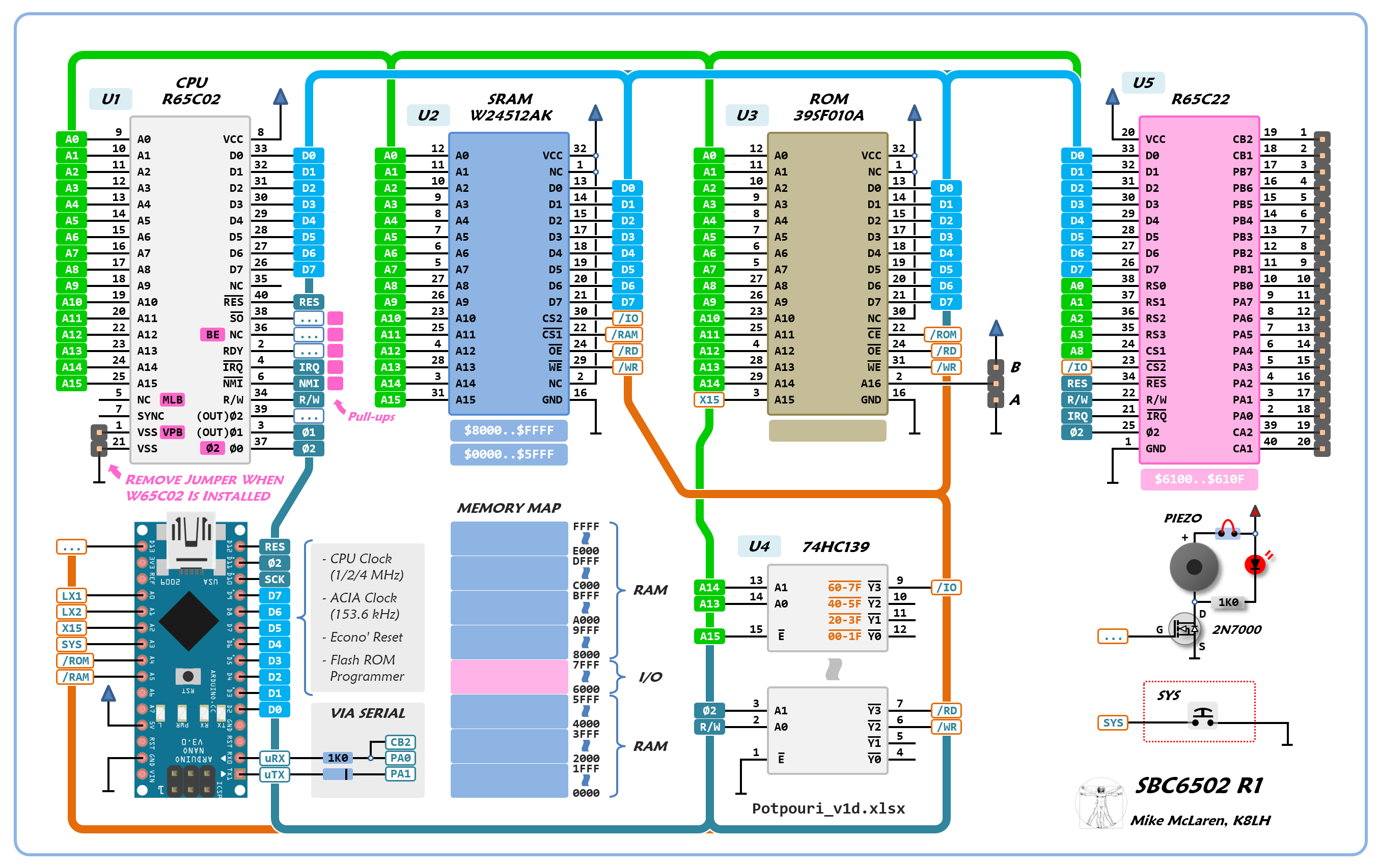

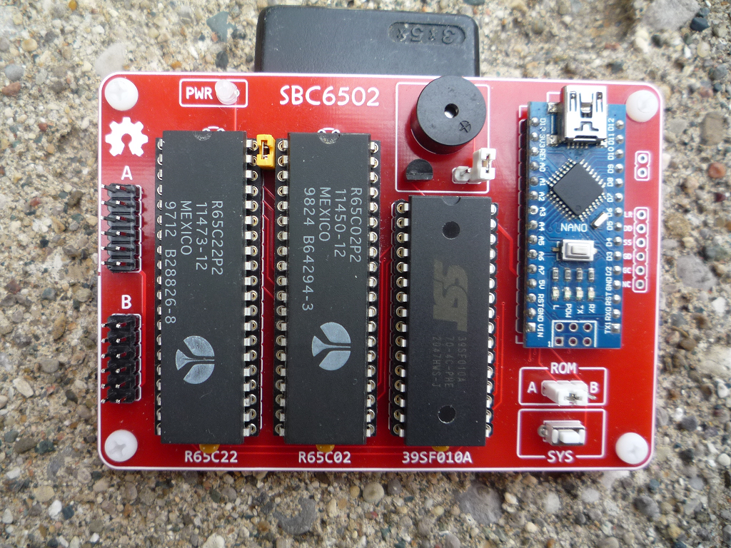

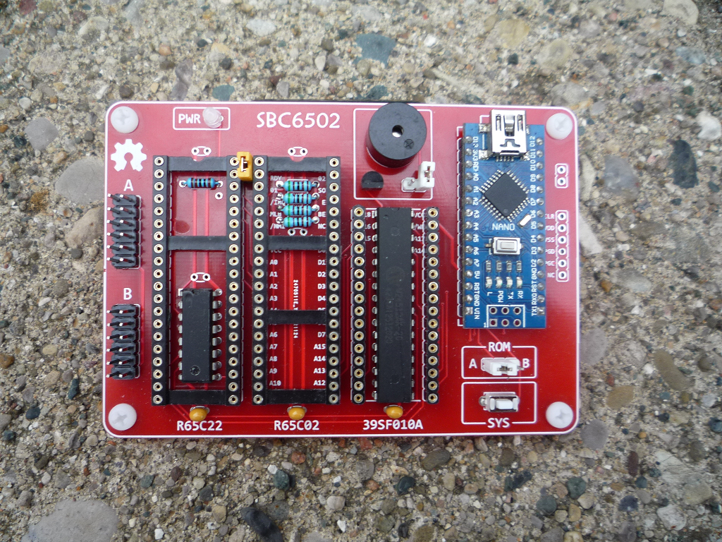

I finally got G-Pascal running on a simple 64K SBC prototype. It just would not receive characters from the Terminal (using Rockwell or WDC VIA chips) until I got rid of the 1K resistor. Could eliminating this resistor be a potential problem?
The SBC features 64K RAM minus the 8K I/O area ($6000..$7FFF). The 64K 'A' or 'B' half of the 128K Flash ROM is copied into RAM at power-up or reset at a nice leisurely 1-MHz rate and a "long press" of the <SYS> push button will program the 64K 'A' or 'B' ROM with a copy of RAM (takes about 7 seconds). An Arduino Nano clone functions as ROM Emulator to load operating systems, programs, and files into RAM for iterative code testing and to program 128K 39SF010A Flash ROMs without a ROM Programmer. The Nano is also tasked to provide a 1, 2, 4, or 8-MHz CPU clock.
Thank you for an awesome package, Nick. It's an incredible and impressive work product.
Cheerful regards, Mike
<added 25-Jan-22>

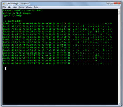

I'm geeked. The SBC seems to be working with an 8-MHz clock after replacing the Rockwell parts with WDC parts (W65C02 & W65C22) and setting the serial baud rate to 38400.

Very nice compact setup using the "skinny" ram and hiding them under the larger chips. The G-Pascal system is very nicely done with all that it offers for development and interfacing through the 6522.
