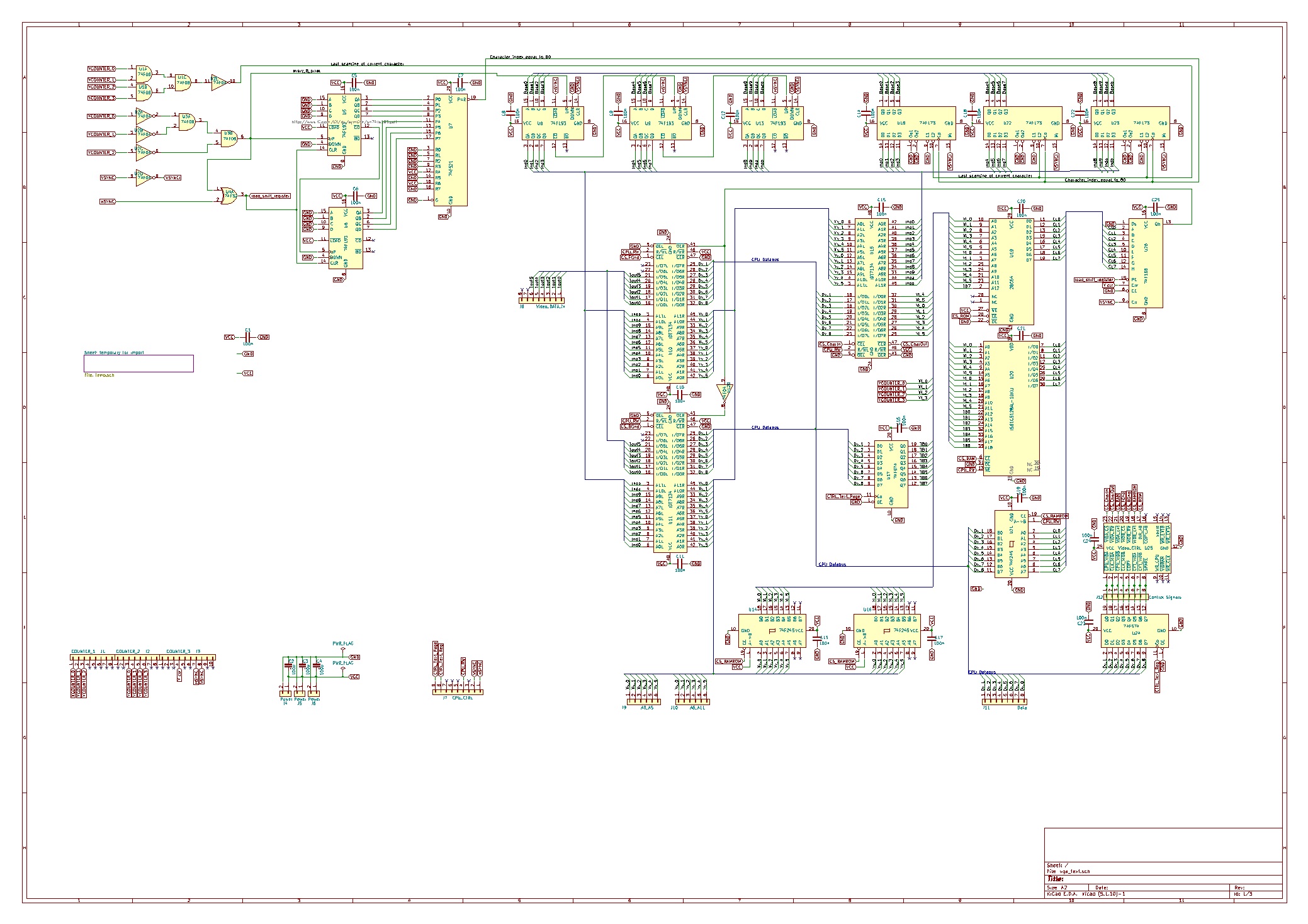

Here is the first iteration. It uses 3 dual pot rams now - one for the character value, one for foreground and one for background. So in the end you should be able to define foreground and background color of each character. It also sprouts basic ROM and 512 MB character RAM (simply because I have those chips lying around)

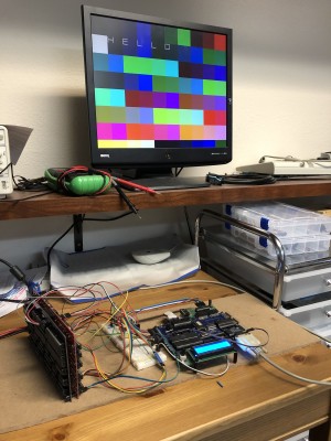

Again - it was a very long time since the last post - but the project is still alive. Actually it's better than alive, it's working. This is a test image of pure TEXT output.
Here's how it looks like on a breadboard:
I attached the schematics as well.
Now why did it take so long?
  • it was complicated - far more complex than I imagined
  • if you have only 30-60min each day at night when you are tired progress is slow
  • you don't have any time to yourself during Christmas vacation :P
  • you are bound to make many mistakes, and motivation to debug sometimes is low
  • especially when something works, than does not work next day
  • only after I discovered load from a logic analyzer might positively impact your design things became more stable
  • pull-up resistors are better stabilizers than load from a measurement device
happy hacking

vga_text_v02_bw.pdf
schematic in BW
(587.07 KiB) Downloaded 43 times
vga_text_v02_color.pdf
schematic in color
(599.32 KiB) Downloaded 40 times
