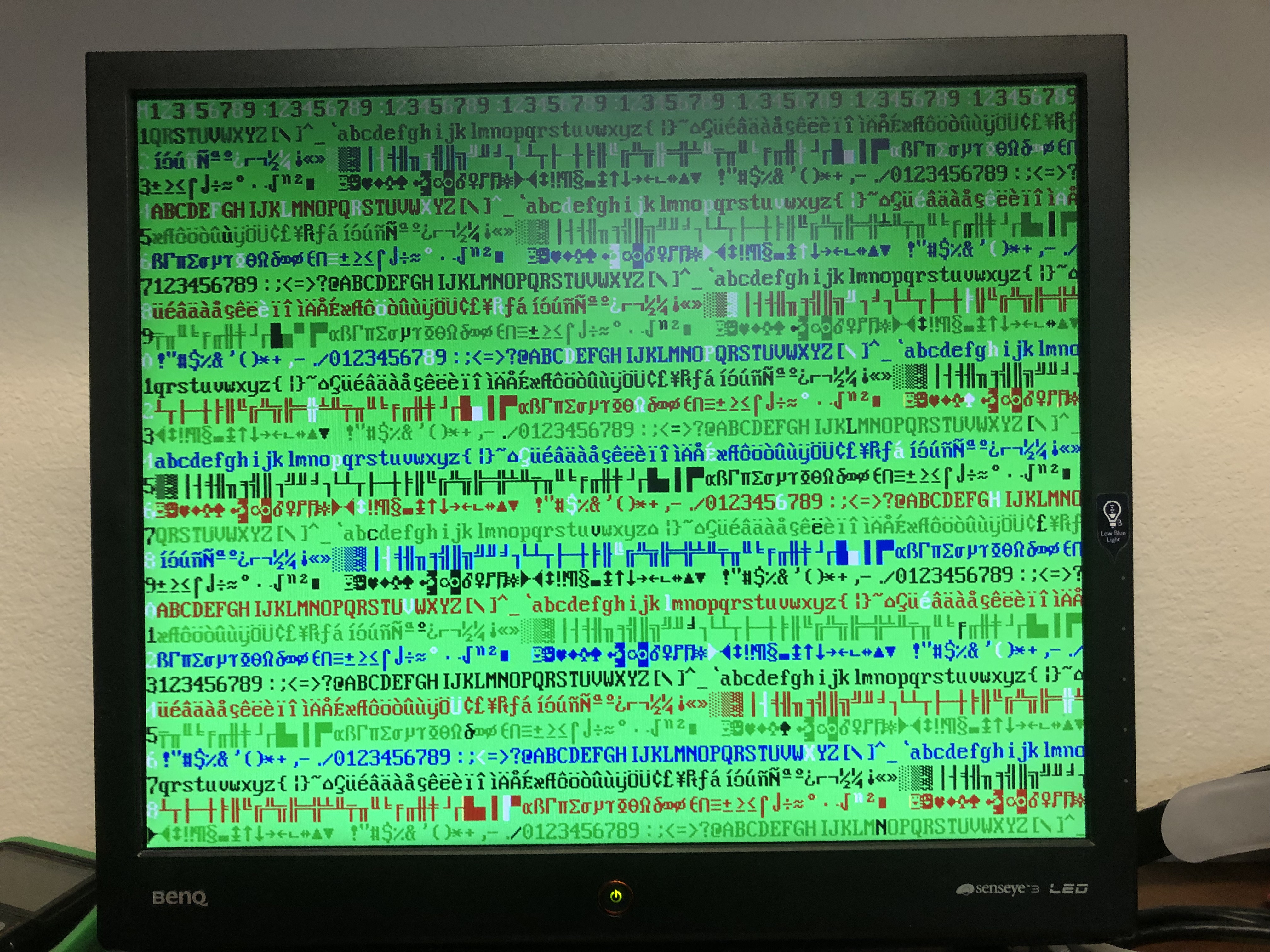

Again - it was a very long time since the last post - but the project is still alive. Actually it's better than alive, it's working. This is a test image of pure TEXT output.

Now why did it take so long?
    it was complicated - far more complex than I imagined
    if you have only 30-60min each day at night when you are tired progress is slow
    you don't have any time to yourself during Christmas vacation :P
    you are bound to make many mistakes, and motivation to debug sometimes is low
    especially when something works, than does not work next day
    only after I discovered load from a logic analyzer might positively impact your design things became more stable
    pull-up resistors are better stabilizers than load from a measurement device
happy hacking

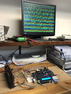

The PCB I created (and ordered from China) worked mostly. Here are both cards combined showing text output
and here doing graphics
There are 2 problems still. Column 0 of the text output is not 100% correct, some timings seem to be off. Far worse is an issue caused by the 4 Y address lines connecting the 2 boards. If they are directly connected via short pin headers the output goes black. If I connect them via 40cm wires as shown in the pictures it's working. Either reflections, or timings, or cross-talk is causing an issue here.
Still as "proof of concept" this worked out. But I probably would not repeat this exercise and instead use one or more CPLDs or even a FPGA for my next iteration. There are simply too many chips in this "bug cemetery" :)
