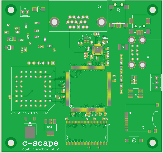

Arlet wrote:
  • I don't mind using a switching power supply, so feel free to suggest something. On the v1 sandbox board, the currents were pretty low though. The LDOs barely get warm. Keep in mind we'll need 3.3V and 1.2V for the FPGA and 1.8V for the ADV7391.
OK, I'll research this and see what I can come up with.
Arlet wrote:
  • External IRQ sounds reasonable. I propose to add a small expansion/IO connector with I2C, SPI, supply, and any free I/O pins, and add the IRQ to that.
I like this approach!
Arlet wrote:
  • There's already a reset button for the FPGA, but we can have a separate one for the CPU, or attach a button to the FPGA for any user defined function. Another idea is to add a few shift registers, and add a bunch of leds and push buttons/toggle switches on the SPI bus.
Either approach sounds good to me. So SW1 resets the FPGA I take it?
Arlet wrote:
  • For the USB, I was planning a dual type "A" stacked connector, attached to FPGA. I don't have any HDL model or code written yet. So, yes, the hardware is ready to support USB host mode, but there's still a lot of work to do before it can actually do that. Support for USB hubs will be very low on my personal to-do list :)
I get it. It would be low on my list too, except that I'd like to have support for a USB or PS/2 keyboard. What are your thoughts on supporting keyboards?

Oh, one more suggestion. Consider putting vias or test points on the unconnected pins of the 65C02/65C816 to make it easier to connect to them should a use be discovered for them in the future.

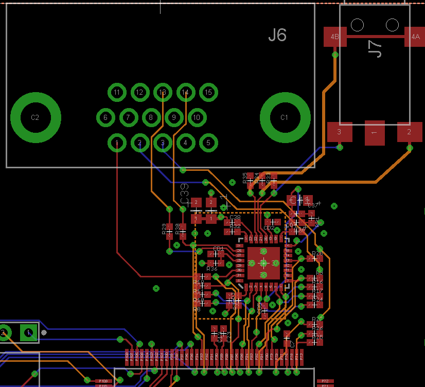

Got video routed (except for 1.8V LDO and I2C, but those are easy). Lots of tight spots :) I decided to implement VGA using 4 resistors (499R, 1K, 2K, and 4.02K). That's good enough for our purposes, and these resistor values are still fairly common.
J6 is the VGA connector, and J7 is the PAL/NTSC connector, implemented using 3.5 mm three-ring jack.
My plans for the connector layout - on the back: VGA, TV, Audio and mini USB power in. On the right: USB, uSD card, UART and extension header. I'll probably shift the VGA connector to the left, and make the board slightly longer on the right. Probably 9x8 cm, or maybe even 10x8 cm.
