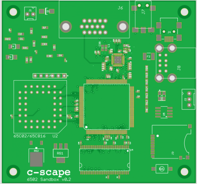

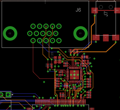

Got video routed (except for 1.8V LDO and I2C, but those are easy). Lots of tight spots :) I decided to implement VGA using 4 resistors (499R, 1K, 2K, and 4.02K). That's good enough for our purposes, and these resistor values are still fairly common.
J6 is the VGA connector, and J7 is the PAL/NTSC connector, implemented using 3.5 mm three-ring jack.
My plans for the connector layout - on the back: VGA, TV, Audio and mini USB power in. On the right: USB, uSD card, UART and extension header. I'll probably shift the VGA connector to the left, and make the board slightly longer on the right. Probably 9x8 cm, or maybe even 10x8 cm.
