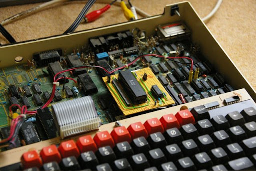

I expect they would be so thick so as to damage at least some sockets the module would get plugged into. Another choice would be a 40-pin DIP header, since those are specifically made to go into DIP sockets without damaging them.

Why not use the pins from a machine pin socket?
A few professionals / collectors prefer this, often putting a DIP socket onto bare posts first thing before installation. It reinforces the jumper pins and of course, the socket can be replaced if its pins bend or snap. Recently someone on the BBC Micro Mailing List complained about connectors snapped off from a potted module (sadly preventable.)
Turned pin DIP sockets seem okay for insertion, the tips aren't that much wider than IC legs. You could go for formed pins to be sure, but some designs use single-ply metal on the legs, which bends very easily and is obviously intended for solder work.

richarde and myself are recapitulating these adventures. We have a just-65816 board which runs OK in an Oric (this is confusing: we think we ought to need to connect BE to PHI2, but doing so stops it working) and we also have a 65816+RAM+CPLD board which allows the 65816 to run much faster than the host. It runs nicely on an Acorn BBC, but doesn't (yet) work on the Oric. There's a thread here. We do have a C64 but haven't tried to do anything with that (yet.)

Not the same thing we were talking about with everything on a 40-pin DIP hybrid, but André Fachat has carried out the idea on a bigger board. See his page about it here . He mentioned it in this post in the topic Programming-->"Code optimization !?"
Two posts under that, BigEd shows another project with a smaller board (which does not appear to be what's shown above), but still not a 40-pin DIP hybrid, and gives a picture:
I recently built a board that would plug into a CPU's 40-pin DIP socket.
I found these round-pin headers from Mil-Max (Figure A):
http://www.mouser.com/catalog/catalogUSD/642/1552.pdf
You can get them at mouser.com - part # 575-643506
It includes a strip with 64 pins but you can snap off the quantity you need.
The cost is a little high at $8.26, but they worked very well for my daughter board.

In Germany I get these pin headers at reichelt
http://www.reichelt.de/?ACTION=3;GROUP= ... f97dfc9bc5
I still place a standard socket underneath it (not the rounded ones, but the ones with the flat pins), that I can easily replace if it breaks
