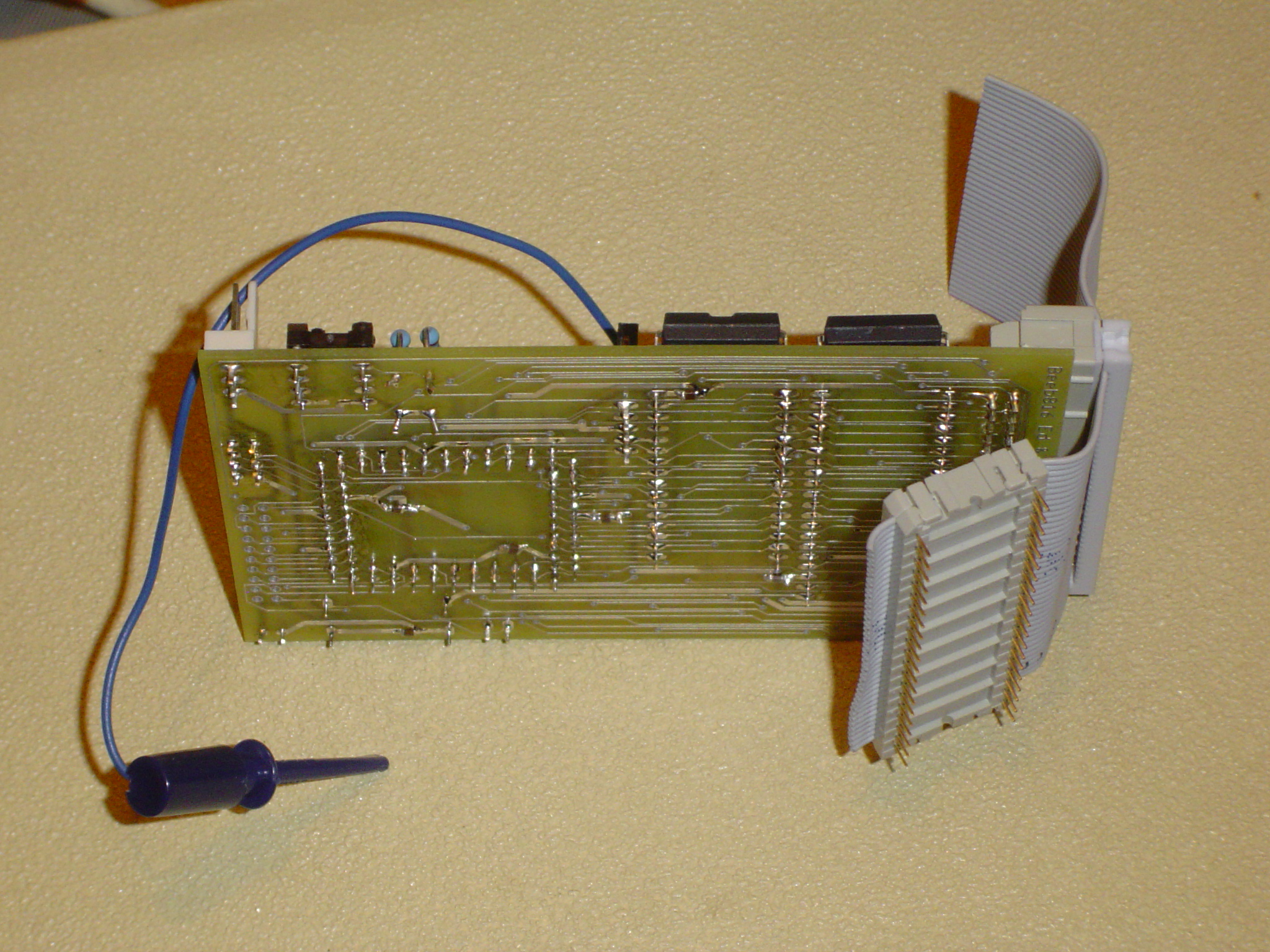

richarde and myself are recapitulating these adventures. We have a just-65816 board which runs OK in an Oric (this is confusing: we think we ought to need to connect BE to PHI2, but doing so stops it working) and we also have a 65816+RAM+CPLD board which allows the 65816 to run much faster than the host. It runs nicely on an Acorn BBC, but doesn't (yet) work on the Oric. There's a thread here. We do have a C64 but haven't tried to do anything with that (yet.)

Our approach was to use a 40-way edge connector, ribbon cable and 40-pin header - it works well, and gives flexibility as to mounting a board left side, right side, vertically or upside down.
(I can't quite bring myself to cut off the extra cable, in case I want it longer some day! At 50pF/m I think I can get away with it.)
